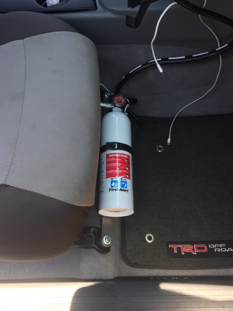

    I have a 2½ lb, 2B-C Amerex Halotron mounted to the passenger-side footwell using a Bracketeer universal mount. It works, but it's awkward looking and interferes with the seat adjuster.

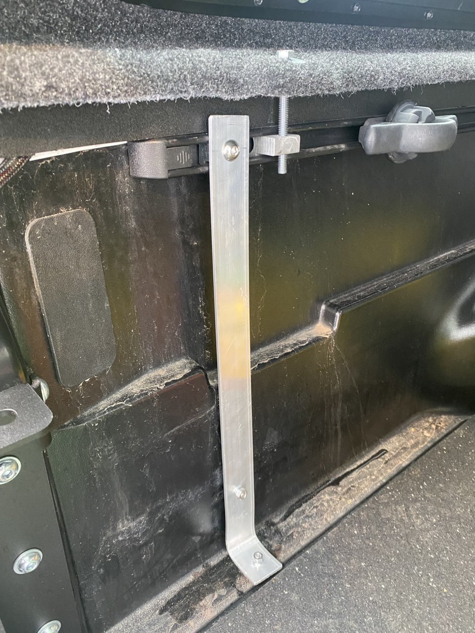

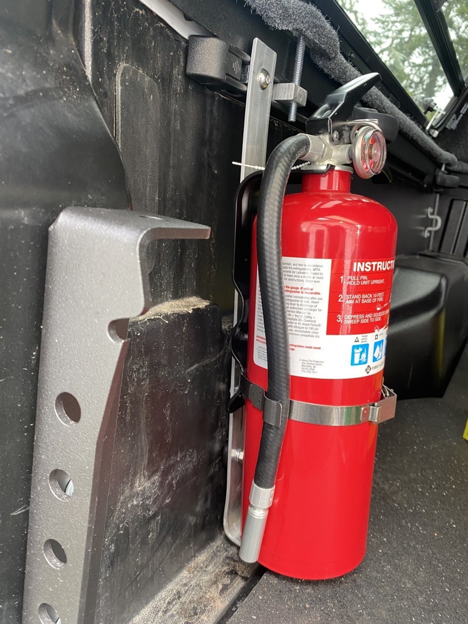

    I made my own bracket using some flat stock and the bracket that came with it. This is one of the Costco packs and it honestly doesn’t take much too much room. I added rubber feet on the bottom and back side of the bracket to help mitigate some noise.

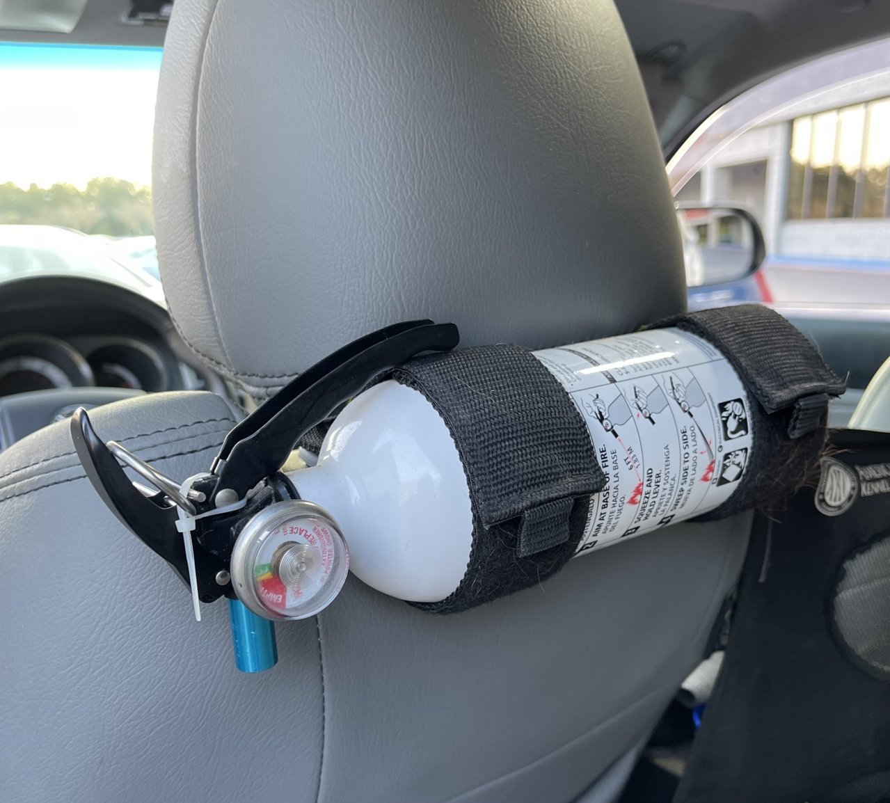

    Put the head rest post through the hole in the strap and tighten around the fire extinguisher and done

    Interesting solution. Would you mind giving the O.D. of your extinguisher and the model #s or lengths of the various Wrap-It straps / grommets used?

    The Fire Extinguisher came off the shelf from Wal*Mart and so did the straps they came from the electrical section where the extension cords are. All the straps have the same grommets. I just kinda eye balled the whole thing :notsure:

    I would put a Velcro strap, Quickfist or something around that bottle, those plastic clips aren't very secure to start with and in the event of an accident you don't want that thing bouncing around the cab.
    <---Worked lots of wrecks over the years as well as high threat environment and offshore as a safety medic so I'm a bit paranoid about making sure stuff is well secured in vehicles. Just my opinion.

    It’s been replaced with a metal quick release.
