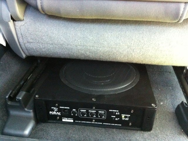

    theres lot of threads on this, your limited on space under the passenger seat but there's plenty.
    there is a bar that dips down under the passenger seat, if you remove it, or rotate it 180 degrees it will gain you enough space to fit a lot of stuff in there.
    i slid a focal ibus 20 under my passenger seat with room to spare, except in height but it fits and allows free movement and no interference with any hardware.
    while its no 10" or greater sub, it exceeded my expectations and fills in the lows very well. not dealing with a sub hogging up cab space or in the way, is worth it to me. esp when hauling around the dog. with your DC you have even more space to keep free...
