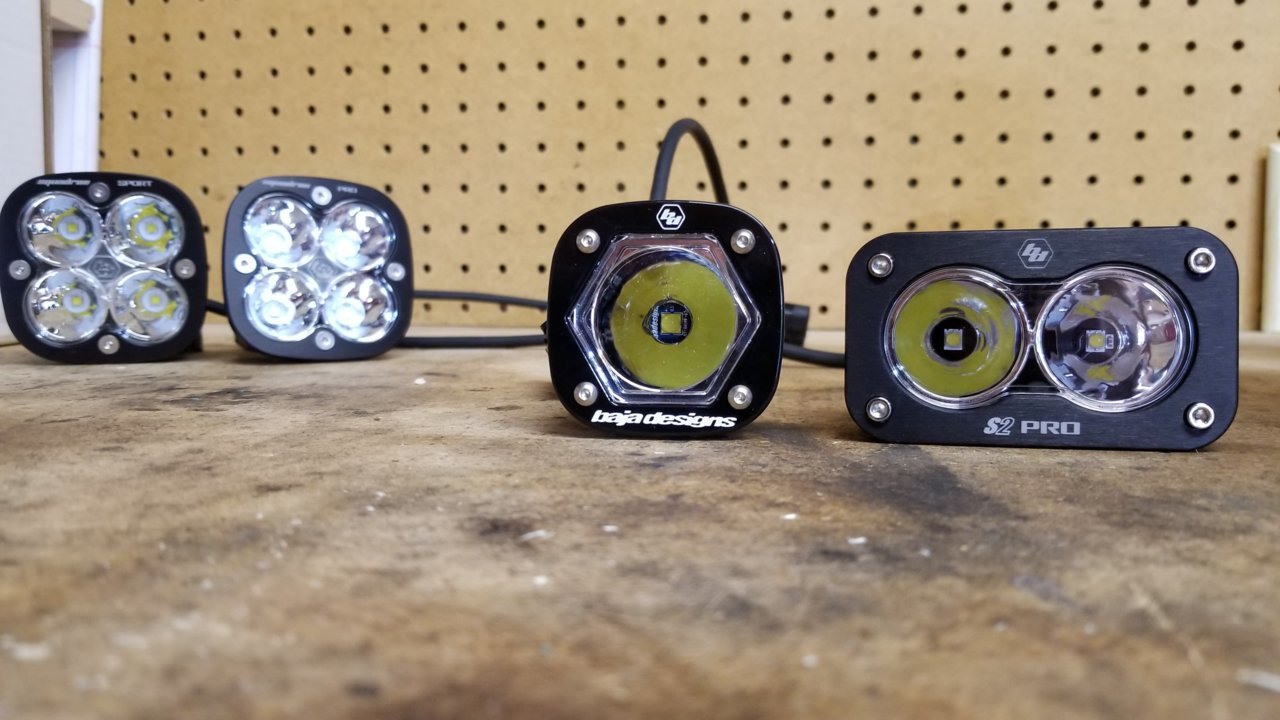

    Next up on the docket... Is the S2 Pro worth the upgrade over the new S1?
    @SearArtist I know you're not really shopping but, you're welcome :D

    Please lock your camera setting for shutter/frame rate, Aperture, ISO, and white balance at 5600 degrees/daylight. This will ensure the camera does not bias your video in any way. Otherwise what we see may not be what occurred.
    Such as the S2 Pro should have been much brighter than what your video showed, in part due to the wider dispersion of light.
    Setting the white balance at 5600k or daylight, ensures color difference from daylight are accurately recorded.
    I really like to see the light pattern, intensity as will as the color temperature on an apples to apples comparison.
    Really nice comparison video and looking forward to see more.

    I didn't post them here, but I took some pics and locked all of the settings. When I took video it didn't seem to come out right, but I will mess with it more! Appreciate the comments.
    I will say though... I haven't tested the S2 Pro yet. It is coming!
