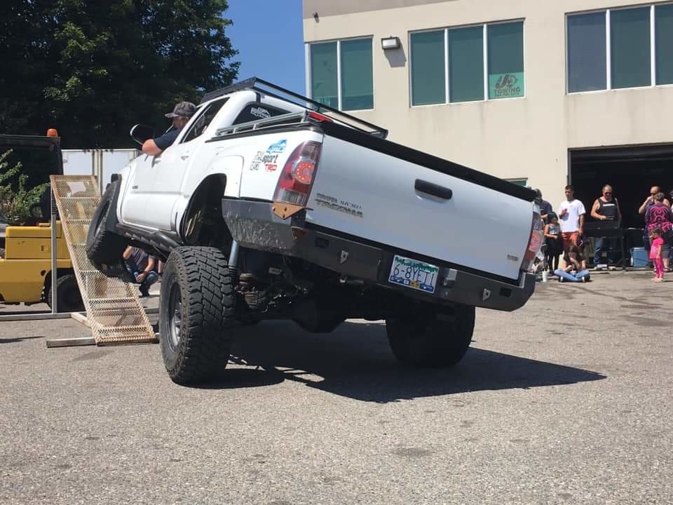

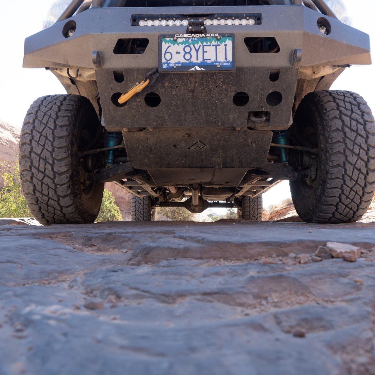

    I am working on putting the 1urfe and 6 speed auto up to my tacoma tcase. I have enough saved to buy the atlas4 speed incase it doesn't fit nicely.
    I am also working on adding the center console shifter to match, and would love to see a display upgrade for the shift lights (would be ok with just the basic number display honestly)
    If you haven't seen what i am installing it into, here are a couple pictures of my truck. biggest issue I have had is getting the time to do it. Not a small job and going places like the NWOR was much funner.
