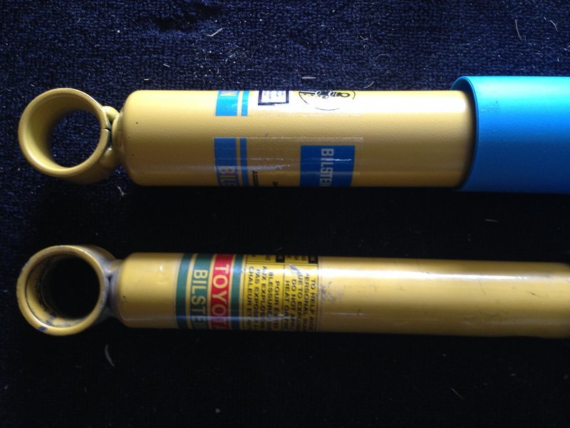

    Wanted to show everyone the difference between the TRD Bilsteins that come from the factory on a 98-04 Tacoma and the replacement 4600 you buy from bilstein. Pretty big difference.

    Which is which in the pic?

    The one with Toyota on it is more than likely the Toyota one. ...

    Interesting. I'm about to put a set of 4600's in mine. Thanks for the insight!
    Question though...are we thinking there's a compression advantage just because the 4600 is a thicker shock?

    there is but not really. there is an oil volume and heat dissipation increase which decrease shock fade. if they are valved the same you probably wouldnt be able to tell them apart on a daily driver.

    There is a huge difference, to the good side.

    I think it depends how you use your truck. If you are hammering it weekly the stocks will likely be blown in a few thousand miles. Highway cruise and they may last the life of the truck.

    thought I'd chime in. I just replaced the stock TRD Bilsteins with 4600s, both front and back. I honestly don't notice any difference at all. I've only driven it about 5 miles after finishing the instal tonight; I thought maybe I'd notice a bigger difference at higher speeds or off-road. Now I am suspecting my 15-yr old stocks with 180k miles were as good as new 4600s.
    I was thinking maybe i'll need to replace the coils too for some improvement? the last post makes me doubt that.
    Has any one else had a similar experience after upgrading their stock bilsteins?

    just an update about the 4600 upgrade. finally took the truck off-road this weekend on tough desert terrain. major improvement with the 4600's compared to my old stock shocks. it felt great at higher speeds on dirt roads (~40 mph) and crawling up and down dried river beds in 4L. very solid. replacement cost for all 4 shocks was only about 400 plus 80 for an alignment. wish i had done it years ago.

    You've just noticed exactly what is to be expected. On a daily driver at 100% street, you could probably put $25 AC Delco shocks on and not notice much, if any, difference.
    The main advantage to nicer shocks is off road, when you start pushing them.
