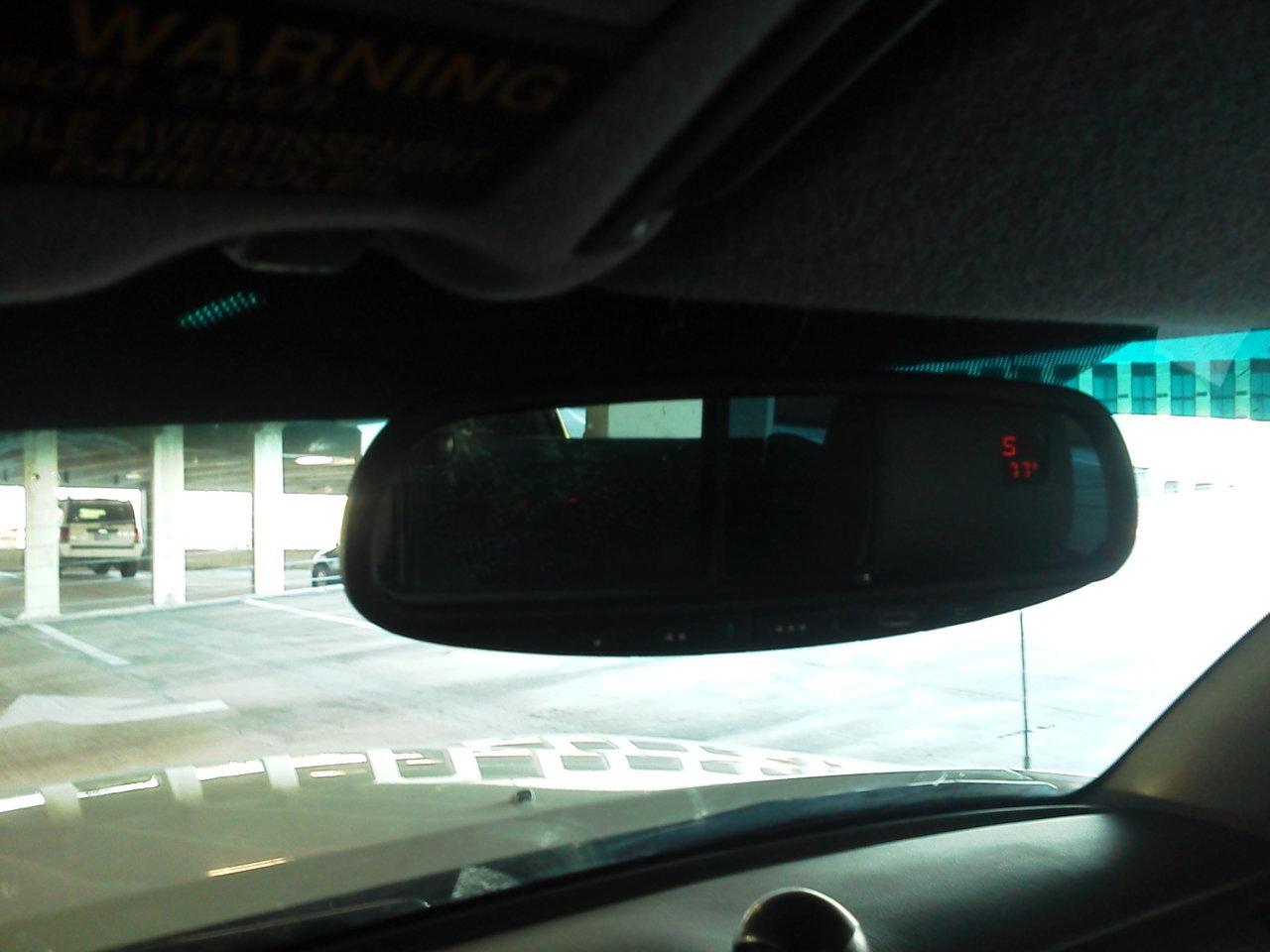

    I installed a GM review mirror with compas and temp. Pretty straightforward. I like it. You can get them cheap at any junkyard.

    The GM mirror only needs power ground and if you want temp, two wires to the sensor.
