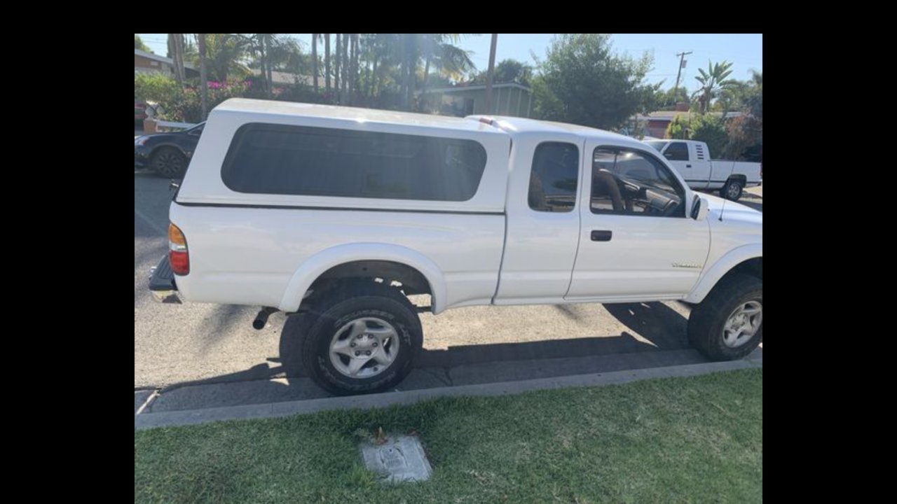

    I don't know about Rangers shell fitting, but you could look up their bed size and see if it's similar.
    Second Gens have a different bed spec and I believe those shells will be wider.
    The first gen Tacoma beds are similar to the third gen Pickups, but the Tacoma's have a taller cab height. The older Pickup shells usually don't have a brake light. I've attached examples of that a Pickup shell will look on a first gen Tacoma.
