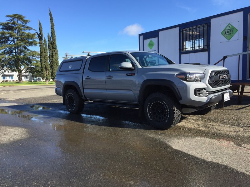

    I added a commercial cap to my truck, I also have about 150-200 lbs of equipment often in the bed. Unfortunately this is causing extra sag on the rear leaf pack. Since I'm a novice when it comes to suspension I'm just trying to get a feeler for what options are out there. I don't want to replace anything, just add to it... any info would be appreciated.
    If there's already 24897325735498 threads about this send me a link please, I haven't been successful with the forum search function here.IMG_2272.jpg

    How about dakars?

    Progressive AAL would work.

    Dakars are a full leaf pack. IMHO AAL are just bandaids to the shitty leaf pack tacomas have

    Helwig makes helper springs that you can bolt on to the stock leafs, i've heard really good things aboot them.
    BTW AAL = Add A Leaf

    we added contractor caps/ ladder racks to our '17 Tacomas and i put on Sumo Springs to help with the load. works well for now. obviously i want to upgrade the suspension but the budget won't allow for now.

    What about Air Lift, then you could adjust to your load?

    What I did on my 2006, after Toyota took too long replacing the rear leafs..... I went to my local spring shop and they fabricated an extra spring and added to the rear to level things out.... I was 200% satisfied with this option and result... cost me under $300.00

    Another vote for Dakar leafs to replace crap stock leafs... You can add or move a leafs from the pack.

    What's you current hub to fender height with the cap?

    its not on level ground so each side is a little different. drivers is 21" on the spot, passenger is 20-13/16". measured from the center of hub to the bottom of fender
