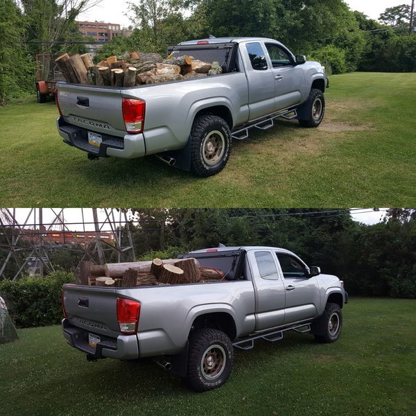

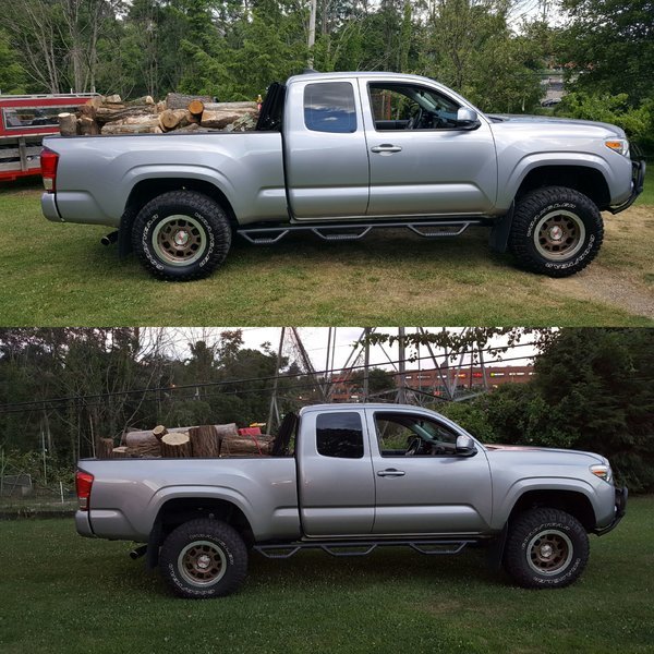

    Dakar Leaf's and Firestone ride rite air bags will handle just about any load in the back of the truck!!!
    The top Picture is with Dakar Leafs without the air bags and the bottom one is with the air bags with about 60lbs of air in them! There gotta be around 1200-1300 lbs. of firewood in the bed!

  7. Jan 23, 2017 at 12:33 PM
    #27
    TacoJova
    TacoJova Well-Known Member
    Feb 11, 2016
    #177914
    1,662
    Central Oregon
    21 Ram TRX Sold 2015 White DCSB Offroad
    Supercharger Hybrid audio stage 3 and stage 2 rear with 2 image Dynamics IDQ10's and alpine amps Bilstein 5100 with OME 887 Dakars and Icon 2.0 in the rear URD SPEC U Headers URD Y Pipe Borla muffler 18" Magnaflow Resonator Morimoto fogs
    Damn that's a lot of weight
    You'll never sag with that setup.
    moe2o4[QUOTED] likes this.

    moe2o4
    moe2o4 Well-Known Member
    Feb 9, 2015
    #148236
    7,855
    Corey
    Pittsburgh PA
    2016 SR Silver 2.7L 5 Speed
    OME 3" Lift, 32" Tires, Lots of Mods!
    Nope haul wood like this all the time and its by far the best setup. Those shitty stock toyota leafs are garbage!!!!! Any my trucks a 4 cylinder 5 speed also!
