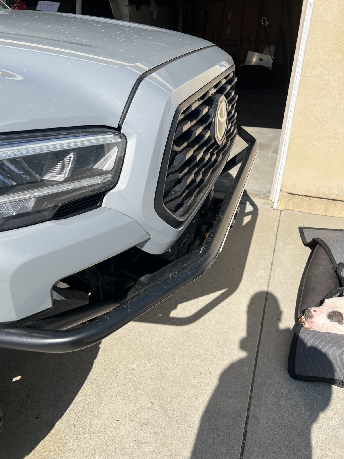

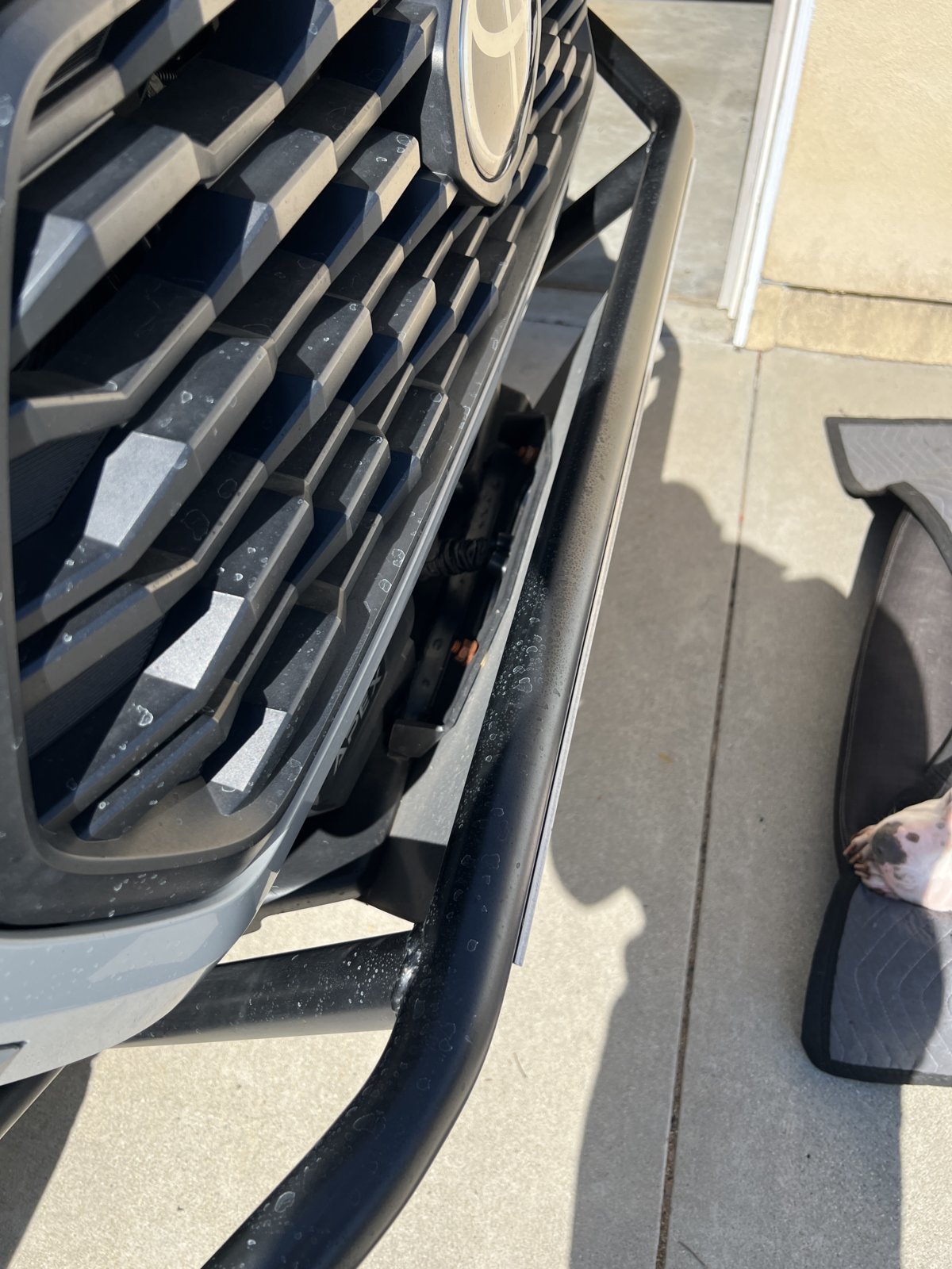

    Do you have any more pics of this thing? It looks great from the front. I like the areas left open below the headlights.

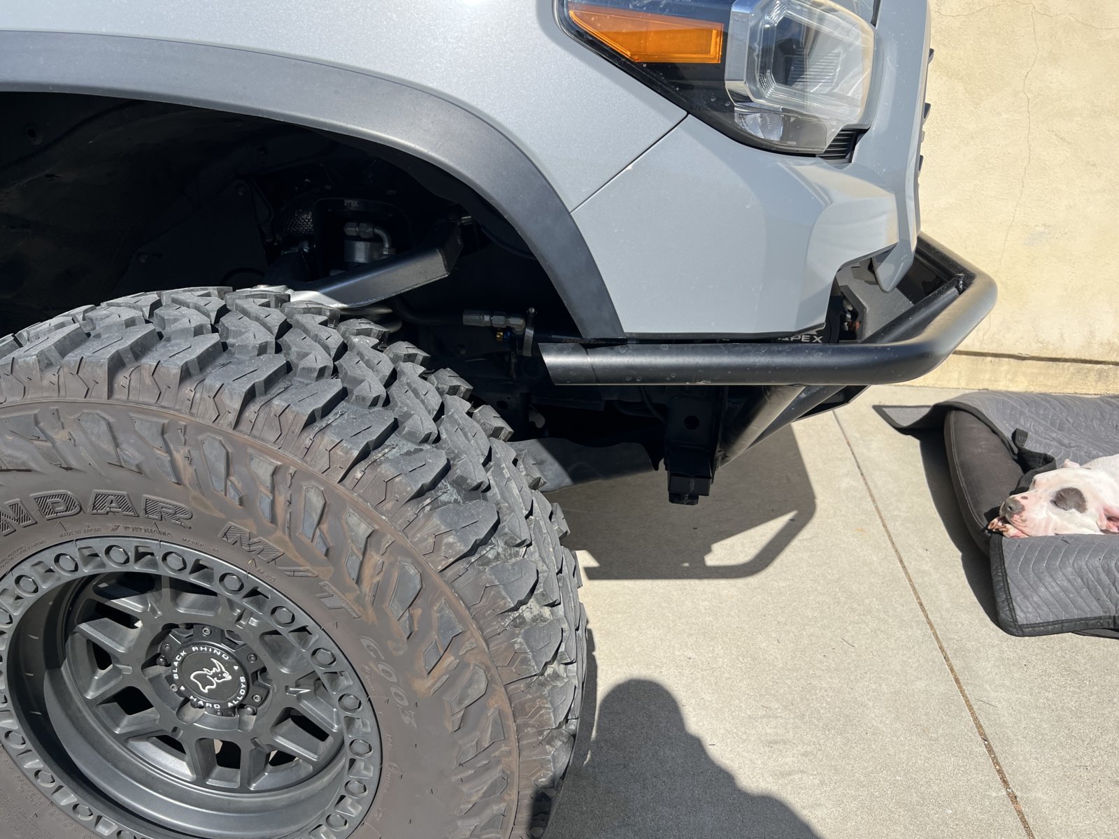

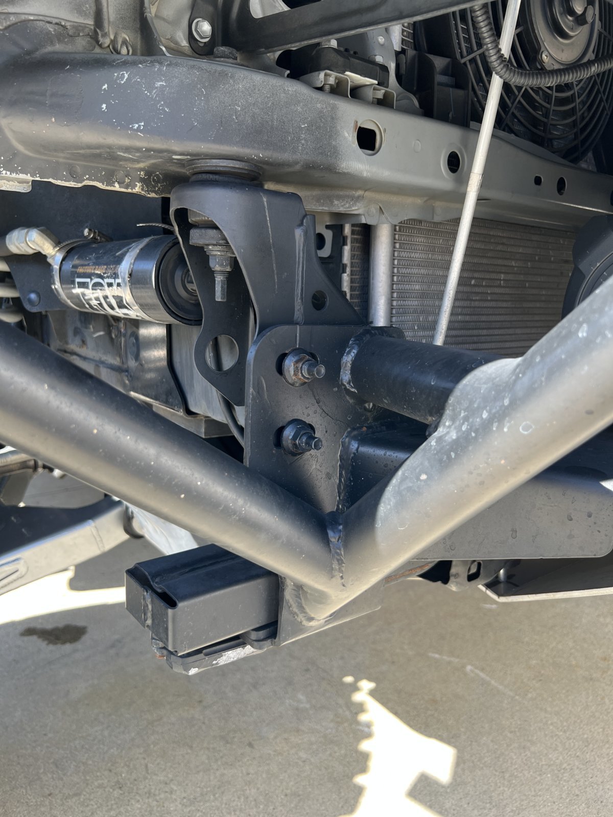

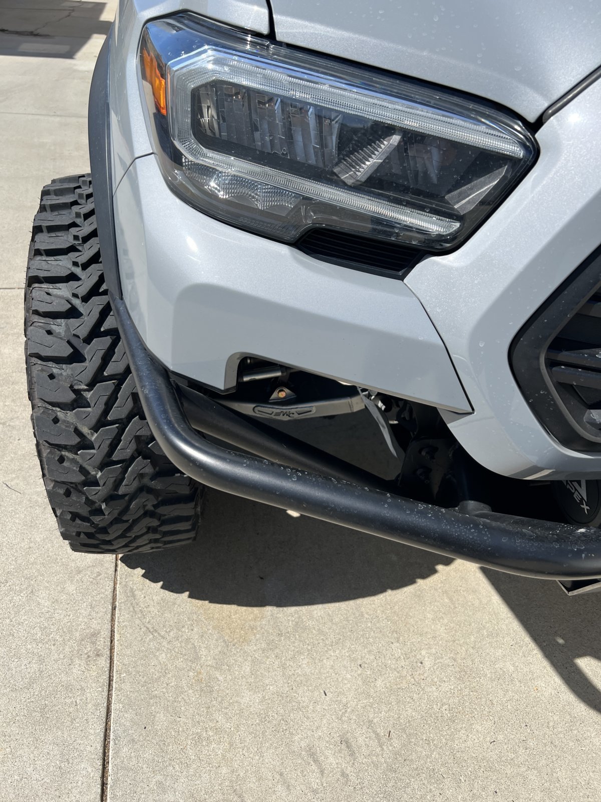

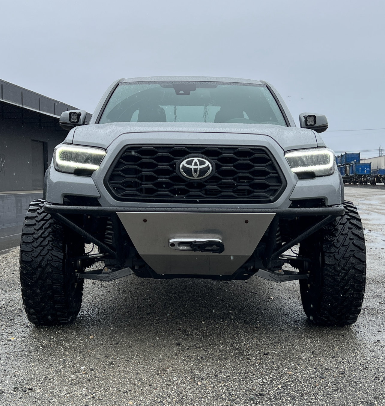

    Of course. I just trimmed the fenders more for my long travel kit so I’ll be cutting back the tube and caping it to align with the fenders in the next day or two in the first pic. It’s built out of 120 wall dom 1.75” tube bent on a rogue tubing bender and .25” plate.It’s bolted on and can be removed, I used the grinder to make indexing marks at the bolts holes to make it easier to get back to the same spot. Main goal with the aluminum plate was to follow the outer grill body angles. I didn’t want the aluminum plate flat (just not my personal favorite) so it has two bends and over laps the stock guard and uses the same bolt hole location. The stock guard can still be removed without completely removing the aluminum plate. I bought some leds to put in the gap under the head lights but fitment didn’t really sparkle with me so gonna try some other styles.

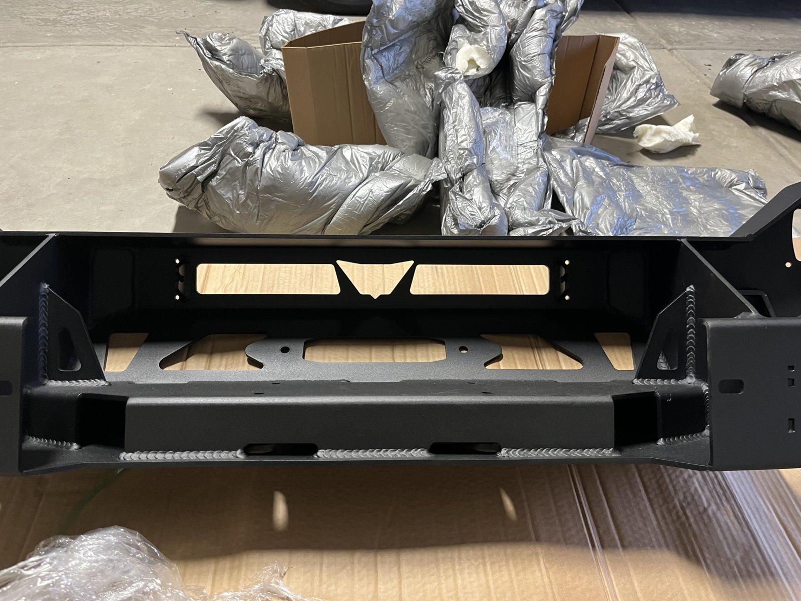

    I am loving my Victory 4x4 front bumper, 48 pounds in the aluminum version, excellent craftsmanship, and most of all I love the way it looks.

    Fresh off the truck photo.
