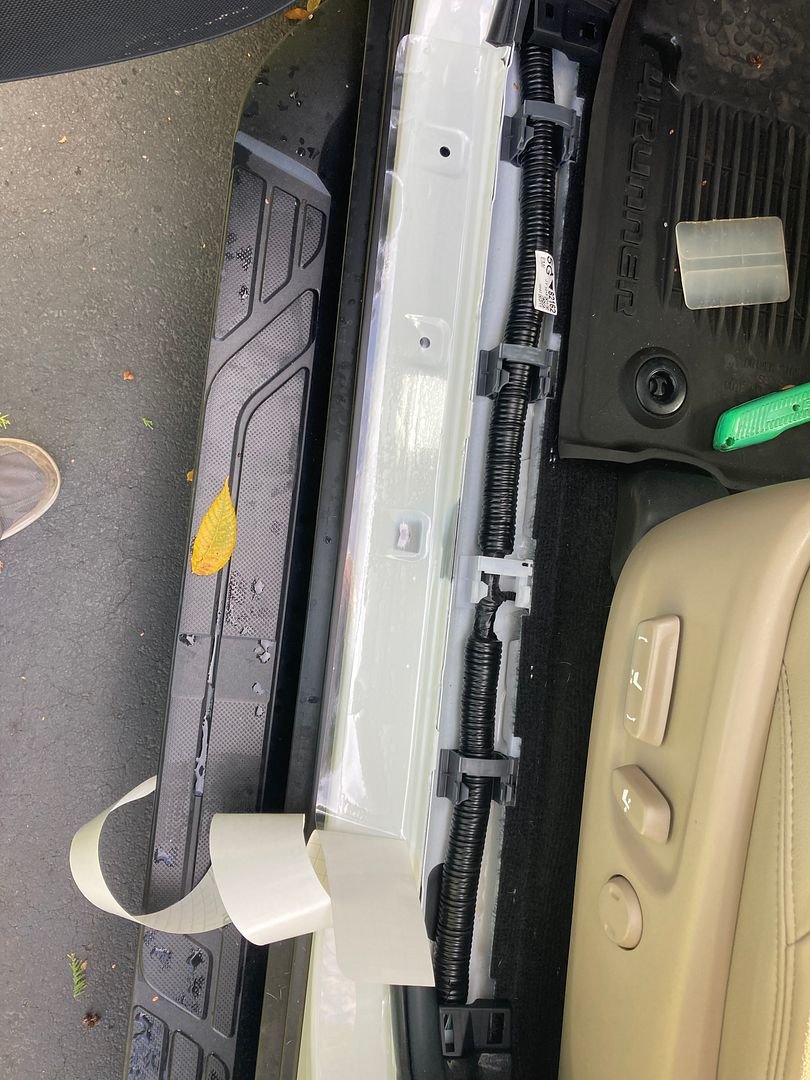

    Next, I removed the plastic trim above the rocker panels on all four doors. This area - especially on the driver's door - is known to rust out because the underside of the plastic trim piece rubs through the paint right where you can't see it - until it's too late. I cut pieces of Clear Bra with radiused corners and applied them so that they covered an area just slightly greater then the trim piece. This should keep the plastic from cutting through the paint.

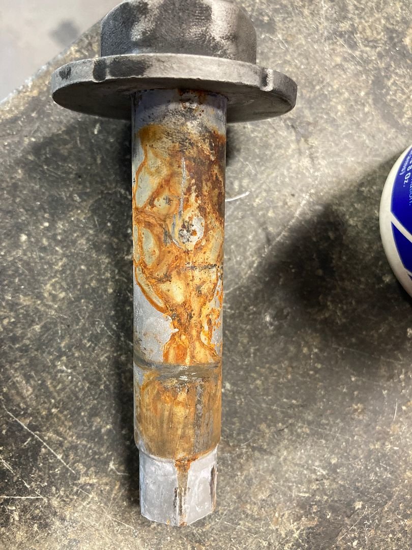

    Finally, maybe the most important thing. My son and I removed all four Alignment Cam Bolts from the Lower Control Arms. These are known to trap salt and moisture that allows them to corrode pretty quickly. When that happens, your ability to use them to align your truck goes pretty much out the window. So, we removed them and liberally coated them with Never Seize. As the pictures below show, even though the truck is only 8 months old, they were already starting to corrode. Even though we carefully marked the positions of the cams, the truck goes in for an alignment tomorrow just to make sure.

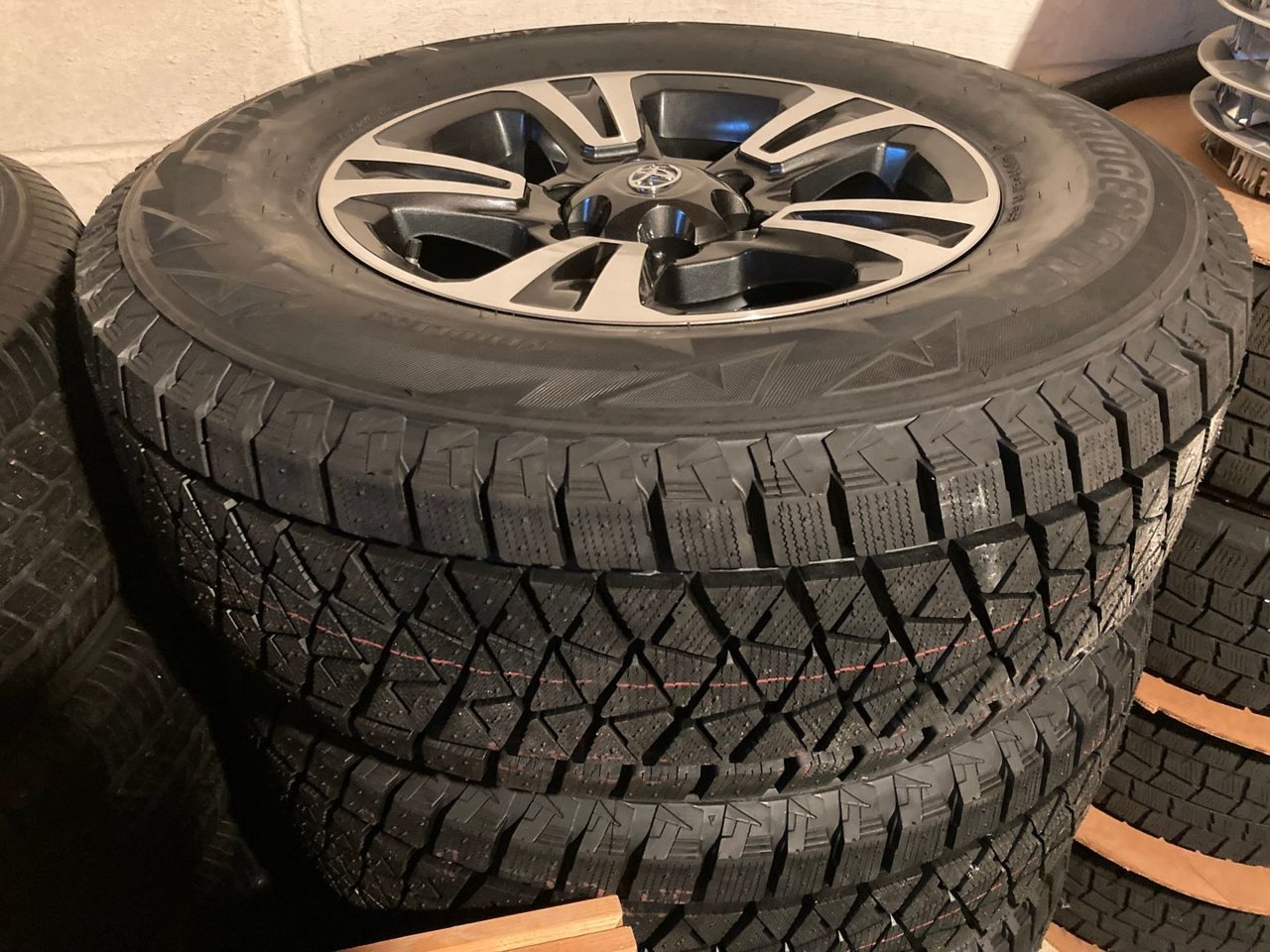

    The only other thing needed to get the truck ready for snow is slapping on the winter wheels and tires. I scored a nice set of 2019 Tacoma TRD Sport 17" wheels with TPMS sensors on Craigslist and mounted a slightly narrower than stock set of Blizzak DM-V2 Ice and Snow tires on them. My experience has shown that narrower tires are always better on hard packed snow and ice. These will go on in early December.
