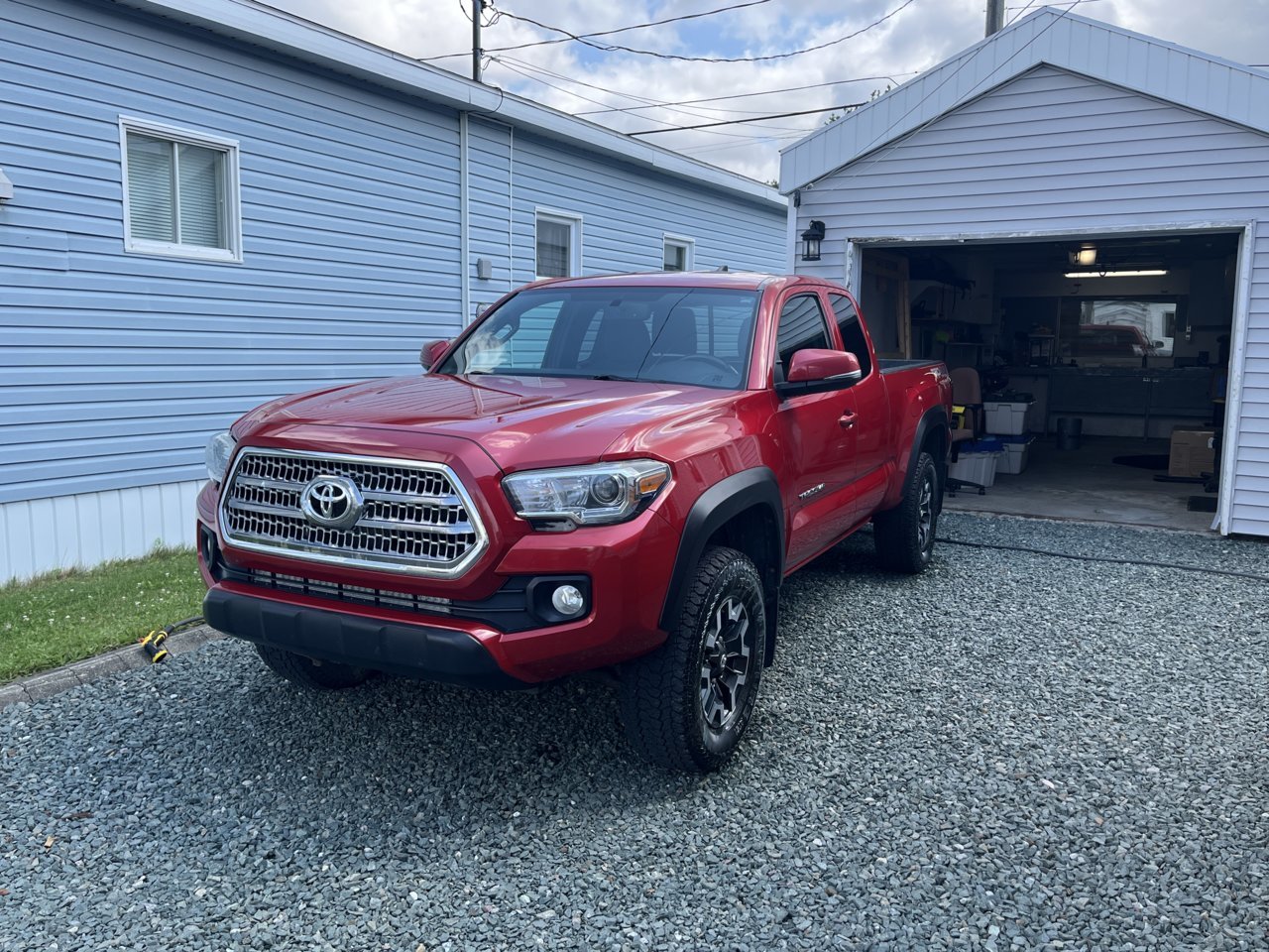

    Hi,
    I’m new here and I wanted to share my story with my 2017 Tacoma.
    I purchased it in april 2021 at 103 000KM (64 000 miles) So no warranty from manufacturer, at 120 000KM (74 500 miles) in February 2022 I had misfire engine code in cylinder 5 and random misfire code (check engine light is on and stability track light on) So I go to my local garage and change all 6 spark plug and I had to change ignition coil in cylinder 5 because there was oil on it…
    About 3 weeks after I notice a weird noise from my engine it’s not knocking mostly ticking but didn’t sound good at all, I live in northern Quebec last winter we had 3 week with temperature of -40 degree Celsius (minus 100 Fahrenheit) So I was no big deal, it’s my first winter with the truck it’s probably the cold…
    Since then, the noise just got worst and worst, so in May 2022 I go to my Toyota dealer where I bought the truck and ask for transmission oil change, transfer case oil change etc, I ask them to look at the engine noise… Answer was your engine is knocking, will need further investigation but maybe you can do another 60 000 miles without any problem… So, I was ok no big deal I will wait and see…
    So now we are in September 2022 and it’s worst than ever, so I took the truck to the dealer I now have 143 000KM (88 500 miles) on the truck I ask my dealer to put a camera in my cylinder and have a look at the problem… I had a call they said it’s the worst engine they have seen to date…. I need a new short block….
    I mostly drive the truck on pavement road my daily commute to work is 32 miles one way so 64 miles a day, so miles added quickly on the truck…
    Today I received a quote from my dealer to fix the truck… the quote is 10 400$ Canadian so 7580$ USD
    I was shocked…. To me it’s the worst buy I’ve done in my entire life, in my town we are 4 Tacoma owner with the same engine noise… I will get the truck fix but to me it’s my last Toyota for sure…
    I hope my story will help someone one day…
    I will add photo of the repair process and everything really soon...
