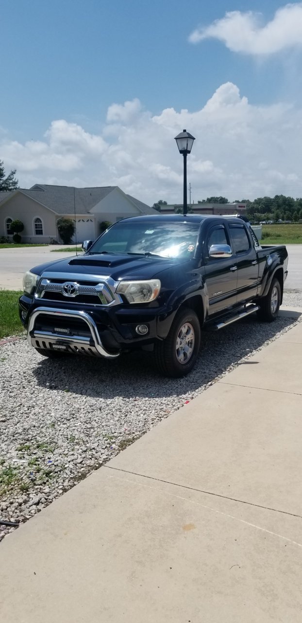

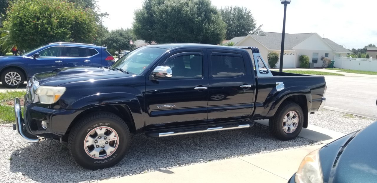

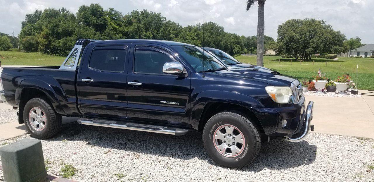

    Strip down as much as you can yourself,Sand it yourself , and take it to MAACO as I did for $1100.20200711_121843.jpg 20200711_121725.jpg 20200711_121746.jpg

    You have a before?
