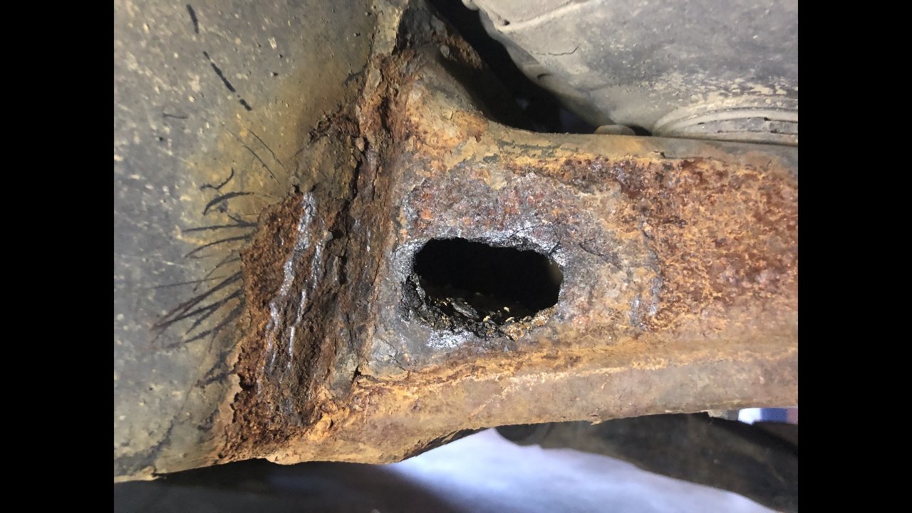

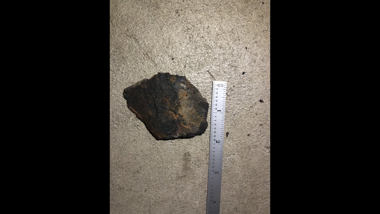

    I purchased my 2010 Tacoma Trd sport new and it currently has 173,000 miles on it. I had it into the service department a few years back for the frame inspection recall at which time they treated the frame and said it was fine. Since then I generally once a year crawl under and scrape any rusty areas and paint them with a rust converter which has kept my frame looking pretty much like new. While doing it this year I found a large bubble on the passenger side cab mount, after hitting it a few times with the putty knife a chunk of it fell out which left a hole through the cab mount. BDC763C8-C06F-4ED4-9633-809D631DF7D5.jpgA63CEBD9-4C58-4396-A9BB-99AFFE04C846.jpg
    After seeing the extent of the rust involving the cab mount I called my local service department to see if it might still be covered by the recall. They set up an appointment for me to bring it in so they could inspect it again and after the inspection they inform me that they would definitely be replacing the entire frame per the recall. What other components should I replace while it is completely disassembled? Service department said there would be no additional charge reinstalling any new parts that I provide so it only makes since to replace as much as possible during this repair. My truck still looks like new inside and out and I have no desire to get rid of it.19773D07-3D1C-4322-9A9F-9784DD2F0500.jpg

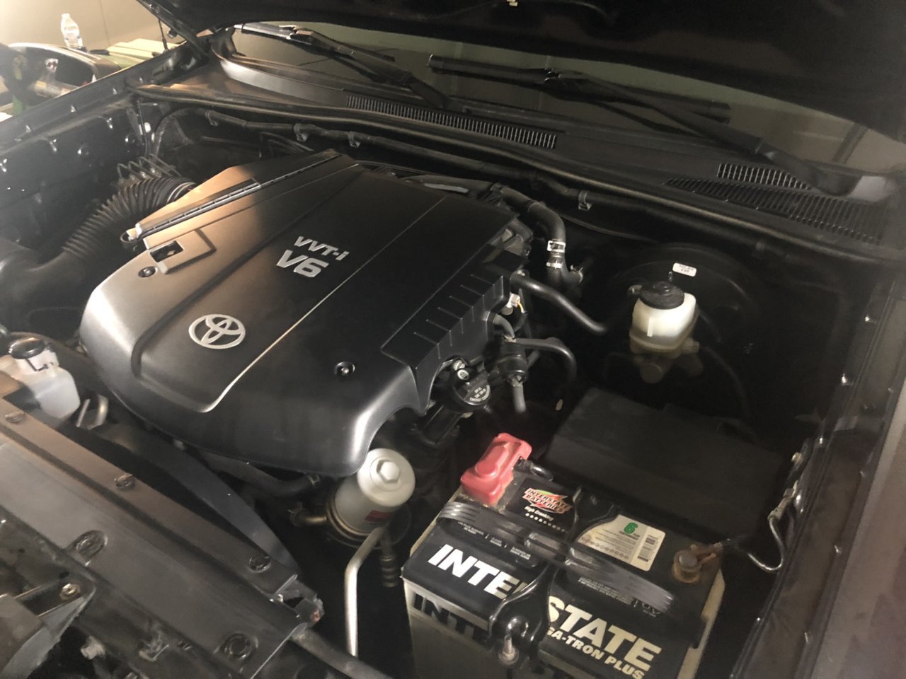

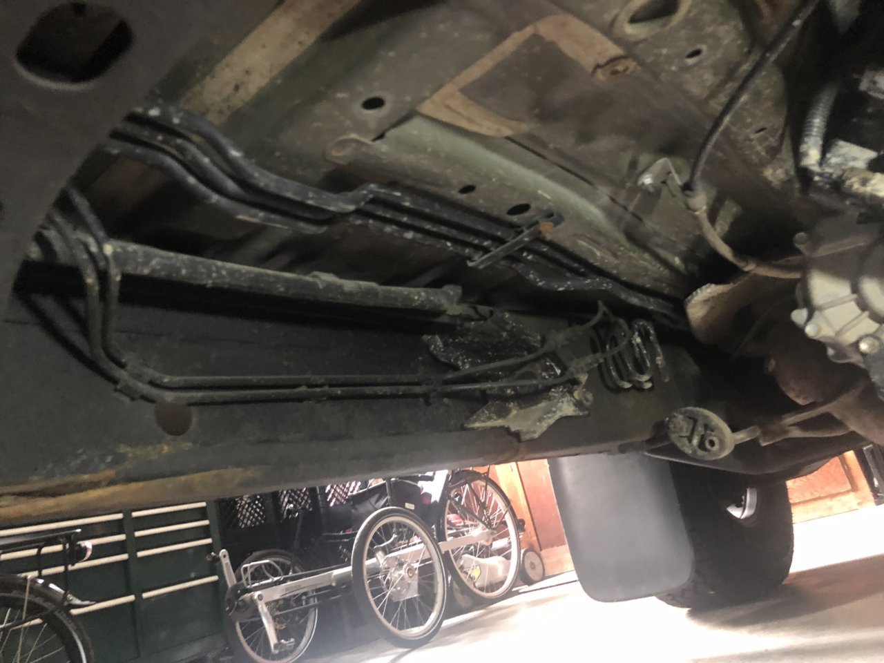

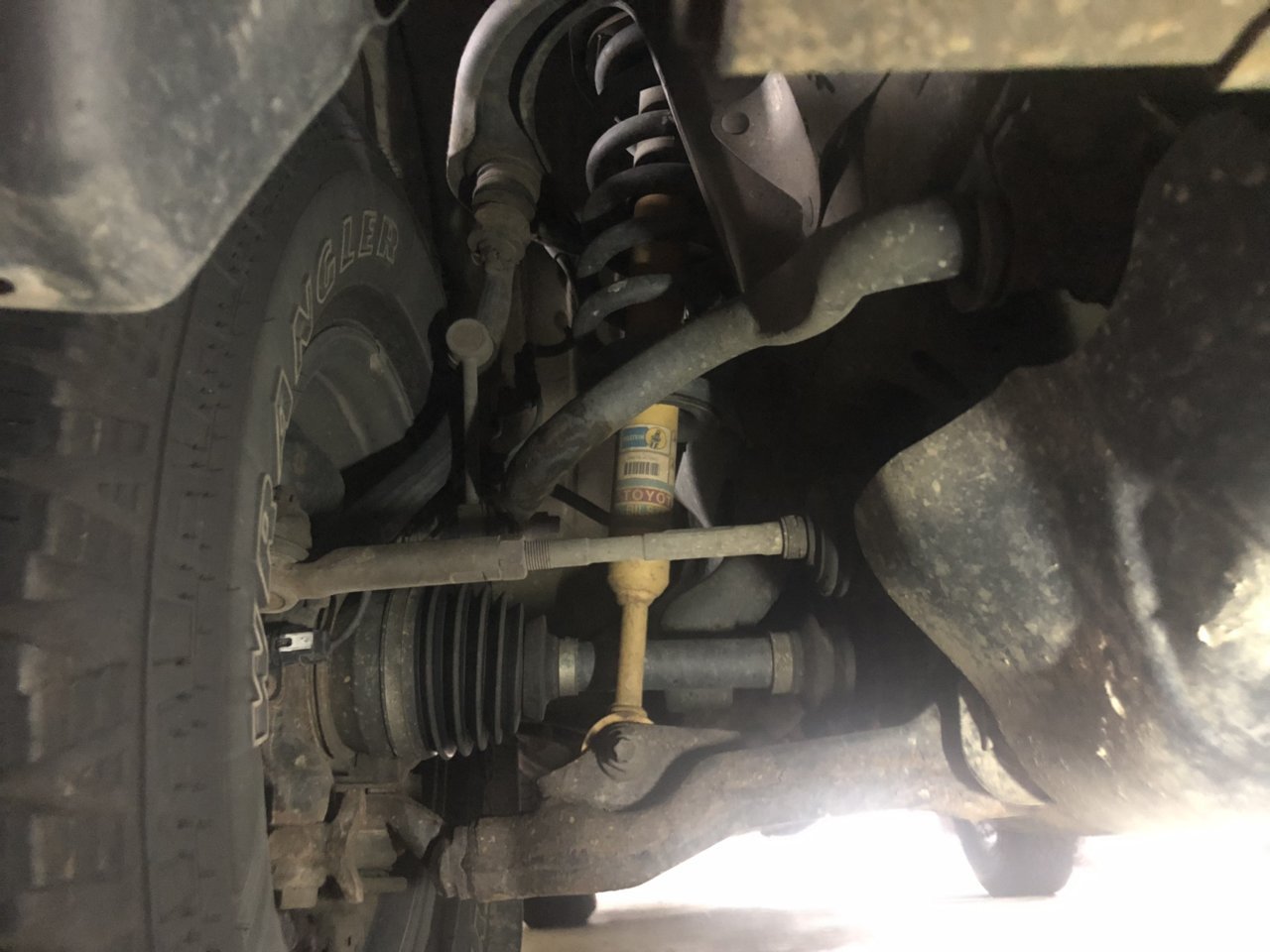

    None

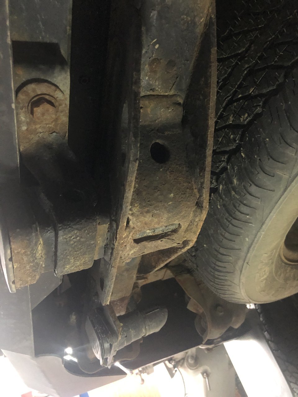

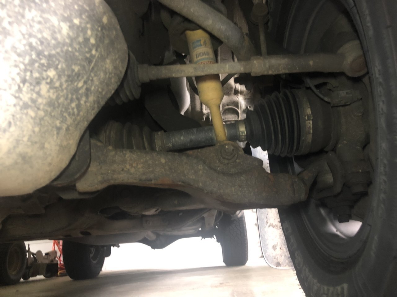

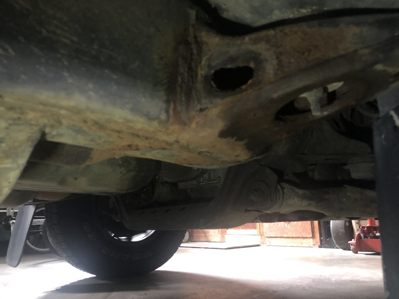

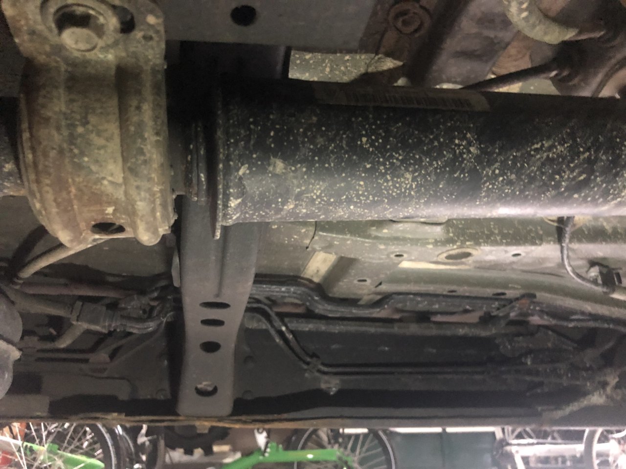

    My truck is really in outstanding condition considering the miles with only very minor frame rust and absolutely no body rust. The worst thing on the truck is the hitch which will be replaced when the frame is changed. Here are a few pics of the condition.96D76952-E1A0-4842-9BF1-B431F4C2D208.jpg8A3DADD4-31A1-4B1E-9C99-0051686BD742.jpg22998E83-0B0D-496D-B89B-1C89041A1EF7.jpg050762D4-EF3F-47A2-B338-47D5C0FA40E9.jpg57128B3E-C553-40C0-8F83-887816E8B462.jpg8A56FAA6-D229-4E40-B120-E4652DEFC292.jpg5175DC51-20F1-4763-AFE1-3A65F4FC09CD.jpgD9829FE7-0C35-42CA-BD49-49E041669CEC.jpg2A096F76-DCBC-46B5-8206-84C2D73DECDA.jpg66E24CFD-485E-4010-AD78-3E2139CB0674.jpg17FAB0BB-7B14-4A3A-9FA7-7B202D5D6F11.jpg

    doesn't look too bad but there's a reason there's a long list of covered replacement parts. Stuff isn't going to survive being removed and reinstalled lol I would suggest making sure to let the dealership know to contact you if they need to replace certain parts that aren't covered and to have your approval for anything surpassing $100-400 or whatever. Not too long ago there was a dude that had a dealership go wild and install a couple grand of parts not covered by the frame warranty campaign without (according to the OP) prior approval. So just be safe and get that in writing, along with keeping notes of any phone calls for any additional approvals.
    Also, this is great time to replace/upgrade anything else you have been wanting to do. A lot of folks have provided new shocks/assembled coilovers to the dealership and had them installed free of charge. After all, the labor is included in the warranty coverage.

    Definitely looks like a NE truck underneath..but those pics it looks sweet, you'll get at least 10 more years after this job is done.
