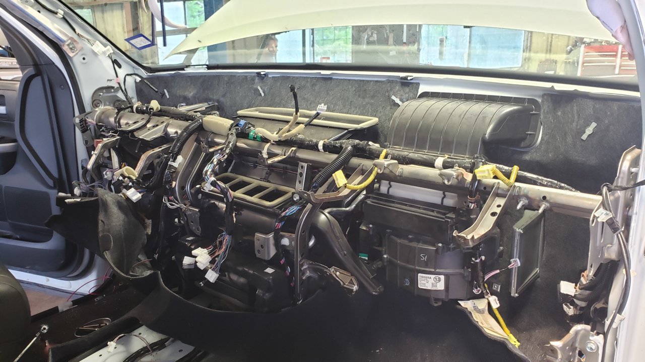

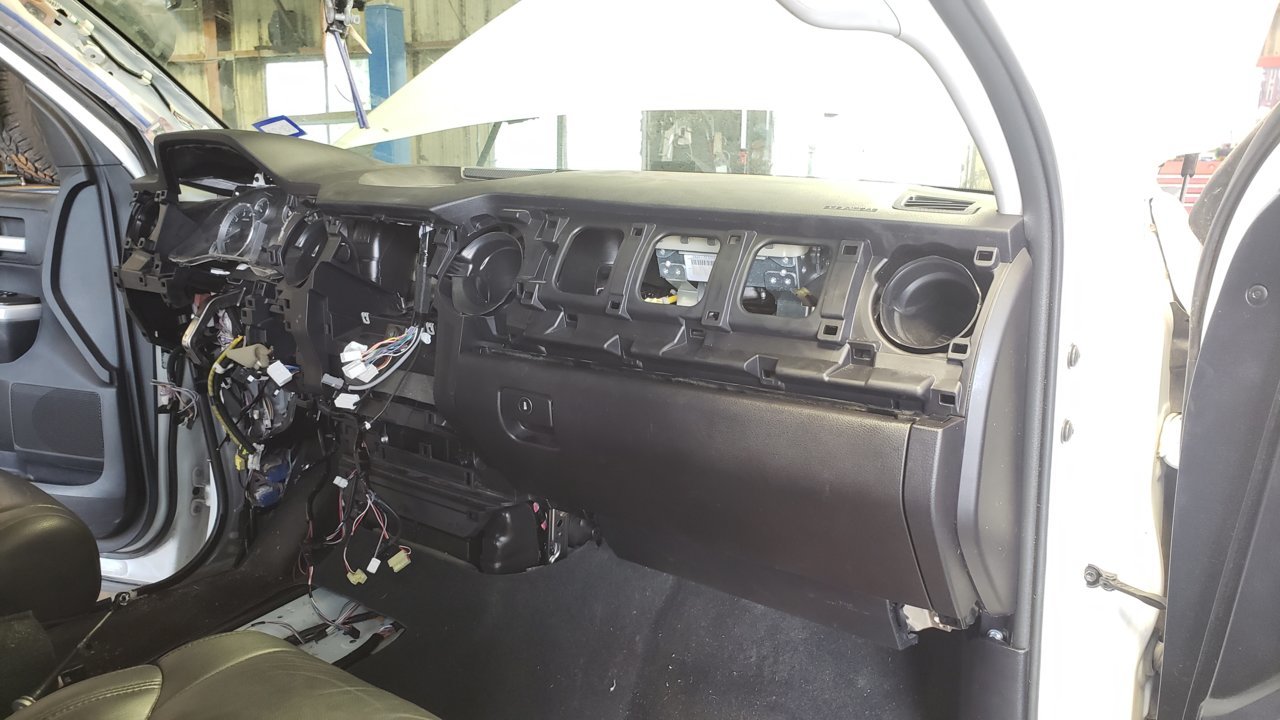

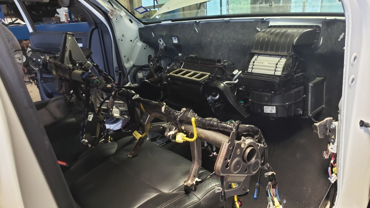

    I'v done many dash pulls on Ford, GM and Dodge trucks and one 2nd gen Tundra, not a hard task but there is alot of stuff to keep track of and remember the order of upon reassembly.
    One thing I can tell you is watch out for connectors in close proximity that can be swapped as I ran into this on the Tundra, it would be a good idea to label them or mark them with a paint pen so they don't get interchanged.
    A few pics from the Tundra job.
