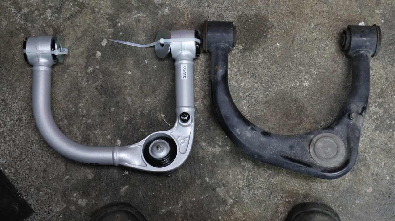

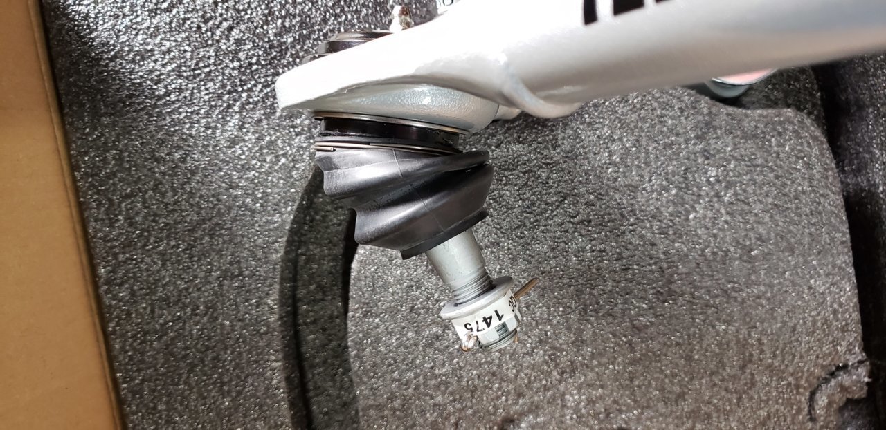

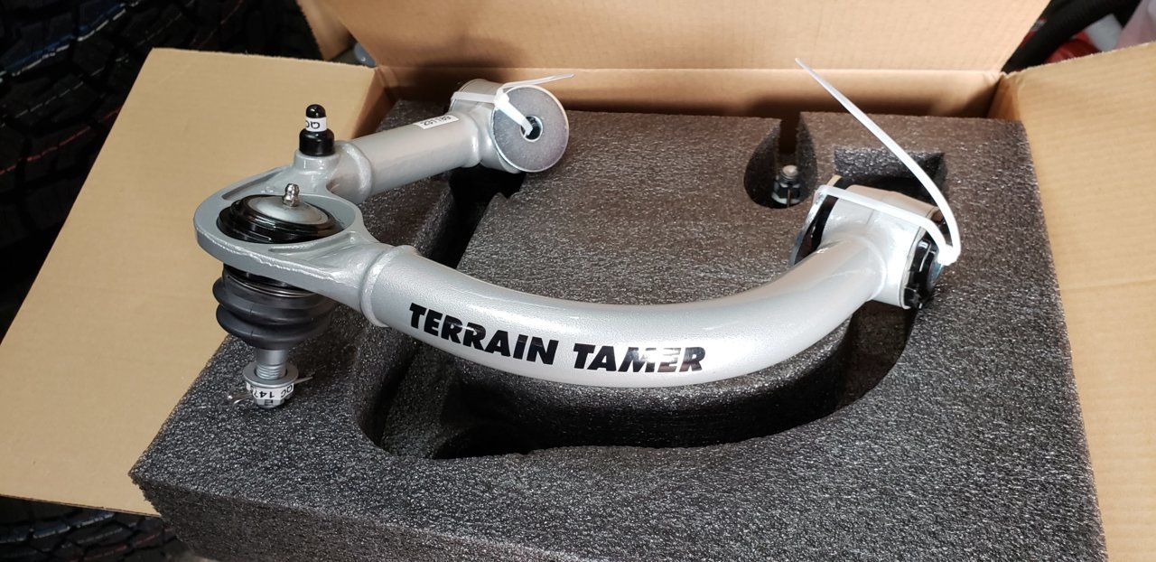

    After some research and deciding what UCA I would get for my truck I decided I liked the Terrain Tamer UCA. So here it is...
    20220201_131553.jpg 20220201_115425.jpg 20220201_115701.jpg 20220201_115729.jpg 20220201_115739.jpg
    They are nonadjustable and made for a 2" lift. The ball joint and bushings are serviceable.
    The ball joint is stock style with 80° of working angle.
    I will be installing these along with my lift and tires at the end of the month. I think they will be a good addition to my set up.

    I'm hesitant to add that to the list, as it doesn't outright say it's compatible with the Tacoma line of trucks. However, I agree that it will probably fit and it looks like the Old Man Emu UCA. I'm guessing Terrain Tamer is an extension of the ARB family.

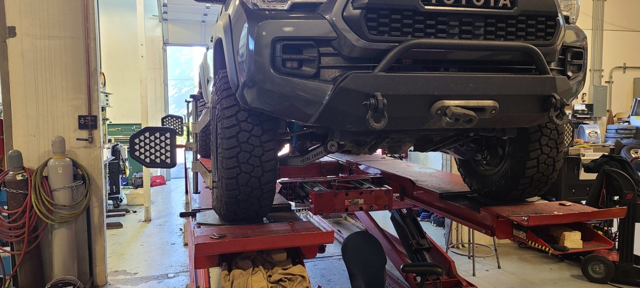

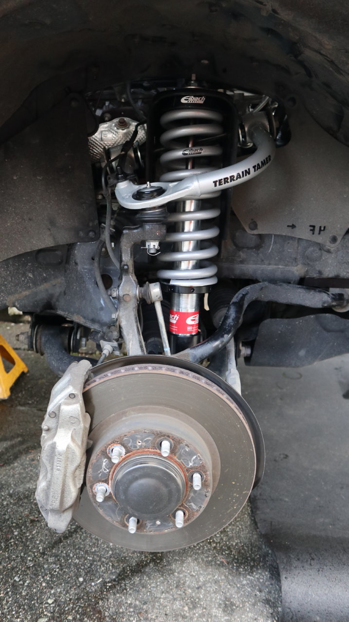

    Funny you ask... I did a little work today...
    I installed the lift and control arms today. Test driving it around everything feels good. I take it for an alignment next week. Looking closely at these, I think they are rebranded OME UCA's, as you suggested.

    Those look fantastic. They are 100% rebranded OME... it's like someone mentioned that before... :rolleyes:
    Once you get it aligned and assuming there's no issues, I'll add it to the list.
