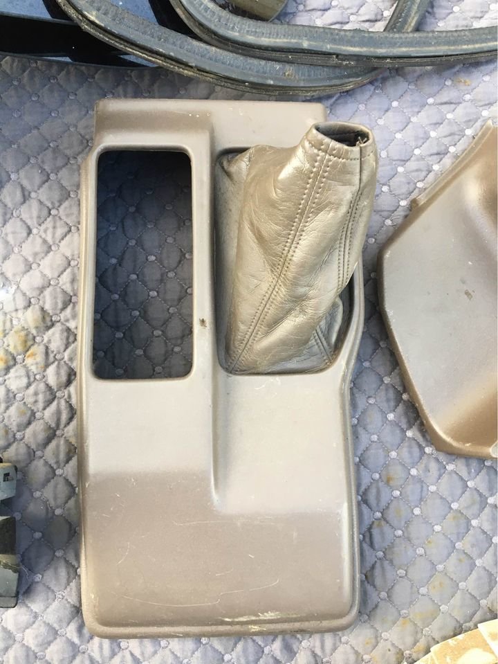

    02 3.4 DC TRD PreRunner 4WD SWAP
    Not sure where to post this so dumping it here. Not mine, just saw it on FB Marketplace. We all know how often these come up. 208580738_10227191991046096_404000892382_09e8492753f87a9367ee9ee412877db3d525bed7.jpg
    yotadude520[OP] likes this.

    You can actually buy these new from the dealer for about $65 at my local dealership - part #5880204080B0
    Area51Runner[QUOTED] likes this.
  8. Jan 13, 2022 at 2:44 PM
    Area51Runner
    Area51Runner Well-Known Member
    Jun 26, 2014
    #132748
    11,977
    Northern California, Bay Area
    Didn't know that. It's been a couple of years since I was looking into the conversion and I recall this basically being one of those unicorn finds. Thx for updating, I checked and ordered one online from a local dealer for $55.56 :thumbsup:
    To recap part#s,
    5880204080E0 is for an Oak interior
    5880204080B0 is for a Charcoal/Dark Grey interior
    EDIT: Now that I am looking at it closer, there are different descriptions for the Grey part#. Some say Dark Blue Grey and some say Charcoal/Dark Grey. Oh well, I'll update once I recieve it.

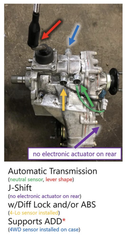

    Great info here, I'm embarking on the same and was hoping you could help answer some questions about the t-case. Assuming a j-shift t case for an A340F, what was the process for dealing with the existing sensors on the t-case? From what I've researched, there will be at least a neutral sensor, but also likely 4-lo and 4WD sensors as well. How are these used with the existing wiring from the A340E? I'm not even sure if they are necessary to use. It seems like most of the trans housing sensors are plug and play, but just curious how you managed the t-case stuff. Diagram from another thread for reference below!
  16. Feb 16, 2025 at 9:48 AM

    See my thread here -
    https://www.tacomaworld.com/threads...dicator-light-and-a-t-p-neutral-light.783875/
    Even if you aren’t doing the A/T P indicator, the rest will still apply.
    You can actually skip it altogether but if you want the 4WD indicator to light up when in 2LO/4LO you’ll need to wire it in. Totally up to you.
    For the VSS wiring,
    https://www.tacomaworld.com/threads/4wd-swap-how-to-transfer-case-vss-speed-sensor-options.786403/
    dngrrngr[QUOTED] likes this.

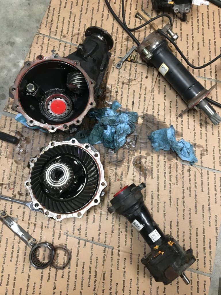

    3. What is a "front diff manual hub tube"?

    #3 - diff tube refers to the passenger side of the clamshell. There is a “tube” that is bolted to the clamshell and extends out and the CV attaches to the tube. There are three tube variations, 1) ADD (Automatic Differential Disconnect) vacuum found on 95.5-00, 2) ADD electric found on 01-04, and 3) manual for the locking hub found on 95.5-00. More likely you will be looking for the manual tube and setting it up with manual hubs. With the tube configuration in mind, CVs are different between ADD and manual, meaning they’re not interchangeable between ADD and manual.
    See picture, thanks to @BartMaster1234
    Top right is manual tube and bottom right is ADD tube.
