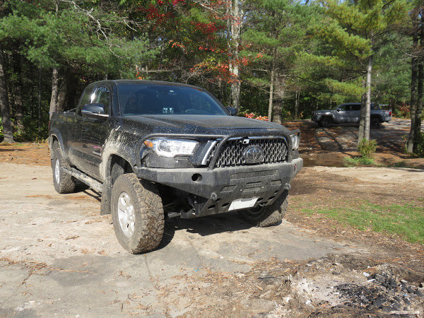

    Is that bumper from a 2nd gen? That grill cut in half looks mighty clean

    Yep, two solid days of trial fits and cutting, but end result is a lower profile than most 3rd gen bumpers. TSS functionality is retained on the stock grille, too.
    Only remaining item is to fabricate a couple of filler pieces out of rubbery fender liner material to cover up the area below the headlights.

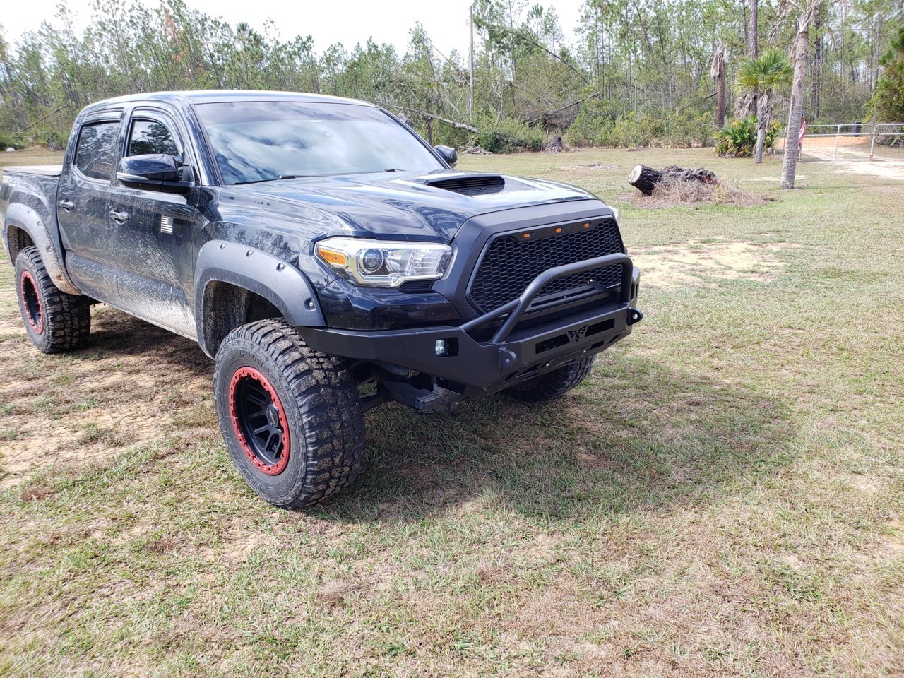

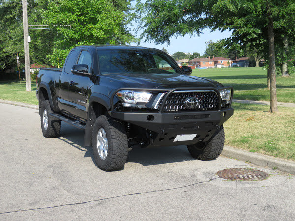

  8. Sep 23, 2019 at 4:36 PM
    #428
    3JOH22A
    3JOH22A トヨタ純正男娼
    Mar 27, 2019
    #288172
    13,029
    District 6ix
    3G Tacoma on 35"s, 5G 4Runner

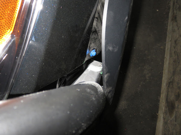

    I know. I'm already running GearTech splash guards. That material would be ideal, but I'm looking to spend in the $30 range instead of the $140 range. :laugh: I picked up a GrillPro BBQ mat from Home Depot today.
    hm9ImIU-ACyDfvpSKDbz63iNDv6AT3t5DvIJb_qy_a328c21f76dc58372654ce25286e1d029ea36b71.jpg SOG6Xuyt21TJ9ZFEqCRJjxsb6XGxpC_wAYvfnZl9_114685de8091e08cff8aa3b38b600e0e3ce7ea02.jpg
    Over the past weekend, I did more trimming of the bumper and raised it up another 3/4" compared to the photos.

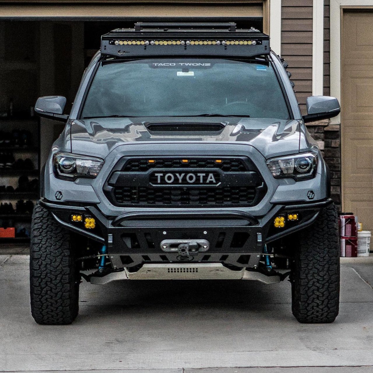

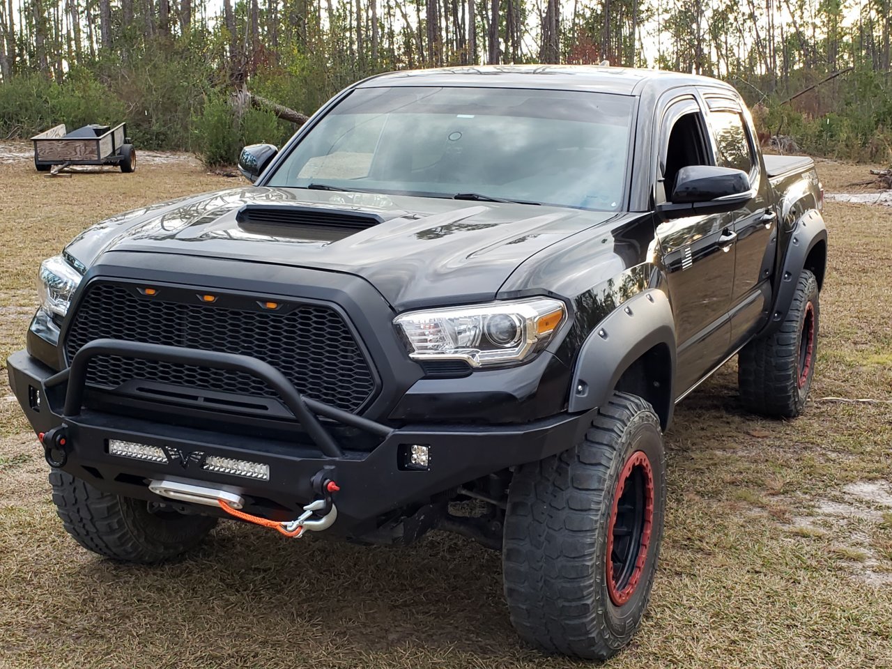

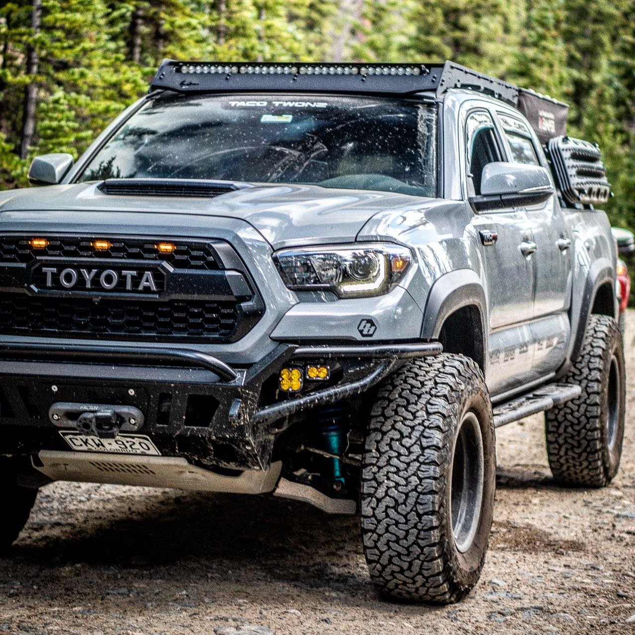

  10. Sep 26, 2019 at 8:55 AM
    #430
    wessyder
    wessyder Enlightened OR Bro who don't need no skewp
    Jan 3, 2019
    #278012
    682
    2019 Tacoma TRD OR, basically an off road race truck
    Tied several boat anchors to my truck to destroy MPG.

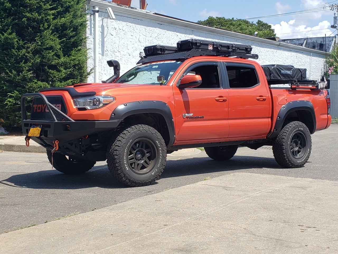

    Yeah this bumper is made by Lil B's Custom Fabrication in Denver, and they list it at 105, full steel.
    https://www.lilbscustomfab.com/product-page/tacoma-3rd-gen-hybrid-bumper
    I believe the Runnin4Tacos guys are resellers/testers for him, maybe the partnership even deeper than that. Runnin4tacos also may have actual stock vs ordering in and having it made, IDK.
    I ordered this one direct from LilB and just waiting for him to make it just because I had a bunch of questions and wanted to talk to fabricator, so I was talking to him already. Here are some pics by Runnin4 aka Taco Twonz of the bumper on their truck:
    https://www.runnin4tacos.com/collec...s/hybrid-front-bumper-2016-2019-toyota-tacoma
    I also really liked the BAMF hybrid of aluminum/steel that they announced recently and have on sale.

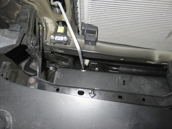

    Standard modifications to fit typical 3rd gen plate bumper:
    • Relocate power steering cooler. Either fab your own brackets or buy them separately from a 3rd gen bumper vendor. I bought All-Pro P/N AP-305706. They came bare steel. I had to paint them and source a pair of 5/16" dia. nuts and bolts.
    • Trim plastic radiator ducts.
    • Trim fender liners.
    • Trim fender flares.
    • Either cut your plastic bumper cover or fabricate filler pieces for the gap below each headlight.
    • Coilover adjustments as required to restore ride height.
    Additional modifications to fit 2nd gen plate bumper on 3rd gen. Everything above plus:
    • Make a cutout on the winch platform to clear the A/C line. A hole saw worked well for this.
    • Trim about 2" from each corner to clear the fenders.
    • Make a horizontal cut through the grille assy below the Toyota emblem. 2018+ trucks with the Pro grille will lose TSS functionality.
    • Notch the grille further in the LH and RH corners to clear the hoops as required.
    The 2nd gen and 3rd gen frames are similar enough that all the hard mounting points are identical for the front bumper.
