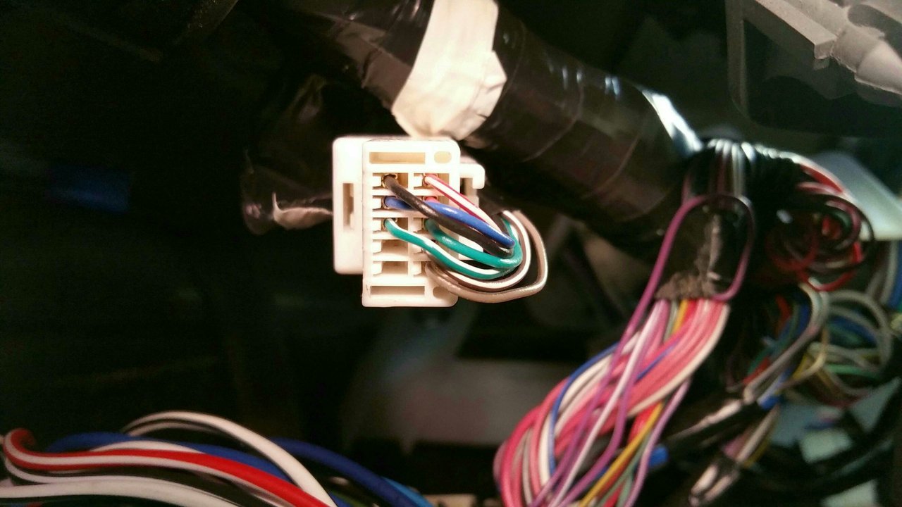

    I just did this mod to my 2009. I didn't cut the power to the TPMS system. I Just turned off the light.
    I located IJ1 on the passenger side kick panel. Post 3 of This thread shows its location http://www.tacomaworld.com/forum/2nd...ble-guide.html
    My IJ1 was taped almost behind another larger harness. I located the blue wire, cut it, tapped into the harness side of that blue wire, and jumper-ed it to the yellow wire in another harness as reloadedkid did in post #13.
    Worked like a charm.

    I think I found the plug it was hiding behind the same harness and taped there. But I have 3 wires (green/blue/black) the blue is in the same port as in your picture but I wanted to ask before I start cutting. Truck is a V6 6Spd 2015 DCSB Off Road edition. Any help would be appreciated.
