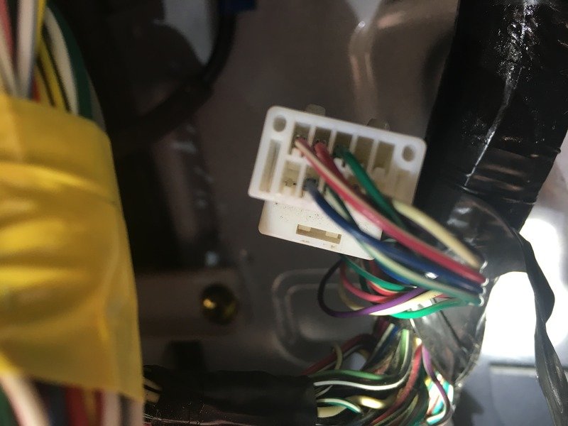

    I realize this thread has migrated to th newer trucks, but i haveyet another method for my 08 Xrunner. I unplugged the TPMS module, and at its connector I jumpered the power supply wire (light green) to the blue wire. Power is disconnected (sort of), no cutting, no splicing.

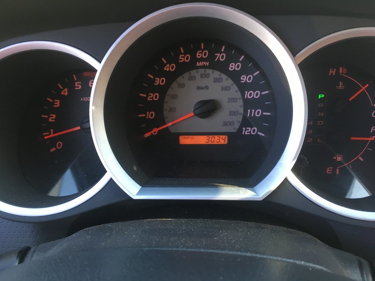

    IMG_4775.jpg Finally no more light! Been looking at that stupid light for 5 years. The op's way worked for my 2007 but I ran power to the blue wire v's grounding it.
  9. Sep 29, 2017 at 7:59 AM
    #89
    Drainbung
    Drainbung Somedays you are the show....
    Sep 2, 2010
    #42629
    9,329
    Bob
    Fallabama, NV
    10 DCLB
    TRD Fleshlight
    I'm not sure what you're saying: "but I ran power to the blue wire v's grounding it". Did you have to do something different from the OP?
  10. Sep 29, 2017 at 8:21 AM
    #90
    1rooster
    1rooster TACOMA31750
    Jun 14, 2010
    #38925
    982
    Georgia
    2007 Tundra crewmax
    5100's ALL WAY AROUND, 885X COILS, DRIVER SIDE LEAN SPACER, ICON PROGRESSIVE AAL W/O OVERLOAD, 265/75/16 KENDA KLEVER M/T. 1 1/4 SPIDERTRAC WHEEL SPACERS, GEN 1 TRD COLD AIR INTAKE, STOCK MUFFLER WITH CHOPPED TURNDOWN, 5% TINT OVER FACTORY, DEBADGED, TOYOTA RUBBER BED MAT, WEATHERTECH MATS,UWS TOOLBOX, UNDERCOVER SE, LOCKER MOD, REAR BUMPER, PIONEER DOUBLE DIN WITH PARKING BREAK OVER RIDE, CUSTOM OIL CATCH CAN, FULL LED INTERIOR, ARB BUMPER REPLACEMENT. COVERKING SEAT COVERS. MORIMOTO H1 MINI COVERSION WITH MINI GATLIN GUN SHROUDS AND 5000K MORIMOTO BULBS. TRAILER PLUG RELOCTED TO BUMPER. 20 INCH LED LIGHTBAR MOUNTED BEHIND CUSTOM PAINTED GRILL. STUBBY ATNENNA
    Yes, I did not ground the blue wire behind the glove box but instead I did what the gentleman done in post 13. It worked for me.

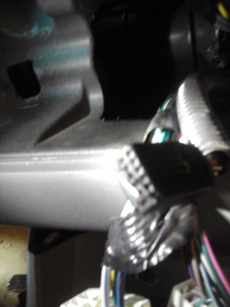

    Hi,
    I have a 2006 Tacoma Prerunner and I want to disable the TPMS due to flashing light. I have located the DA connector but not sure if I have located the IJ1 connector. The one I found (taped to the main harness behind the glove box) is a 10 pin connector with 7 wires. 4 in one row (White, purple,Green/white, Blue) and 3 in the other (Green, pinkish,Red/white) .
    Can anyone tell me if this is the right connector and do I cut the blue wire and if so which side of the wire do I ground....or do I splice into the wire and ground the splice?
    I tried to post a picture, but haven't figured out how to do that yet.

    here is the picture of what I think is the IJ1 connector
