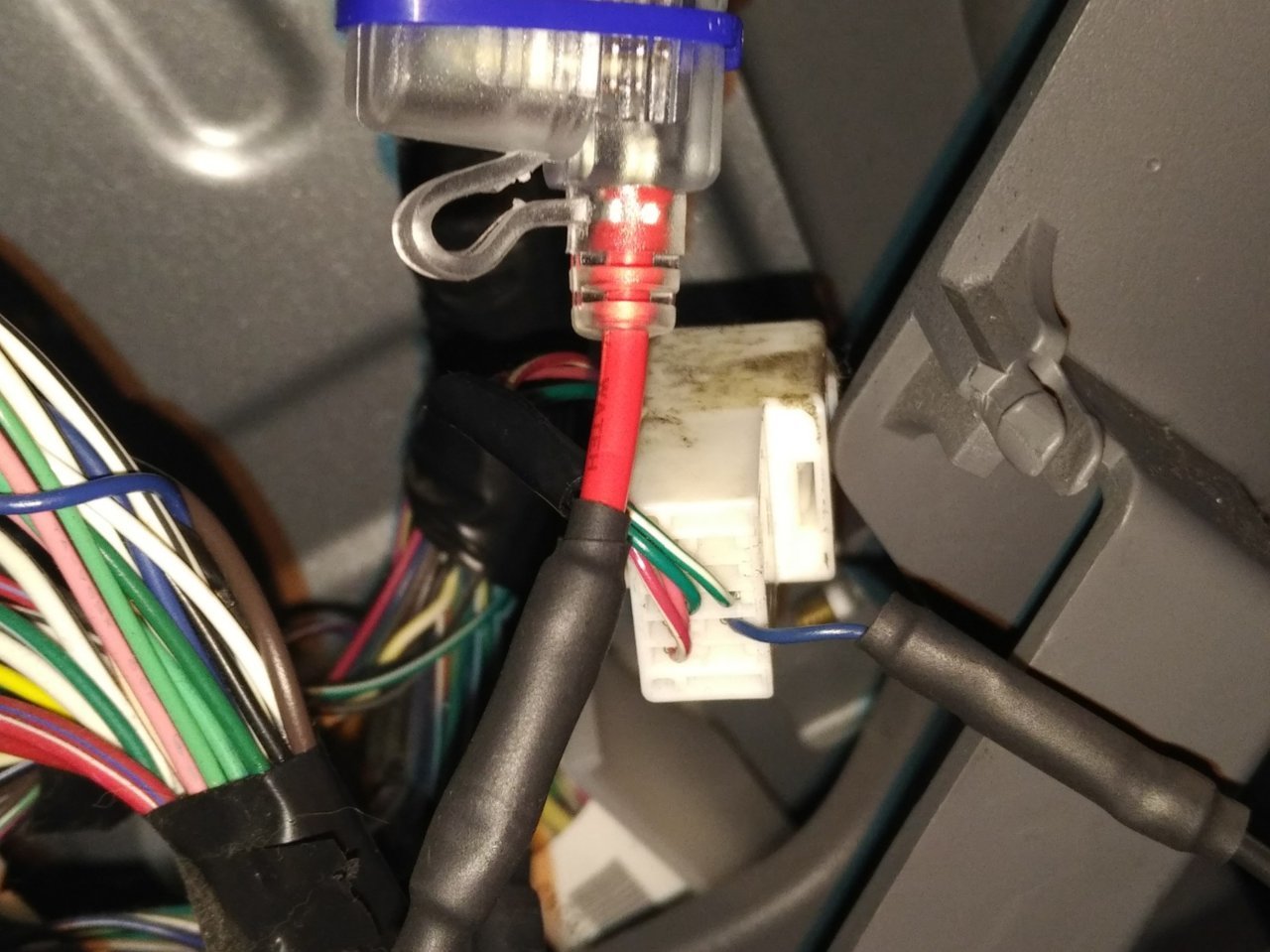

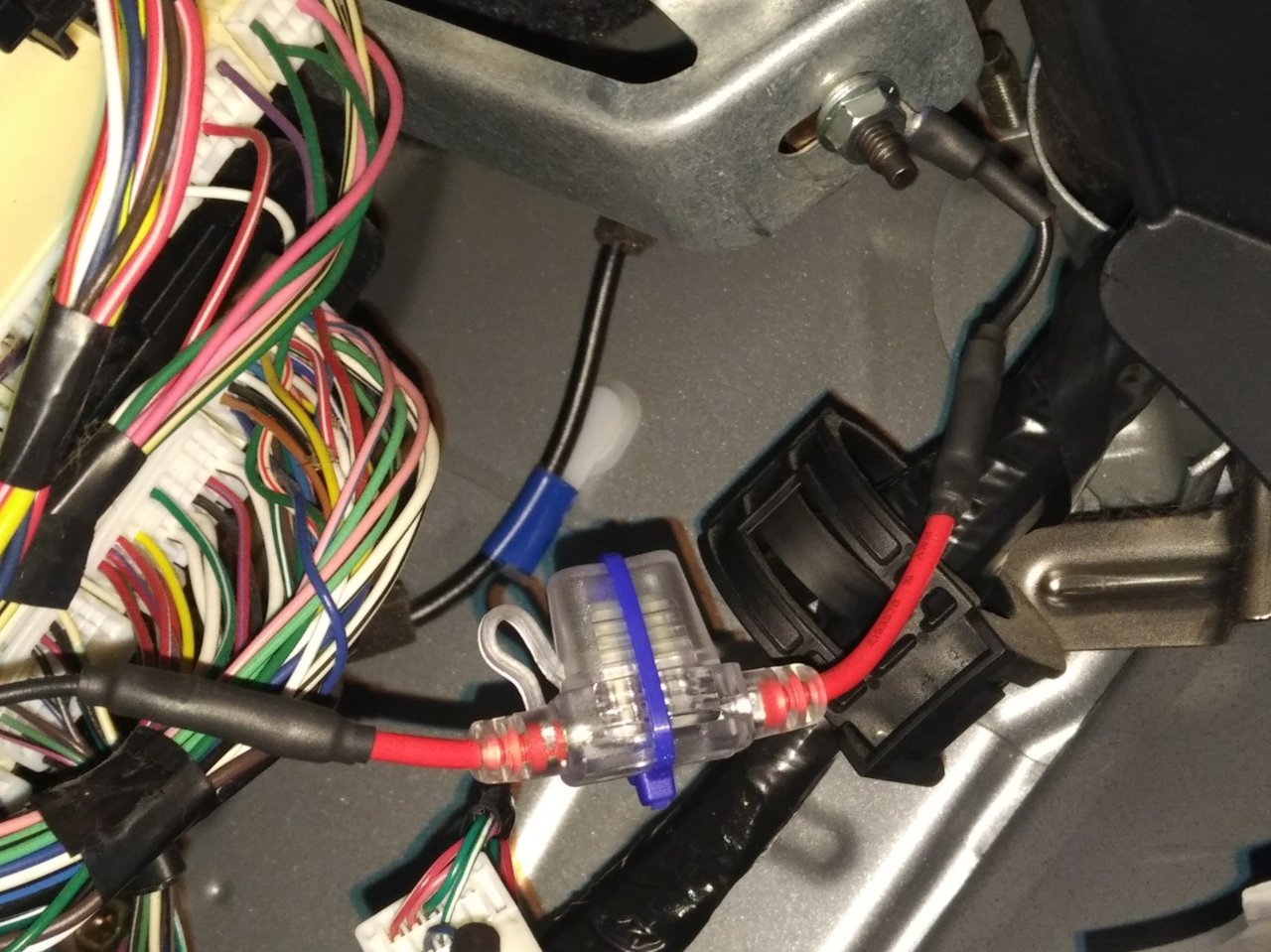

    The mod worked on mine well. Instead of cutting wires, i removed the said pins from the connector bodies, insulated the one for power (driver side), pulled the blue wire pin on the passenger side, and grounded it via a small fuse. insulated everything, tucked it all away, and reassembled the trims.
    Worked like a charm!

    So all you did was just
    Pull the driver side power one out.
    Pull the passanger blue wire and ground it.

    yep. Pretty much. Insulated it all with some shrink tubing, and tidied up the bundles back in their stock places. I did not use any solder or crimps on the blue wire, but just threaded the grounding extension through the pin, wrapped it around it tight and then double-shrunk tubing on it. This way the fix is easily reversible.
    I will dig out some of the photos i shot, but that's really it. Worked as advertised.

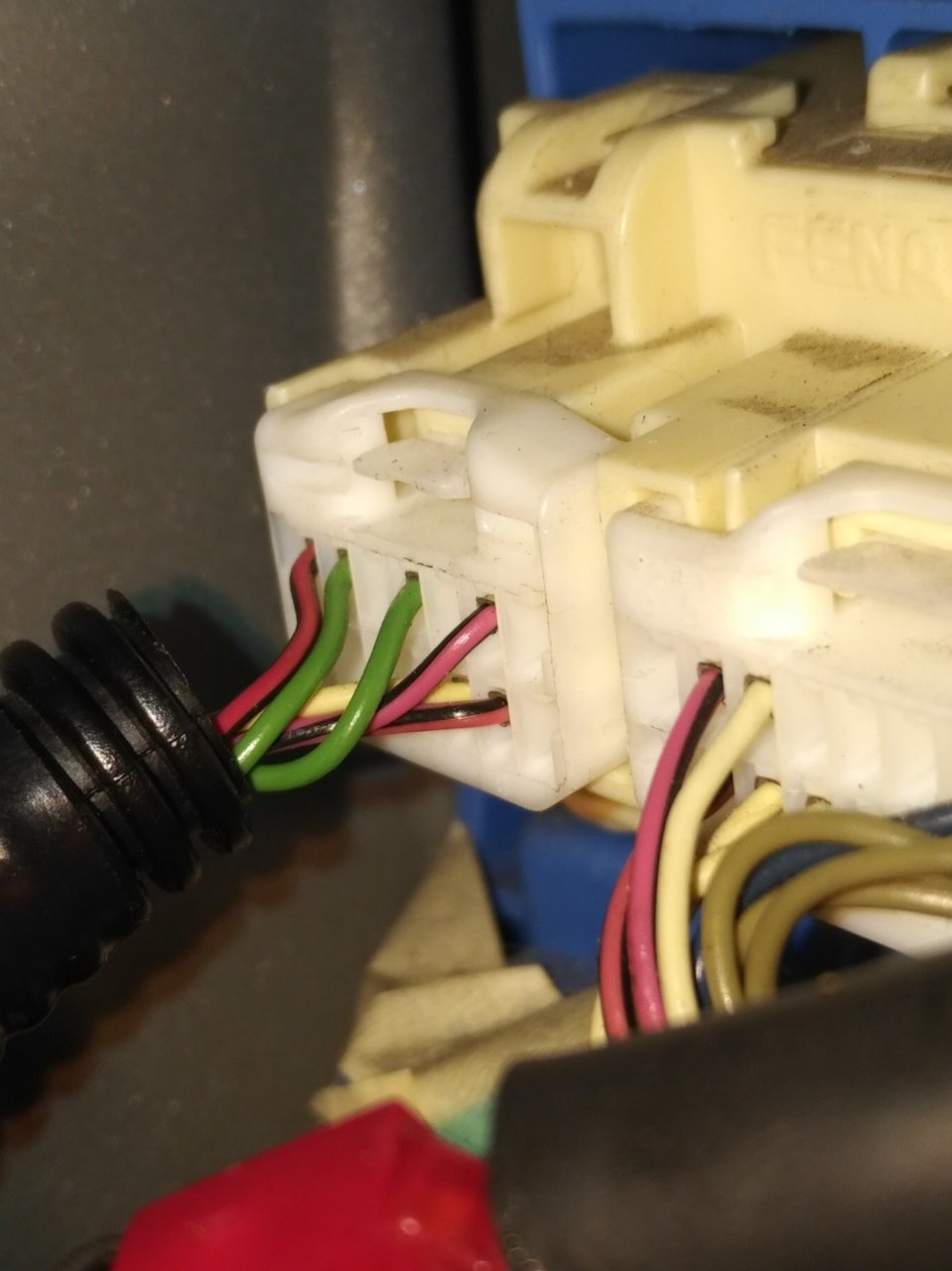

    Can someone tell me how to get the cluster out of the dash on a 09 Tacoma access

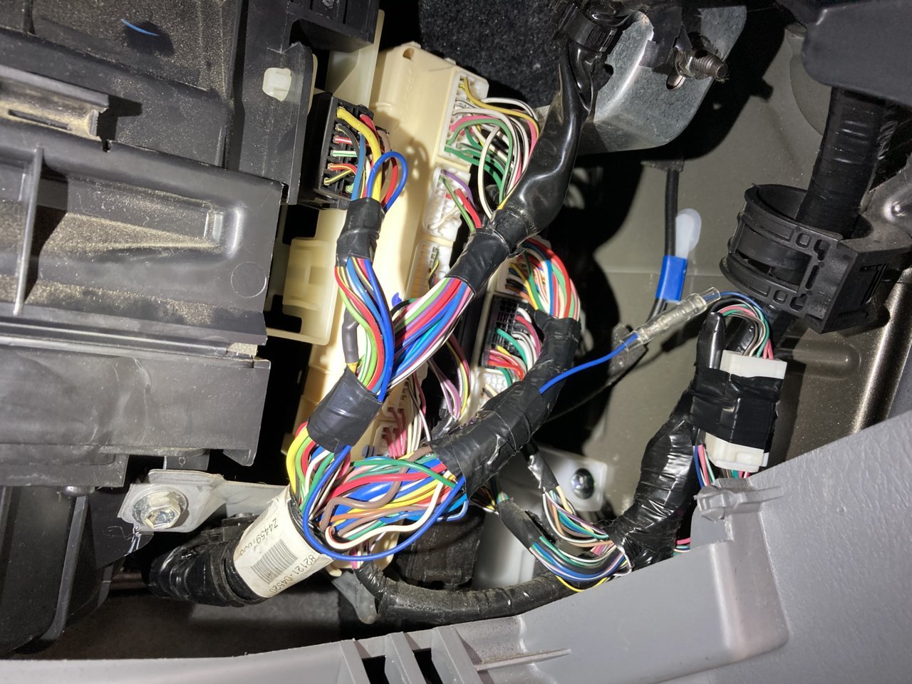

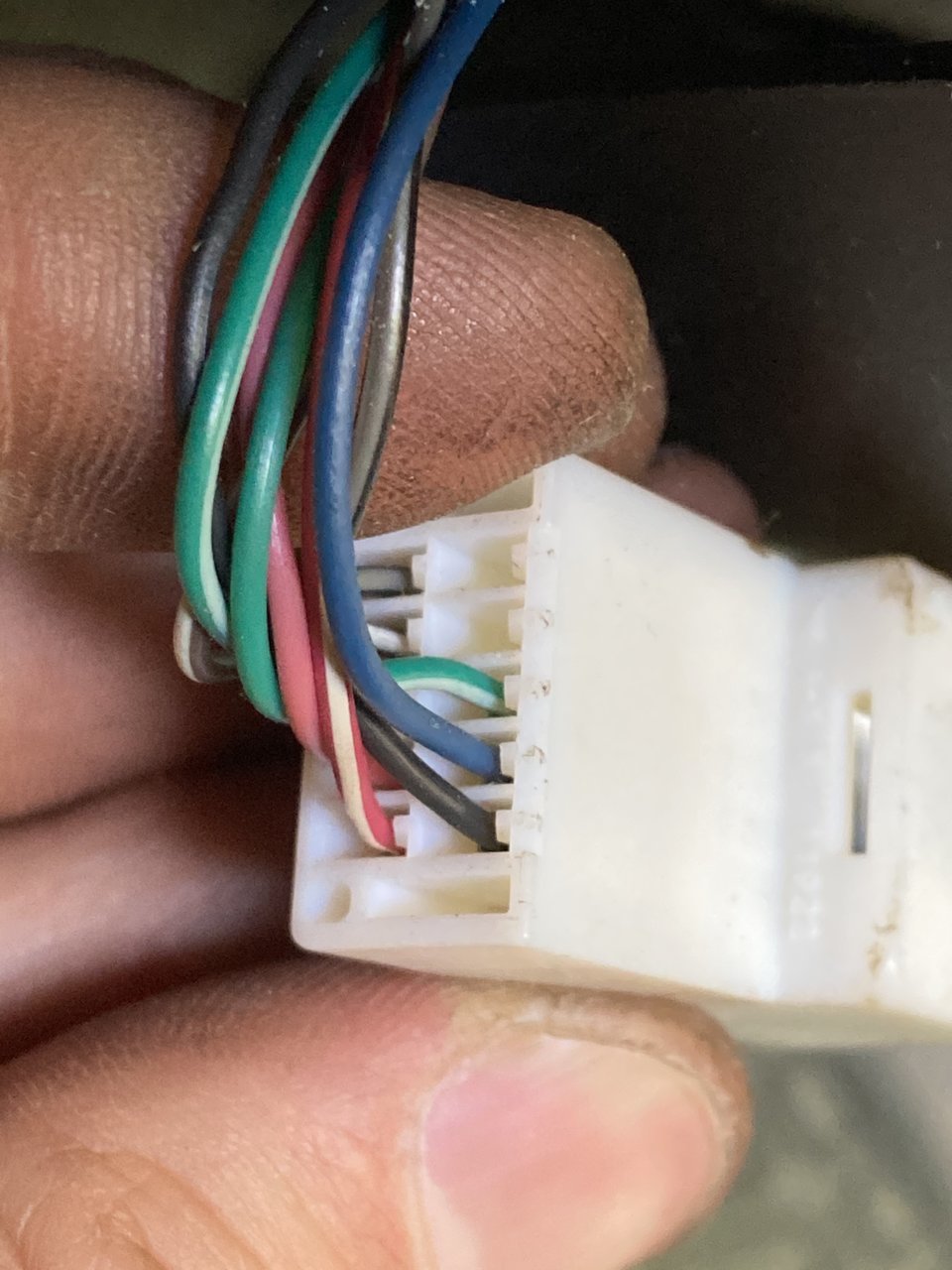

    I tried this fix. I got the blinking TPMS light to go off. However, when I test drove the truck, I noticed that it was idling at a lower RPM than it normally does (don't remember specifically what RPM). When the truck's engine got up to temp, the RPMs @ idle dropped to 400 and the truck wanted to stall out.
    Luckily, I was just around the block and was able to nurse it back home. I disconnected the battery, reconnected all the wires (had used quick-disconnects as recommended by OP), reconnected the battery, and the engine's RPMs seemed normal at idle and while cruising. Of course, the TPMS light is back blinking again.
    Does anyone know what went wrong? I have a 2006 Tacoma regular cab w/ the 2.7L + 5 speed manual transmission.
    I attached three pictures:
    -picture 1: junction block DC-DA (cut green wire, top row, 4th from the right)
    -picture 2: wiring harness IJ1 (grounded blue wire at to of harness. the wire next to it was green/yellow-not solid green as OP stated)
    -picture 3: close up of grounding for blue wire
    edit: forgot to mention i wired a 2 amp in-line fuse before the ground for safety.
