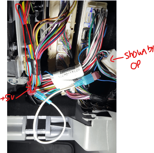

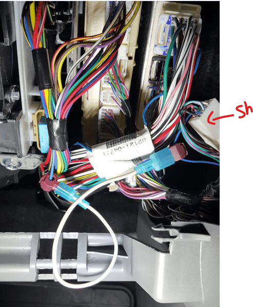

    Hello men, I have a 2010. Can someone elaborate where they get/find the 5v power for the right side? Did you take a meter and test a bunch of pigtails until you found it? Or is it easier.. Thanks

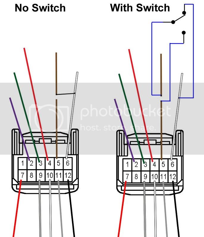

    Does anyone have the link to the guide to wire in a SPDT switch which allows you to enable/disable TPMS? I did this back when I got my truck as I have two sets of wheels, and one set didn't have sensors. Can't seem to find it anywhere...

    I found this picture, but no guide or thread. This looks similar to what I did, if I remember correctly.
    I may put it back to normal as I'd like to use that spot in the dash for something other than this switch.

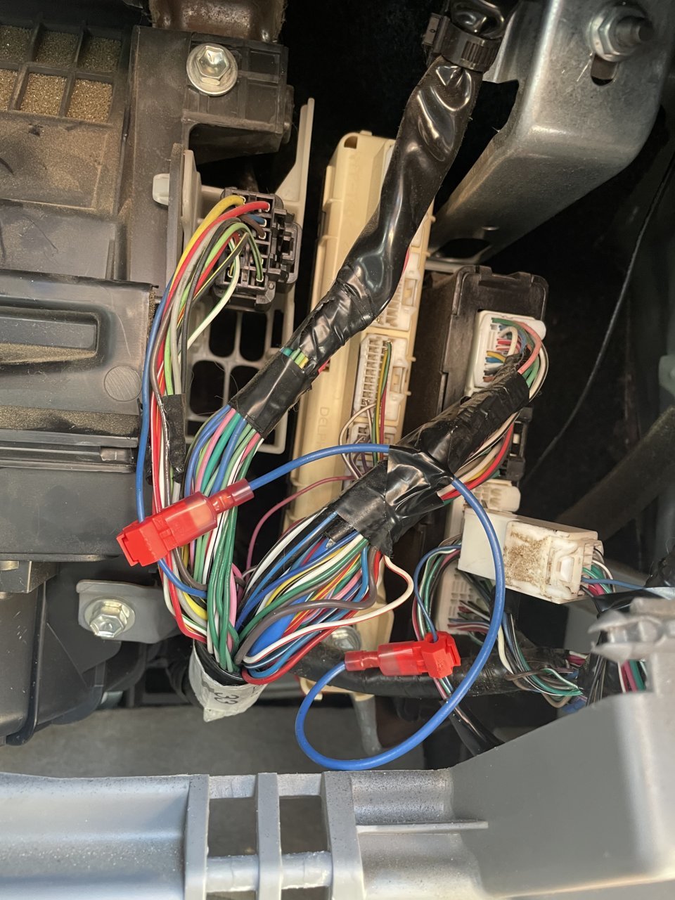

    For reference for anyone still looking to do this, OP's method of grounding the blue wire only works for 05-06. For 07-15 (I did it on a 2013 TRD Sport) you need to give the blue IJ1 wire power, not ground. Many people jumped the blue wire IJ1 connector wire with the +12V yellow wire from another connector, and while that does seem to work, another thread with more wiring info says that under normal operation it is looking for only +5V, which triggers it to shut off the light. In light of not providing it with a full 12 volts that it isn't designed for, I used the blue wire below the big yellow wire some people used. As with anything I would check with a multimeter that the wire you tap into is indeed a +5V with the key on before you jump it to the blue wire from the IJ1 connector on the far right. These wires are also much more accessible than the method of doing it behind the radio and everything, and very easily reversible by just reaching down and unplugging the jumper. Picture below is from JunkBox's post, I only labeled it after doing it myself successfully.

    Just did it the way you wired it (Peter603taco) and it works. I have a 2010, used the same t connectors and male disconnects to get the 5v power. Nice job explaining brother!

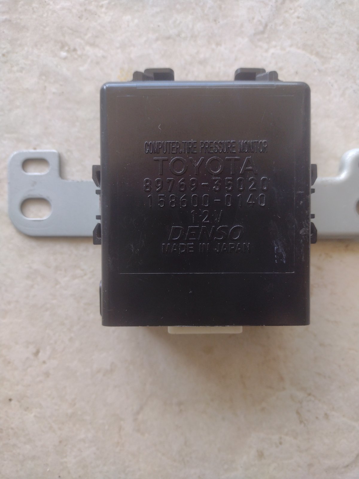

    2006, access cab. Where is the tpms control unit. I purchased pn 89769-35020 and intended to replace it. I will try to attach a photo. My wiring diagram shows it behind the clove compartment but it's not there.
    Head liner maybe? Behind the radio maybe?
    Please include a photo of the location if you can. Thanks 17134598069248257452667027807715.jpg

    Did this on my 2014 this weekend. Behind the glove box, jumped blue to blue and light is gone.

    My truck is a 2012 double cab. The module is exactly as shown in the post above. If someone sits in the back seat, driver side, the module is right over their head.
