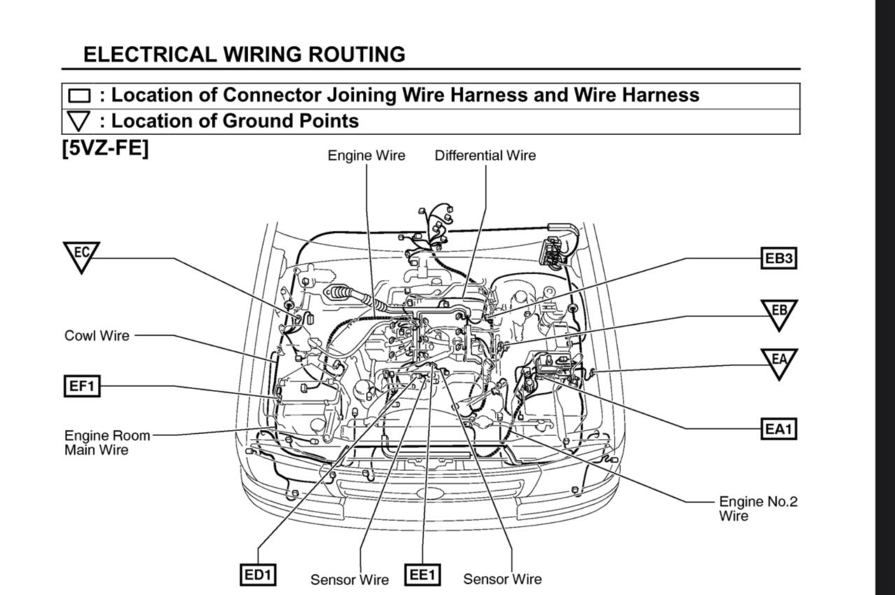

  5. Apr 22, 2023 at 9:02 PM
    Dm93
    Dm93 Test Don't Guess
    Mar 3, 2015
    #150066
    12,874
    Texas
    2014 DC OR 6spd 4x4
    Predator tube steps, Ranch Hand grill guard, Magnaflow CatBack exhaust, Toyota tool box & bed mat, 2LO Module by @Up2NoGood, Rearview Compass/Temp Mirror, Tune by @JustDSM.
    TnShooter[QUOTED] likes this.

    You say you had the throttle body off?
    Check the EB Ground
    Dm93 and Superdave1.0 like this.

  8. Apr 23, 2023 at 3:51 AM
    Thr45h
    Thr45h [OP] Active Member
    Oct 8, 2022
    #407586
    27
    02 tacoma double cab
    Led headlights. Led interior lights. Atoto head unit. Rear camera
    I have to go in to work today and the truck is at my parents house so I can't check the ground until later today.
    I didn't think any thing of it when the code reader wouldn't work. I thought it was because it was a cheap 20 dollar code reader on the discount rack at orileys.
    Later today I'll disconnect the ground and wire brush where it connects because I did paint the plenum.
    I will also try and get a different code reader and see what happens.
    I'll report back tonight.

    In addition to the above…
    Check the EB1 ground first. Take the ground harness off and wiggle each wire individually where it enters the ring terminal. These have a tendancy to break internally. These grounds ground the PCM, and many other important electrical components. While at it verify the ground strap from the P/S cylinder head to the firewall.
    If you have had a marginal battery and have cranked it over and she has not started, a low voltage conditon exists and this by itself will cause bizzare codes. Same thing with flaky grounds. Write the codes down, clear them, put a good battery in her and see what codes comes back.

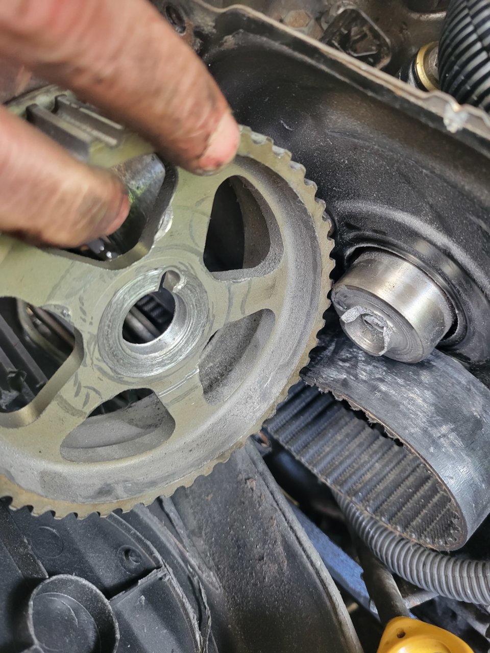

  13. Apr 23, 2023 at 10:59 AM
    Thr45h
    Oct 8, 2022
    #407586
    27
    b_r_o likes this.
  14. Apr 23, 2023 at 11:10 AM
    Dm93
    Mar 3, 2015
    #150066
    12,874
    Texas
    2014 DC OR 6spd 4x4
    Oh... that's not good.
    Looks like something caused the cam to lock up, shearing the pin and bolt off.
  15. Apr 23, 2023 at 11:13 AM
    Thr45h
    Oct 8, 2022
    #407586
    27
    That's what it's looking like. I tried my best to get all that gunk out and vacuum everything. I knew a flush would be risky.
