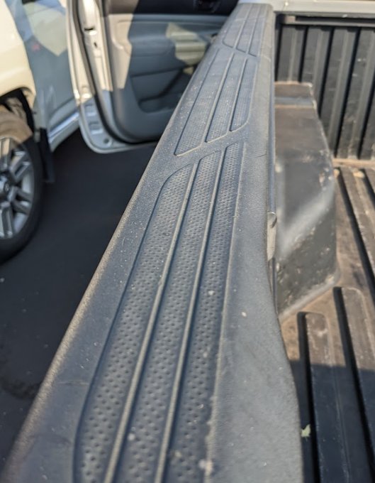

    birry
    birry [OP] Well-Known Member
    Oct 5, 2012
    #88370
    630
    Oklahoma City, OK
    2008 4x4 DCSB
    OME 885, Bilstein 5100's, Wheeler's (single) AAL
    I tried getting a pic of the sparkling on the rails, but my camera kept auto-correcting them out. But it sparkles like it has some amount of fibers in it. I'll keep working on solutions, and report back if I come up with any findings.
    This is the best I can get. If you look closely, you can see thousands of tiny white dots. Those are shiny reflections in real life, but my phone wouldn't pick them up or filtered them out.

    So, if an aircraft crashes, and it has composite materials on it, we use sprayed wax, to encapsulate the carbon fiber so we dont breathe it in. Try waxing those rails...just a thought.

    Those "sparkles" are likely due to UV damage to the plastic. UV radiation typically isn't ionizing, but it can create free radicals that significantly degrade the plastic over time.
    The exterior plastic parts on our trucks likely have additives that inhibit this deterioration, but if the truck is parked in the sun all day, every day, the plastics will inevitably break down over time.

    Gel coat or Raptor Liner are probably the best choices.

    Any product you can wipe on with a towel won't work (303, wax, armor all). Because the bed rails are fairly easy to remove, just pop them off, wipe them down with alcohol and then give them a few layers of matte UV resistant clearcoat. As with all spray painting, the first few layers need to go down with a broad mist so you can build up first, and then your last coat can be "wet" (avoid excess that may drip though).
    Krylon or Rustoleum will probably hold up OK, but if you want to do it right go to an auto paint and body supply store and ask them for a recommendation. Expect to pay around $20-$25 for a single can.

    I have anodized aluminum bedside caps (and tailgate cap) on mine because I hate plastic caps with a passion. Mine are KB Voodoo, quality is OK, but much better than plastic in my opinion.
    If the caps are made of a thermoplastic then another option is to take a torch to them to semi-melt and the recrystallize the polymer (i.e., heat it without melting it, then let it cool). This can be tricky though as you don't want the flame to be too focused or you'll create hot spots and start to burn it, a nice wide flame works best. That being said, I'm not sure exactly what the bedside caps are made of or if it's even a thermoplastic. There might be some material info on the underside of the caps though. I'd check but I trashed mine long ago.
    If it's ABS or a similar polymer, you can also treat it with acetone to chemically "smooth" the damaged surface. But this is also tricky because you really only get the best results with acetone vapor and not just wiping liquid acetone onto it since you have a hard time applying it evenly and it evaporates too quickly.
    If you try either method, test it on a small, inconspicuous area first.
    You can also coat them, as other people have mentioned. I've had success with Raptor liner (did my bed and bed cubbies in Raptor liner).
    With all that being said, I still think aluminum caps are the best option, but you definitely have other options.

    I haven't done anything yet; just been avoiding touching it with bare skin for the most part! But mine has also been kept outside most of its life, so it is for sure the result of being left in the sun and the material breaking down. I may eventually try some kind of paint or wipe-on product, but for now I'm just avoiding it altogether.
    Let me know if you try something and how it works.
