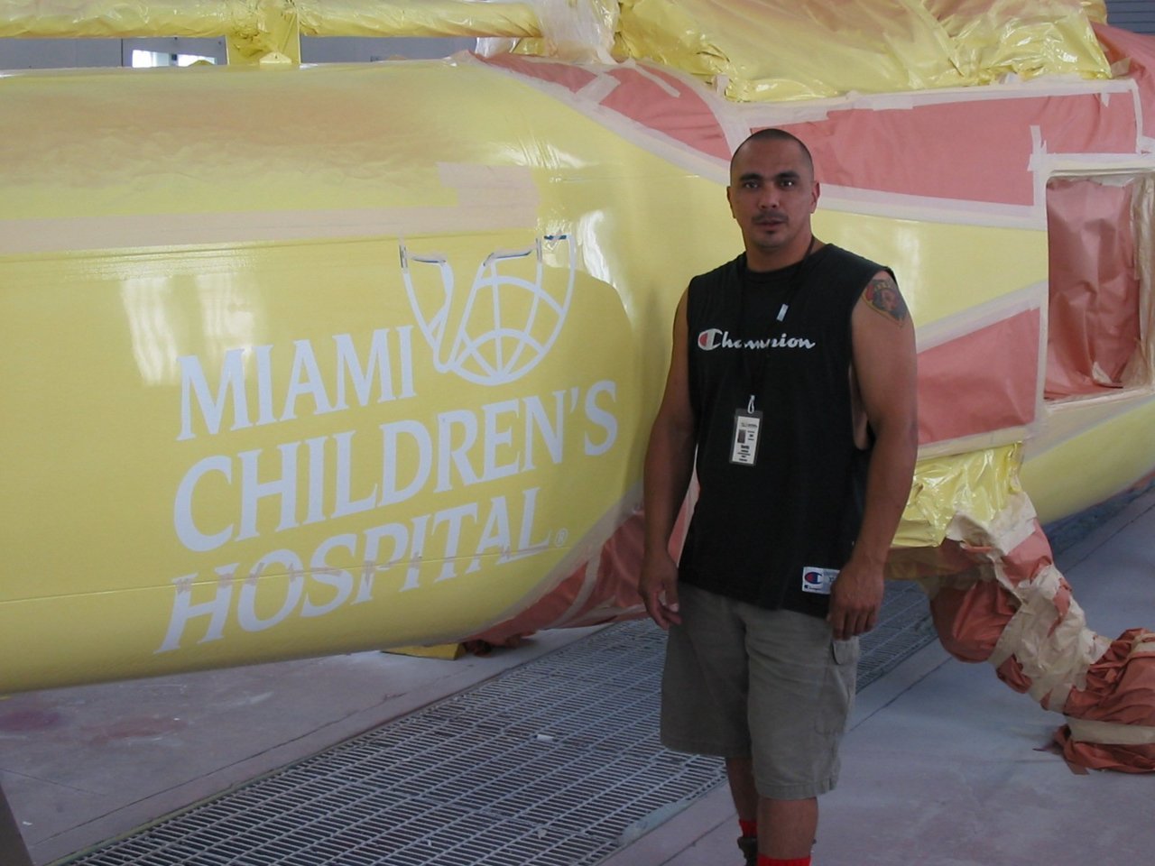

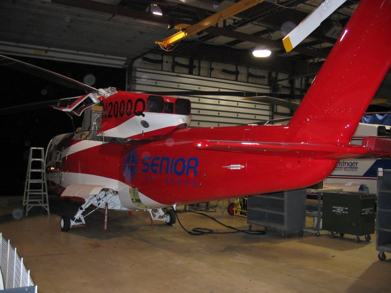

    28 year vet painter.
    Senior Taxi (2022-09-08T20_19_59.339).jpg Screenshot_20220908-131342.jpg Childrens Hospital 006.jpg
