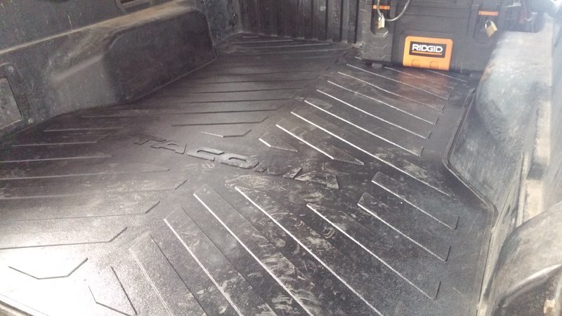

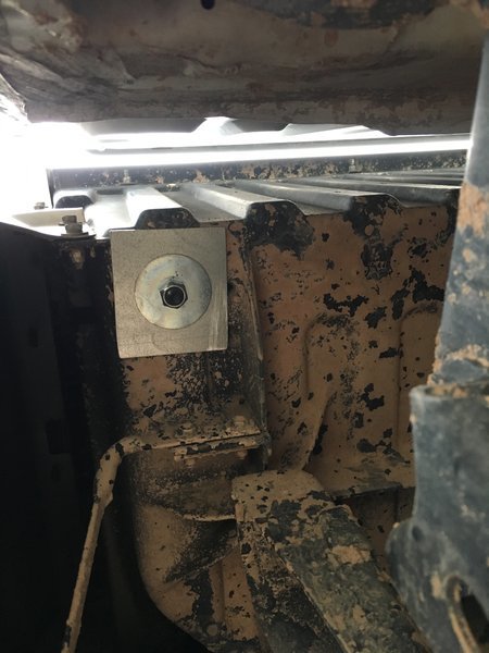

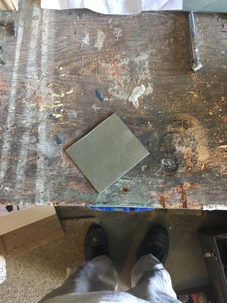

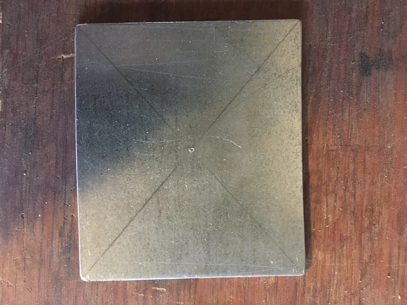

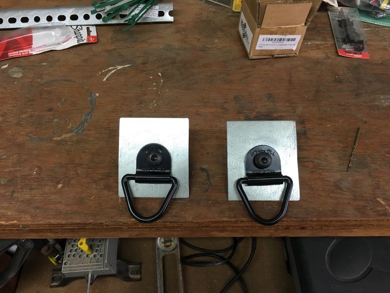

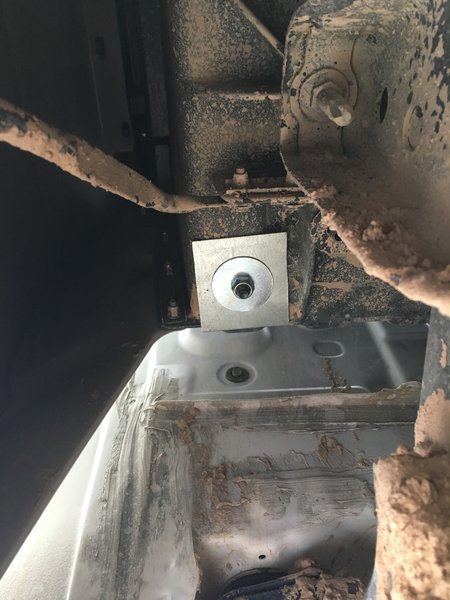

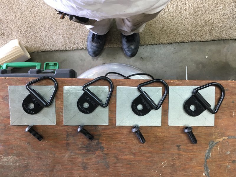

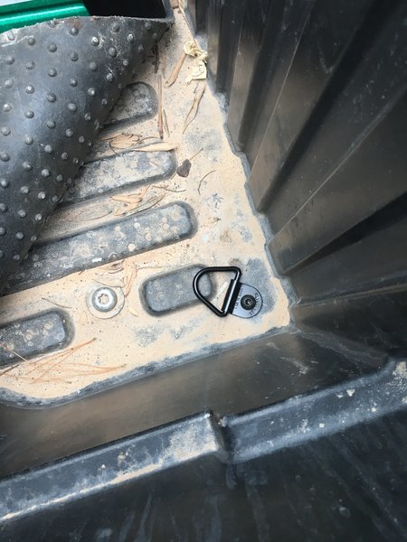

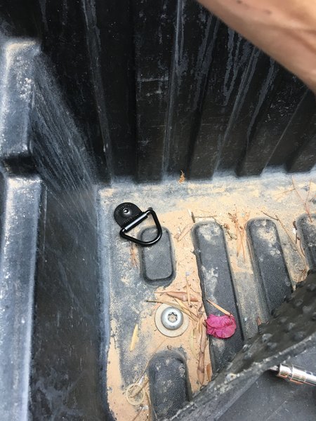

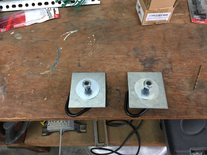

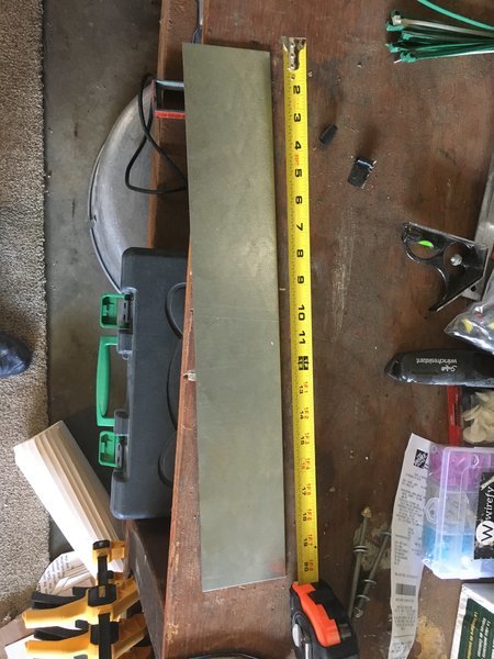

    Well the deed is half done, got 2 tie downs installed in the front corners of the bed and I gotta say, I only spent like 14$ to get 4 tie downs ready to be installed.
    I made my own backing plates, they are roughly 3"x3" and got some nice M10 button head bolts and some big washers and lock nuts. Here are the pictures I promised. I have 2 installed and 2 more already to go when I finally choose where I want them.

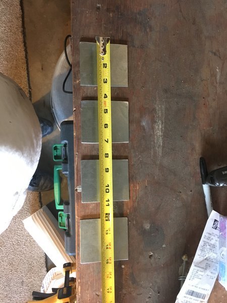

    How thick are the backing plates?

    Man, you need to take the shop vac to the underside of that bed mat once in a while.

    Hahaha yes I do, I'll take the hose to the bed when I clean her next, went out to the desert 3 weeks ago and never deep cleaned it.
    They are only 1/16" thick... and the 2 1/2" inch washer is also 1/16"

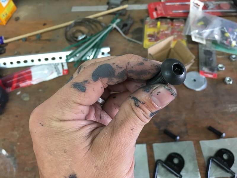

    Reviving a thread that’s pretty dead, but hey I need some assistance. I know it’s an M10 button head you used, but what length bolt did you use for this project.

    The bolts look to be about 1" in the pics he posted.
