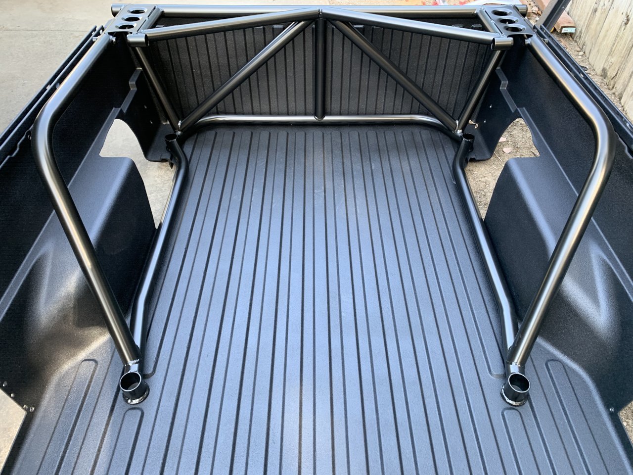

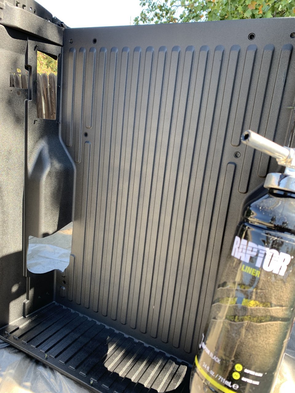

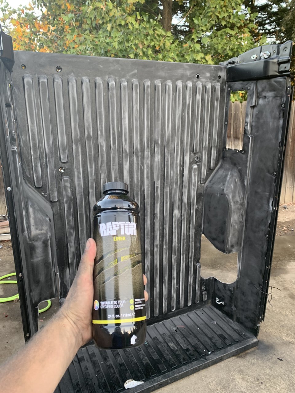

    Hit mine with 100grit sander, then raptor liner. So far it feels really solid and looks brand new. Also it has a little texture now so it’s not as slippery as the stock surface

    That's quite a project you got going on there, Stew. I'm assuming you sprayed it on?

    Yes. Comes in a kit with the spray nozzle, just hook it up to a compressor. Super easy to spray on and very forgiving.

    This looks fantastic! Does it seem fairly durable? I may have to do this some day as this is the kind of finish I'm wanting on the bed.
