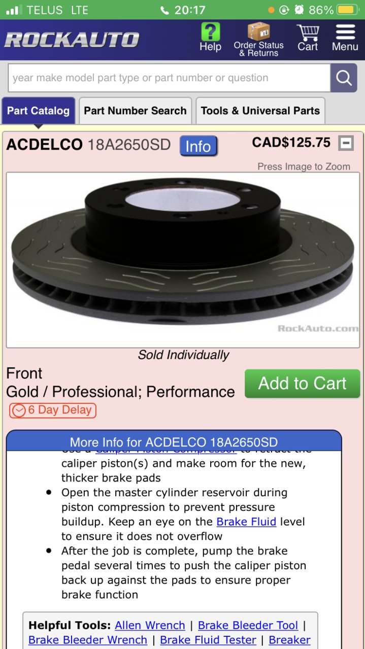

    Anyone ever use these Composite brake rotors before? Also curious on what everyone's thoughts are.
    ACDELCO 18A2650SD

    Presumably yes. I'm a little suspicious about it looking like it's cast as one unit because I feel like under hard braking and high heat the two different metals expanding at different rates may cause them to crack and separate which would be no bien but, I assume they wouldn't sell a product so main stream if they weren't confident... I wonder what the weight difference is between the composite and a factory disk... anyone need brakes soon aha

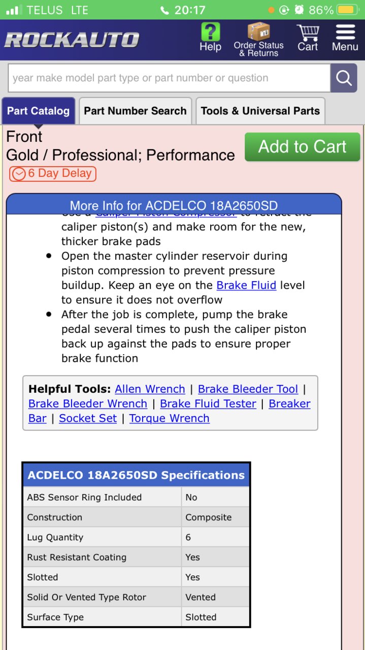

    Put a set of coated (composite) rotors on my Tacoma a couple of years ago. Coating prevents rust but will wear off where pads contact disc. No advantage other than that. Not really composite, just called that!

    That ACDelco part is not a traditional Composite rotor. Thats just a painted iron rotor.

    I would say the Rock Auto ad is incorrect in saying 'composite'.
    Because it's not, it's a coated or treated rotor.
    A true composite rotor is not really street friendly and would cost many times that amount.

    I have not looked at the ad but “true” composites are materials like carbon ceramic, graphite, Kevlar, fiberglass, etc.. some ABS plastics are confusingly identified as composites. As someone who has fairly extensive design and manufacture experience with composites for aerospace I can tell you the material cost alone is much more than the listed price for these Rock Auto rotors. Besides the carbon ceramic rotor listed in the above video I wouldn’t spend much time considering anything made with a different material.
