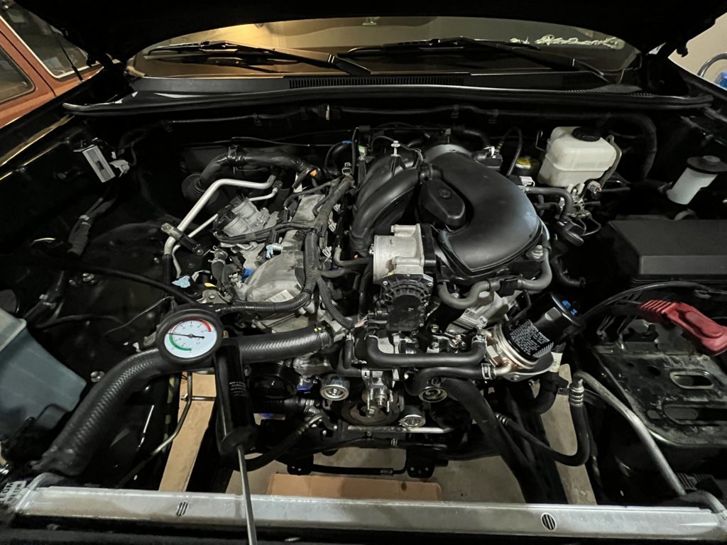

    Just popped my last hose clamp and seemed to pass a dry pressure test @15psi. Looks like the parts list is good to go outside of adjusting numbers for a couple O-rings.

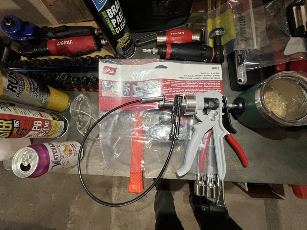

    I gotta say though, I looked around at a variety of hose clamp tools..and while there were a couple I couldn't get to and had to use plier-type tools, this Lisle #17300 is friggin' sweet.
    I was apprehensive about trying these as I had started with their "hose clamp vise" type, which were good in theory and looked really nice - but sadly, poor tolerances and a design flaw meant they would just bind up in the last ~15% of travel; and the the "drive knob" would pop off when you would try to loosen it. If I had been testing in an actual tight spot that could have created a lot of extra work, but I was able to get vise grips on the lead screw and coerced it off with some swearing..
