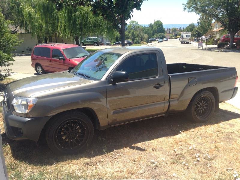

    jofunkinsiah
    jofunkinsiah Member
    Sep 19, 2012
    #87307
    6
    MILPITAS, CALIFORNIA
    Lowered Taco
    HIDS 5k 3k super yellow HID fogs Bench Seat modified to recline the seat xxr 20' staggered 20x8.5 20x10.5 Lowered on djm kit 3/4 with c notch
    This is my 2012 tacoma 2.7 RWD
    Lowered on some xxr 20 " staggered
    20x8.5 front 255-35-20
    20x10.5 rear 265-35-20
    Djm kit 3/4 drop
    Im not staisfied as i do want to go
    about 2-3 more inches front and rear
    Any suggestion as a setup on what to buy
    Or what else i need? Thanks yall!
