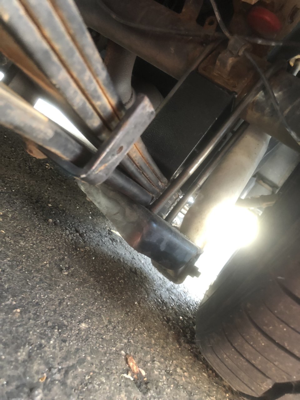

    I know this thread is kind of dead....BUT I just recently installed a 5” lowering block and 4x4 leafs (I’m pretty low) but now my issue is my rear shock mount is about 1” or less from the ground. Has anyone found any way to fix this?? Other then bigger wheel and tire.
