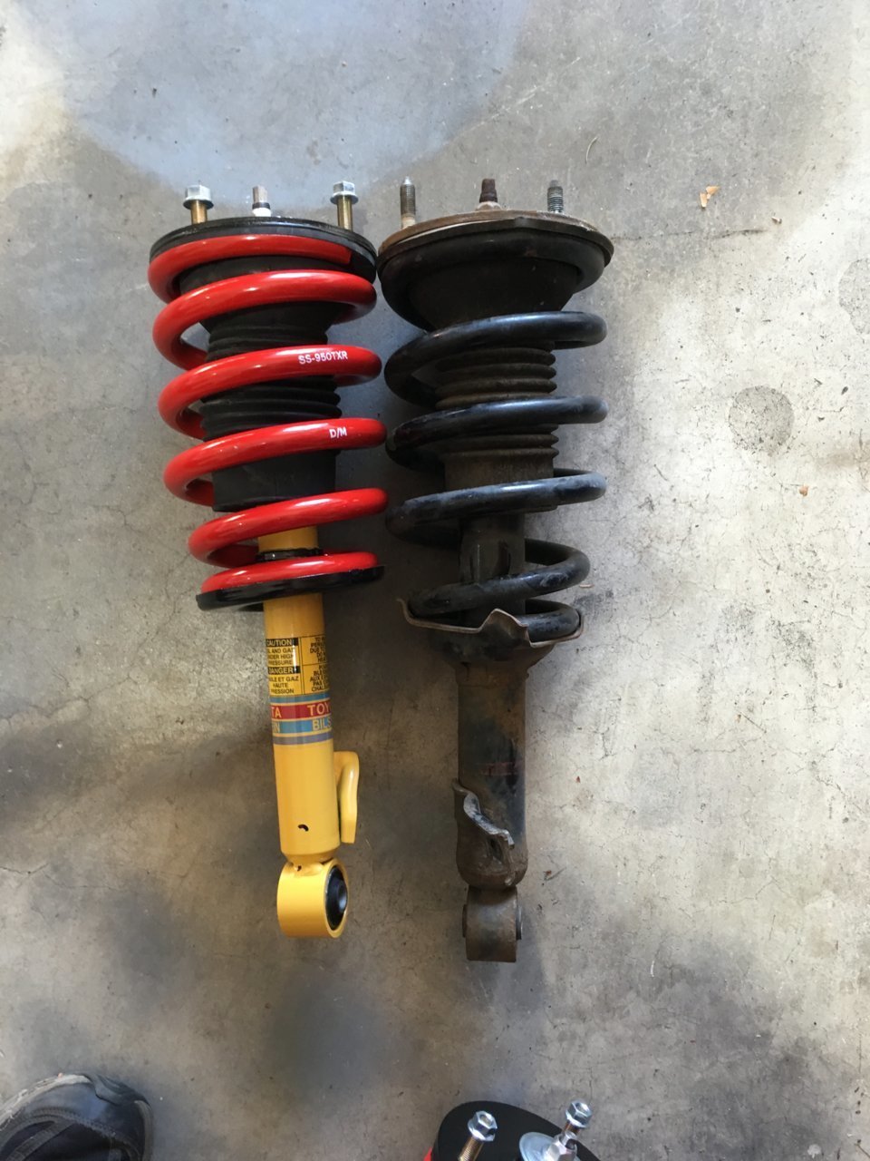

    We have a SR-5 5 lug w/ 2.7L & a stick. I started off with XR springs, XR Bilstein’s & Tundra Racing lowing mounts. It’s was WAY TO F-ing stiff. I then installed the stock springs and the ride hight only came up about a 1/2” but the ride was a lot better! I then went to QA1 coilovers w/ 525# springs. The ride and handling was a step up. I installed new UCA to get the alignment within specs. I then went to Viking coilover’s w/ 500# front springs as they have a shorter front & better length rear shocks for all spring rear drop / 6 lug rear springs w/ 1/2” spacer on the right side & 1/4” spacer on the left side for the Taco Lean. I really don’t think the OEM shocks spring mounts & XR Bils. spring mounts are any different in hight as I check the hight when I removed the stock shocks to install the XR Bils. The lower photo is with 10” springs I have changed to 12” springs.

    You may be right; as I mentioned, I don't have any actual measurements outside of the difference in spring length between the XR and stock base springs. By chance, do you still have the stock strut? I've been chasing down measurements (lower eyelet to spring seat, spring seat to stud end, and overall length) but I haven't been able to get my hands on one to measure nor find someone who has one to measure.
    I do have a picture (not mine, provided to me by Bowers86) that show an XR Bilstein/Xii spring side by side with a stock spring/strut assembly; it's just a picture but there does seem to be a difference between the distance from the spring seat to the top hat. Would be nice to know that actual distance for reference.IMG_3411 (1).jpg

    I don’t have any but I just purchased an bone stock mint condition 07 Regular Cab with 27k miles and a vendor that is coming out with a new supercharger system for the 2.7L asked me if they could use the truck for testing and for demo vehicle to promote their system. They asked me to please don’t change a thing on the truck as they want a bone stock truck‼️ I have already installed cruise, wipers, new OE leather wheel & knob, I’m detailing the engine bay & undercarriage. But after the supercharger system is installed w/ a new header & 2.5” exhaust system w/ a 5x8x14 resonater & 5x11x22 muffler, they will test, video and photograph. Then I can get the truck back. I will install new Viking coilover suspension w/ 6 lug leafs, have notches installed, Gears w/ Truetrac, Two piece StopTech’s, 19” forged Ray’s to clear the brakes, Toyota 86 seats w/ full length Tacoma center console, Snug top bed cover, baby stereo system w/ alarm, tint, super bright driving lights in the OE fog location, color match handles, mirrors, grill, bumpers and other small mods. I have everything but the Truetrac setting in our garage.
    When I remove the stock suspension I can measure. Just because the XR Bils don’t have the shock stroke as the stock shocks do doesn’t mean the ride hight/lower mount is taller/higher. Plus the red springs on the Bils are aftermarket stiffer springs made by Eibach for an out of business vendor. There are spring companies that can make custom springs but they are not cheap to have made! Plus if you have a spring rate that is too stiff for the valving of a shock you will kill the shock. Remember the max ride hight drop that’s more than 1.5” to 1.75” lower than the stock ride or about.25 to .5” lower than the stock XR ride hight the alignment will be out of specs!
