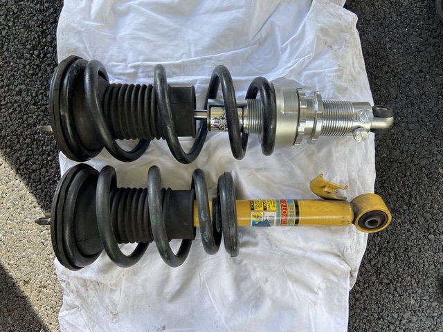

    You can run the XR Bilsteins and the stock springs as they can fit. However, whether they are a good match is a different question, and the answer depends on who you ask - lots of guys run that combo and are more than satisfied with it.
    I personally don’t think they are a good match since the stock spring has to be compressed more than 2” to fit in the XR bilstein, which I feel forces the shock to function outside it’s working range, so the shock doesn’t dampen the spring as it should and/or the spring over extends the shock. For me the ride was really bouncy and unpredictable, and the truck would jerk hard left or right if I hit a pothole at freeway speed (50mph+). Pic shows the matching stock springs mounted on the bilstein vs on a longer shock (no preload on the spring) to give you an idea of how much you’ll need to compress them to fit:
    For a time I changed back to the XR springs on the XR shocks and while the ride was rough, it was more predictable and did feel like a safer combo. The XR spring/shock combo ran about an inch lower than the XR shock/stock spring combo.

    Oh, the silver shock setup above is the way to go!

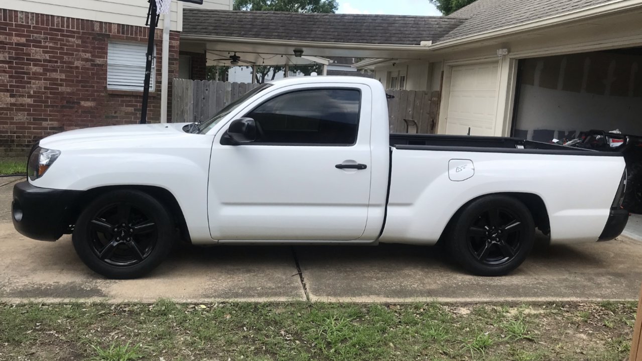

    Is there any way to get a 4.5 inch drop block

    7F33F7B3-882D-413D-9DD5-EFDA6D59E113.jpg How low it will be once I do the 3.5/4.5 drop

    If that clean looking truck was mine (my fav color is white) *I* would raise the back up an inch to get the noise down look. Plus it would handle & ride better. But that’s just me…

    It’s not squatted at all just the angle of the pic
