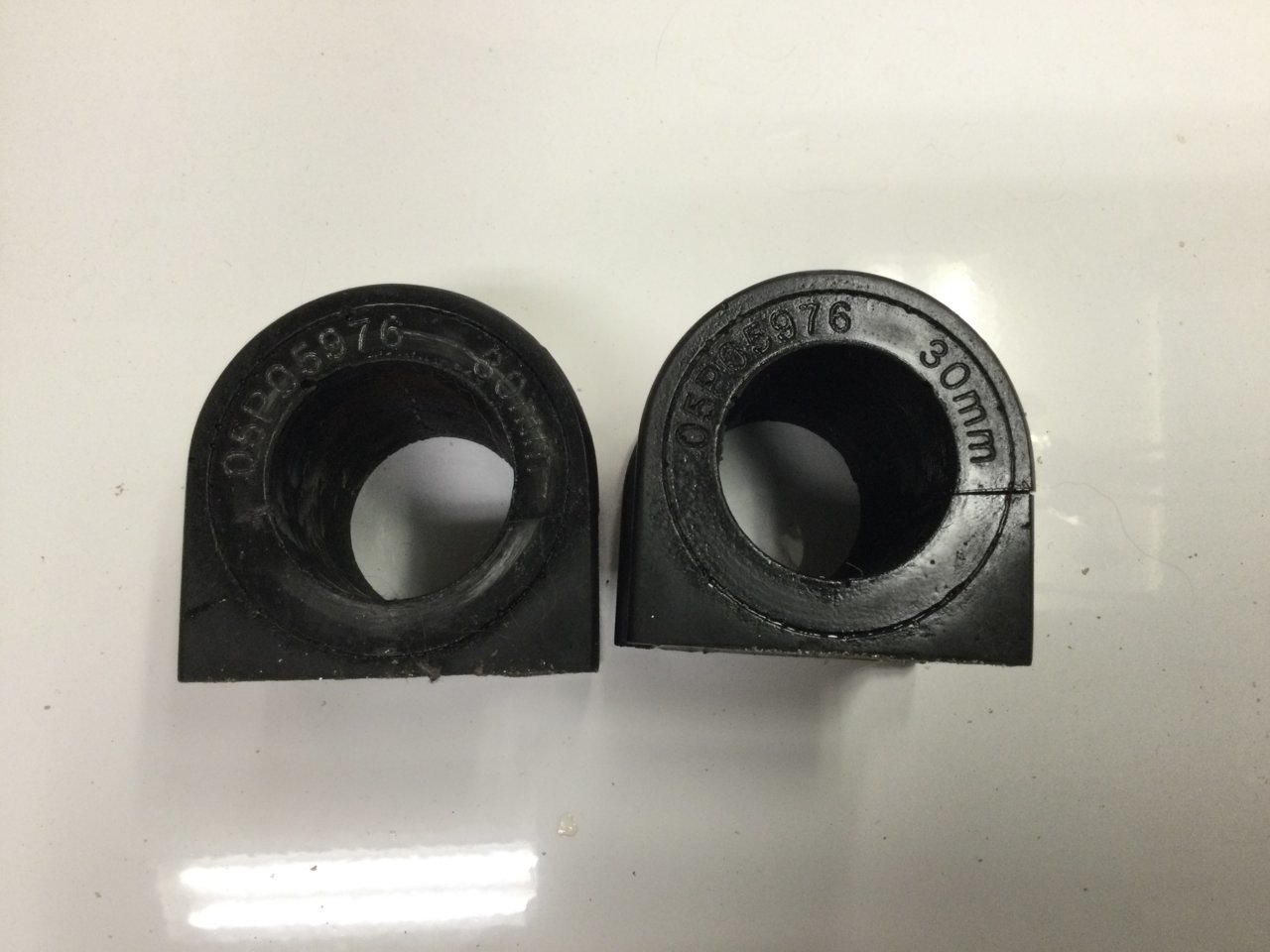

    To my 5 lug buddies, I have a set of 30mm Energy Suspension black polly sway-bar bracket bushings.
    The bushings are Gone…

    Is that the same size diameter as the X-Runner rear sway bar? I'm assuming it's for a rear sway bar?

    Sorry but the polly bushings are for the OE 5 lug front swaybar’s. From what I understand they are the same as the X-runner OE front bar.

    If you're pretty sure they will fit a stock '14 5 lug four cylinder front swaybar, for $5 I'll take them. Please DM me your Paypal email and I'll send you the $$ and reply with my mailing address. Thanks!

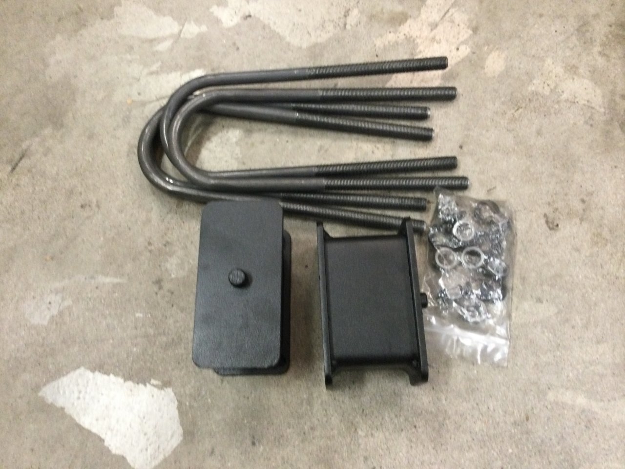

    More parts for my 5 lug buddies. I ordered rear notch’s from DJM and told them to keep the rear U-Bolts & Blocks but they sent them. So $1 ($1 should cover the gas to drop off & PP fee) plus shipping from 85203 w/ Priority Flat Rate medium box. You can check the rate or find another way UPS / FedEx or ?… Or if you can pick up Or Tacoma Express… Free.99
    https://www.usps.com/ship/priority-mail.htm
    *Edit*
    Gone to mtb_taco Thanks sir‼️

    I can use the blocks and u-bolts.

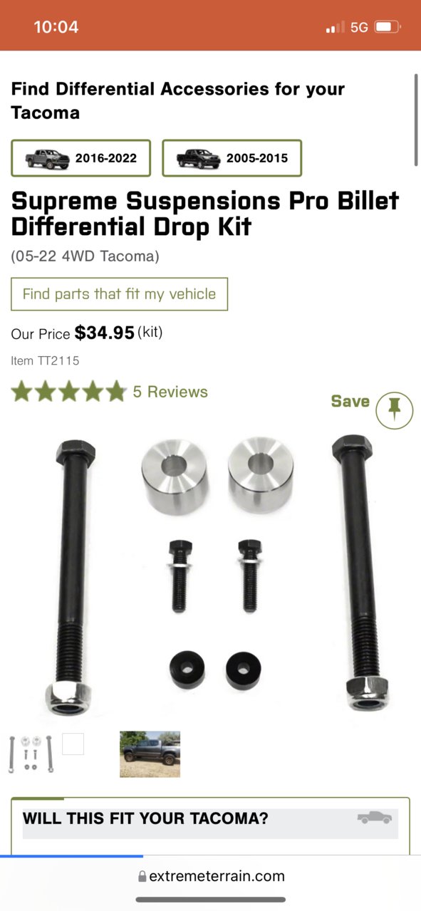

    2A3AD5AF-D5C5-4440-B874-C8E322FD9AF2.jpg Can this work at a spindle drop spacer

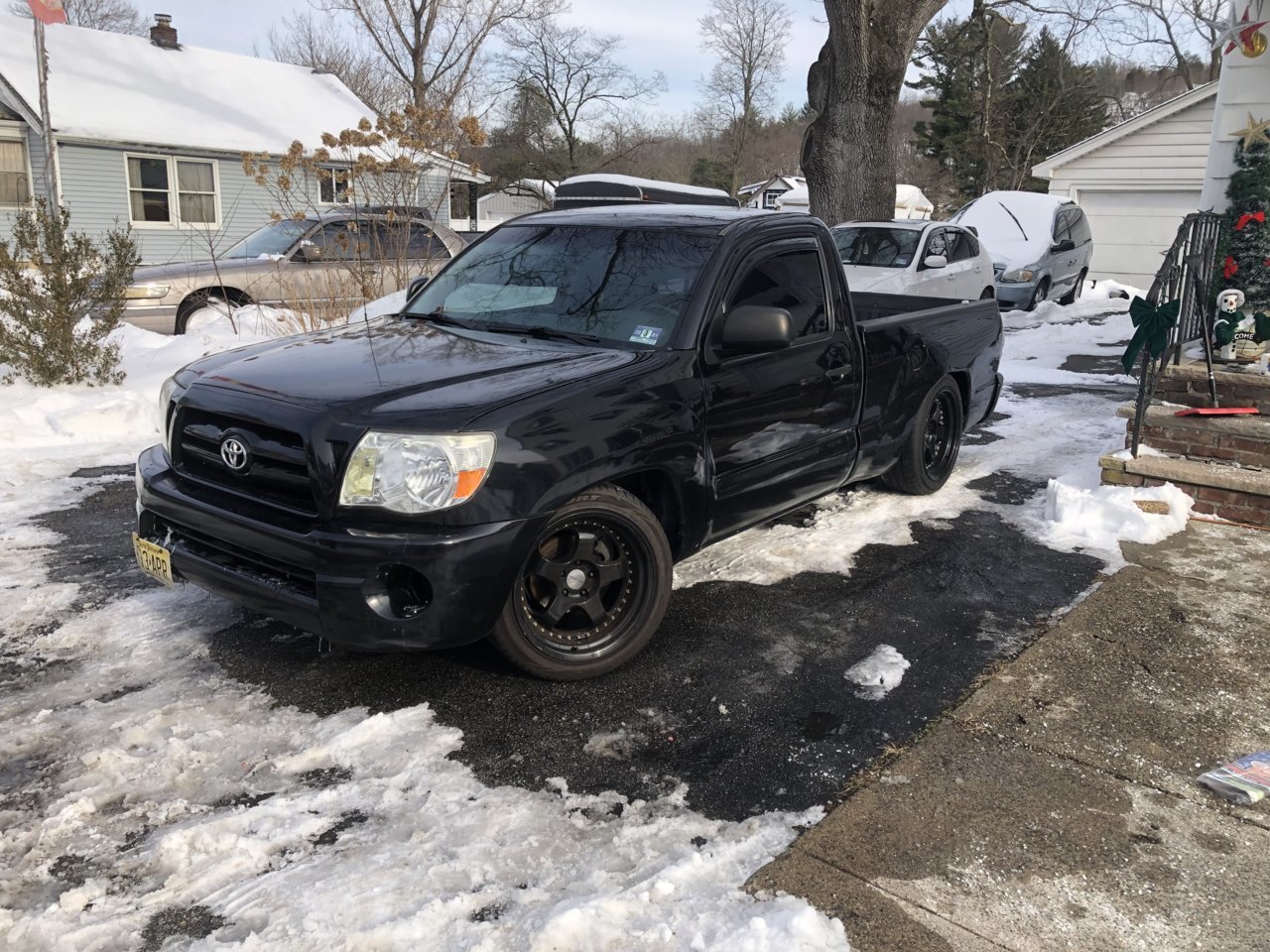

    You'll be looking at about 5.5 inches of total drop in the rear. Should look fairly similar to this. This was on a 5 inch block.
