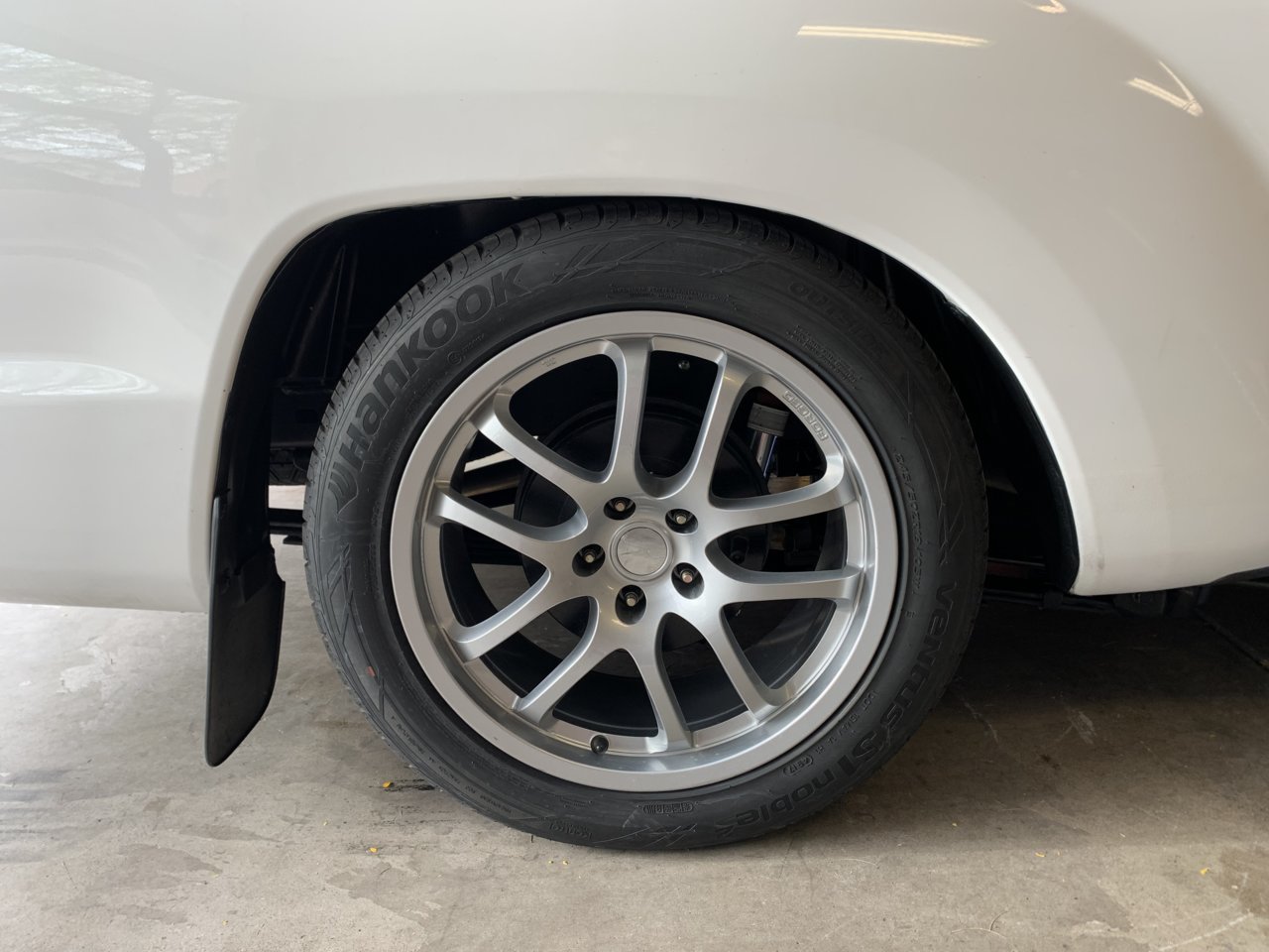

    DJM 3/4 drop 1" lower Ball joint spacers Blitz Z1-18x8.5 235/40 & 18x9.5 255/40
    Yes I have a DJM notch

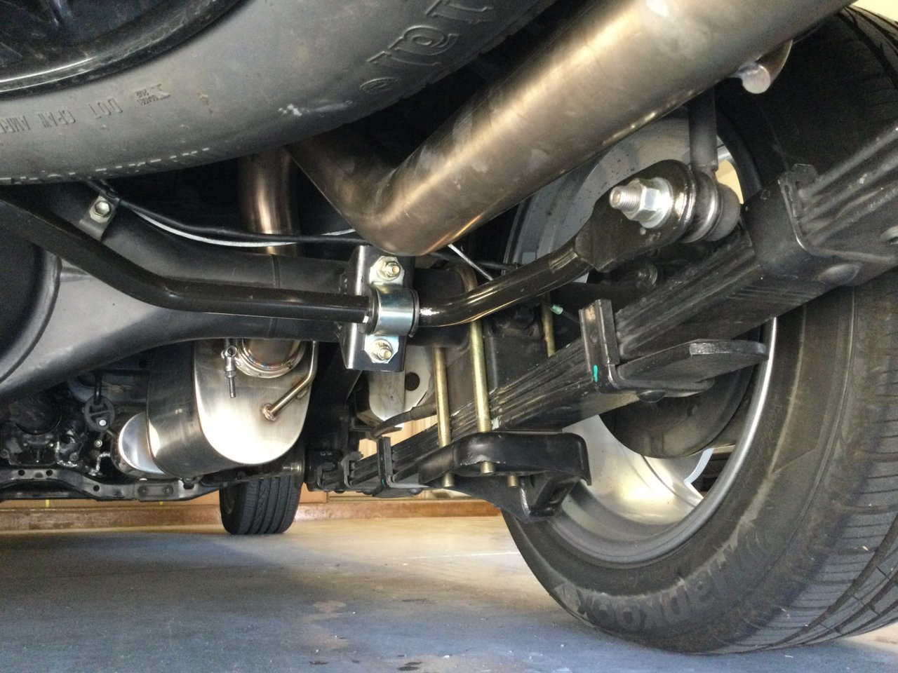

    I dropped mine about 3.25”. About 1.25 with six lug leafs and a 2” block on the right side and a 1.75” block on the left side. (Taco lean) But I have read of others having issues with the drive line rubbing on the parking brake cables. My drive line lightly rubbed against the left side cable all the way from AZ to TX when I had the truck loaded with the LS and all the parts for the swap I’m getting done.

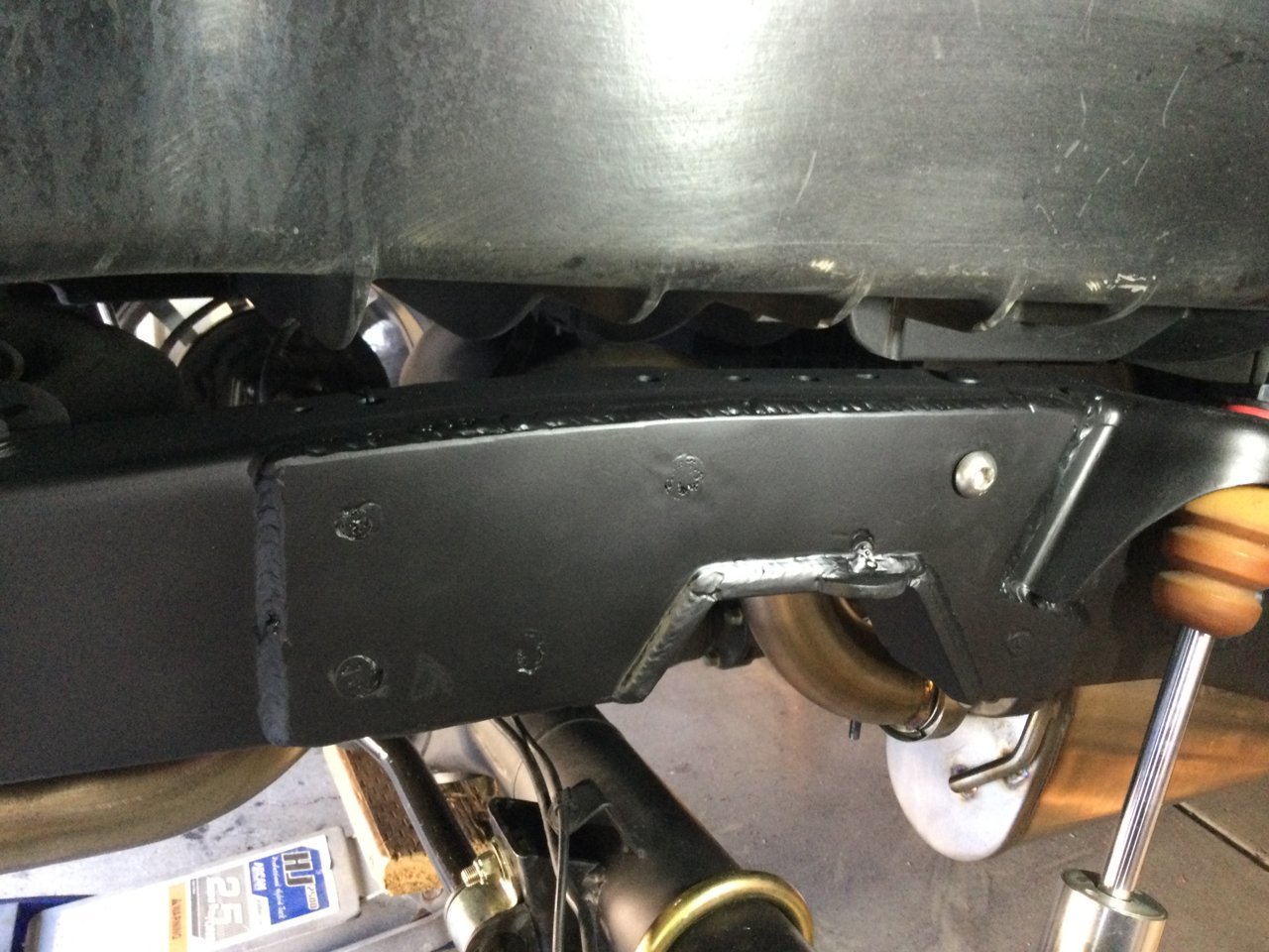

    Just an FYI, Over stiff springs will make the truck understeer more. I also have two sets of New Viking springs still in the box’s. A set of 12x2.5” 500# springs and a set of 450# springs if you’re interested? I never got time to try them in the truck. If you’re going to do the coil-overs look into 6 lug leafs w/ a rear X-runner rear sway-bar and weld in a notch! Makes a big difference, again just my .02 cents. Oh, any more drop than 1.75” from stock you’re going to have alignment issues unless you install new aftermarket UCA’s. Been there done that…

    I won't be using the coil overs for much, if any, drop. I'll be running the DJM 3/4 drop kit and welding the rear notch in after setting the coil overs up. Eventually I'll be doing a parallel 4-link in the rear with cantilevered coil overs along the frame rail, but that'll take more time in the shop than I have right now.
