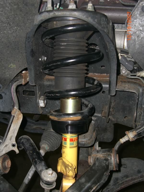

    correct if I am misunderstanding this-
    the black rubber piece below the spring, that is effectively a new coil seat that sits lower, allowing the standard coil to drop lower over the coilover compared to the standard position. is that right? this is as simple to fit as diassembling the coilover and dropping this new seat in under the spring, right?
  8. Apr 7, 2013 at 12:40 AM
    #28
    Brendo Ballz808

    Well what is pictured is basically an Xrunner strut assembly
    I believe Tundra Racing makes a lowering kit for the strut which does exactly what you are stating
    you replace the stick rubber sleeve under the spring with the Tundra Racing one thus lowering the truck
    If you are running XII coils on your truck now and add spacers you are for sure gonna have to align it and iso how far it will be off but it is very possible I hope this sorta helps though
    No worries I had a hard ass time finding people who dropped there 2nd gen tacos not many online with knowledge to help but this thread is very excellent helped me out a lot

    sorry for the newb questions...like I said, I come from a backrground of lifted suspensions so am flipping my understanding the other way.
    1) If I fitted 2" lowered struts would that be fine with clearance/alignment with the factory UCA's?
    2) If I were to drop it to 3" after that via the spindle spacer would the factory arms and alignment still be able to get within spec?
    I wouldnt be lowering more than that. I want performance not just looks.
    3) I see the DJM upper and lower arms are built to space everythign 3" higher. I understand that but are they really necessary if not going more than 3"?
    4) Is it for drops bigger than 3" or for alignment at 3" and lower?
    I appreciate your patience, if I am in the incorrect thread please move this to the correct one.
  10. Apr 7, 2013 at 1:18 AM
    #30
    Brendo Ballz808
    Brendo Ballz808 Slammed or lifted.. ANYTHING IS BETTER THAN STOCK
    Feb 19, 2013
    #97896
    1,302
    BRENDEN
    Oahu
    SNOFLAKE
    Check out my build:)
    No worries
    1.) Previous to my drop I was running just the XII Performance drop coils and never aligned it and the alignment wasn't to bad but definitely alignable back to spec and yes its totally okay to run with all factory parts
    2.) If you decide to run a spacer combined with the coil to achieve 3" drop in the front you will really need to align it and I would assume you should be able to get it within spec however it might max out but Im not totally sure its should be fixable but don't take my word for it
    3.) The DJM kit is meant for a 3" drop for the front it isn't meant to be combined with other drop components however it is possible the control arms will keep everything within spec and allow you to drop more and align it if you choose too changing the control arms to raise everything keeps everything like stock with being 3 inch lower
    4.) In my honest opinion I say grab some XII performance stock height coils for a stiffer spring rate along with Xrunner struts and the DJM UCA and LCA for a very alignable performance drop
    The cheaper way would be to use the spindle spacers combined with the XII performance drop coil however idk how bad the alignment would be
    I am currently running XII Performance drop coils combined with DJM UCA and LCA and I maxed my camber at -1.5 which isn't too bad for the height but you catch my drift its too low to bring back to 0

    Thankyou for the clarification. I understand now. Both DJM arms allow you to sit 3" lower on the front with standard struts.
    therefore I would need a standard height "performance" orientated strut to replace with.
    I like this option.
    thankyou.
