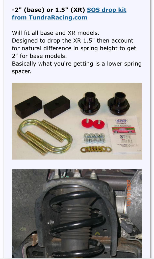

    Perhaps this lowering kit is buried somewhere in the 22 pages of this post, but it looks like there still is a more mild lowering kit available for 2wd Tacomas that resembles the "OS drop kit from TundraRacing.com kit"...
    https://www.lceperformance.com/2005-2015-Tacoma-2x4-XRunner-Lowering-Kit-1-5-F-p/2070030.htm
    Anyone have this kit? I browsed a few pages into this thread and didn't see any reference to it.

    It more than resembles the SOS kit, it is that kit. Being that it is no longer available on the SOS site they may not be able to get it but you can call them and see.

    The kit is the SOS kit! LCE is now selling SOS/Tundra Racing parts.
    And I’m using the kit less the silver steel sleeves. But I use Viking shocks, they are aluminum shock body’s so I don’t recommend for owners in the rust belt. Plus you need to use gobs of anti-seize on the treads even in AZ.
