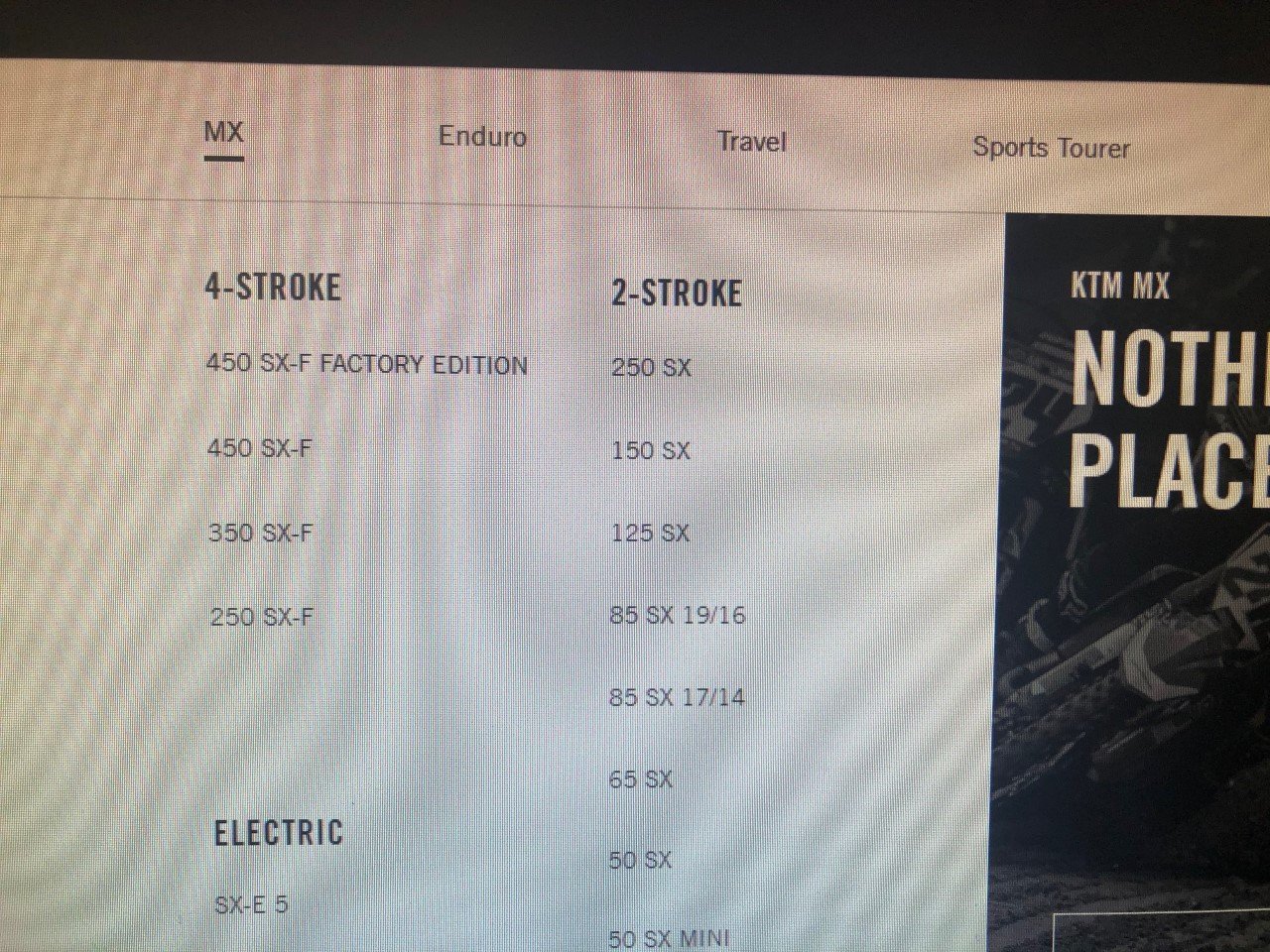

    I love 2 strokes, but I'm old. I've heard the emission problems have been solved with new fuel injected models. In CA they red sticker 2 strokes made after... 2002 I think. I wonder, though, if the factories would be interested in a true 2 stroke resurgence? There is more money to be made in 4 strokes between increased service intervals and parts. In the end it's usually money, but with dirt bikes it's also about racing and winning, so maybe...?
