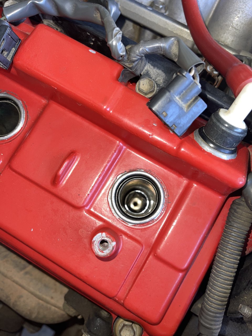

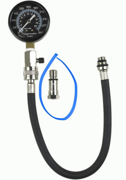

    So there I was. Trying to turn the compression test hose onto the spark plug threads. I didn’t get it nearly on there enough cus when I turned the engine over the whole hose popped off. Then I realized I could just wrench the extension in that comes with the kit and then thread the rest of the hose by hand. Easy enough right? The extension used a 17mm socket. At some point I think I believed it was on there enough so I tried pulling it out but the socket stayed in there and it’s already a pretty tight fit. I tried just taking everything out and I’m pretty sure I just cross threaded the shit out of it… Idk how I cross threaded it trying to REMOVE it. I usually never make these kinda mistakes. I work on this truck all the time so I’m pretty frustrated about it. I’ve already spent two days just trying to do the damn compression test but my lack of tools and time have been stalling me.
    So now the compression test extension is stuck in there with the 17mm socket on it. ISO tips n tricks to remove it. This is my DD and I go back to work Thursday.
    And if it is cross threaded, what’s the worst case? Getting the spark plug hole re-threaded? I’m sure that’ll be cheap..

    Have you got a picture of what’s going on? I recently did the test and had a cross threaded spark plug. https://www.tacomaworld.com/threads/yellow-gunk-in-spark-plug-well.767574/#post-27409869
    I just eased it back and forth a 1/8th turn at a time till I got it out to minimize the damage, then ran a thread chaser through to (straighten?) and clean out the threads. Ended up being fine in the end. But if you obliterate them I would think a Heli coil would fix it. Or whatever brand they have at the local parts store.

    I’m still slightly confused as to what is on what. Compression tester fitting stuck in thread, hose popped off, socket stuck on fitting? Can’t get a socket extension down there?

    This guy is stuck in there with a 17mm on it. Cross threaded. That’s it.

    Do you have a magnet? A strong one might do it.
    Can you get a picture with it focused on the thing in the hole instead of the outsode of the hole? Might generate some more ideas.

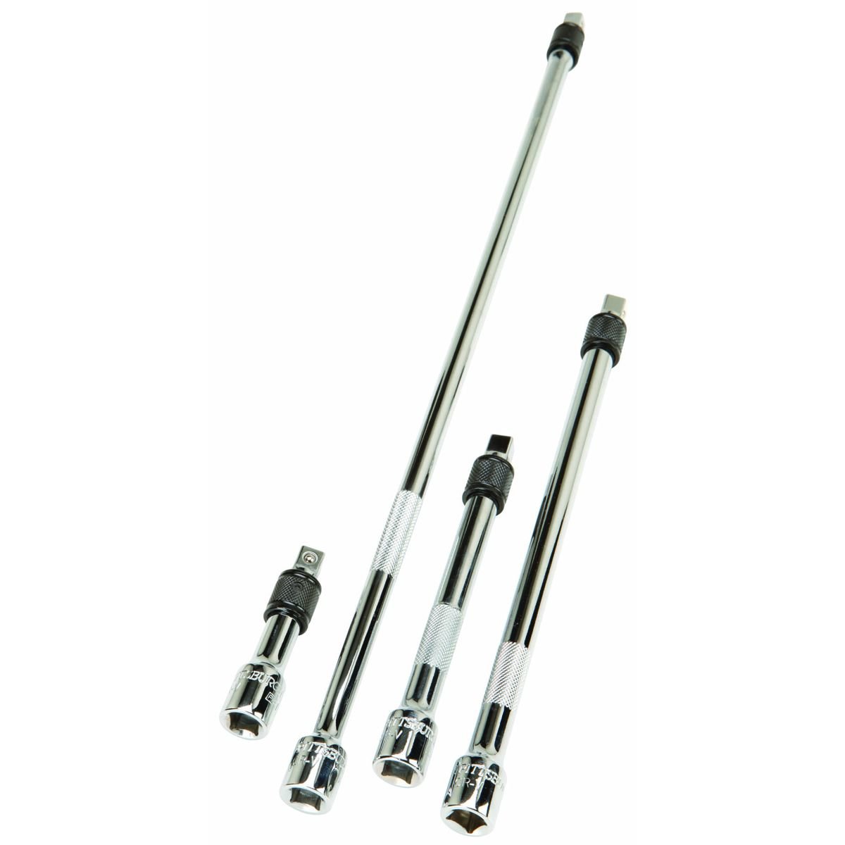

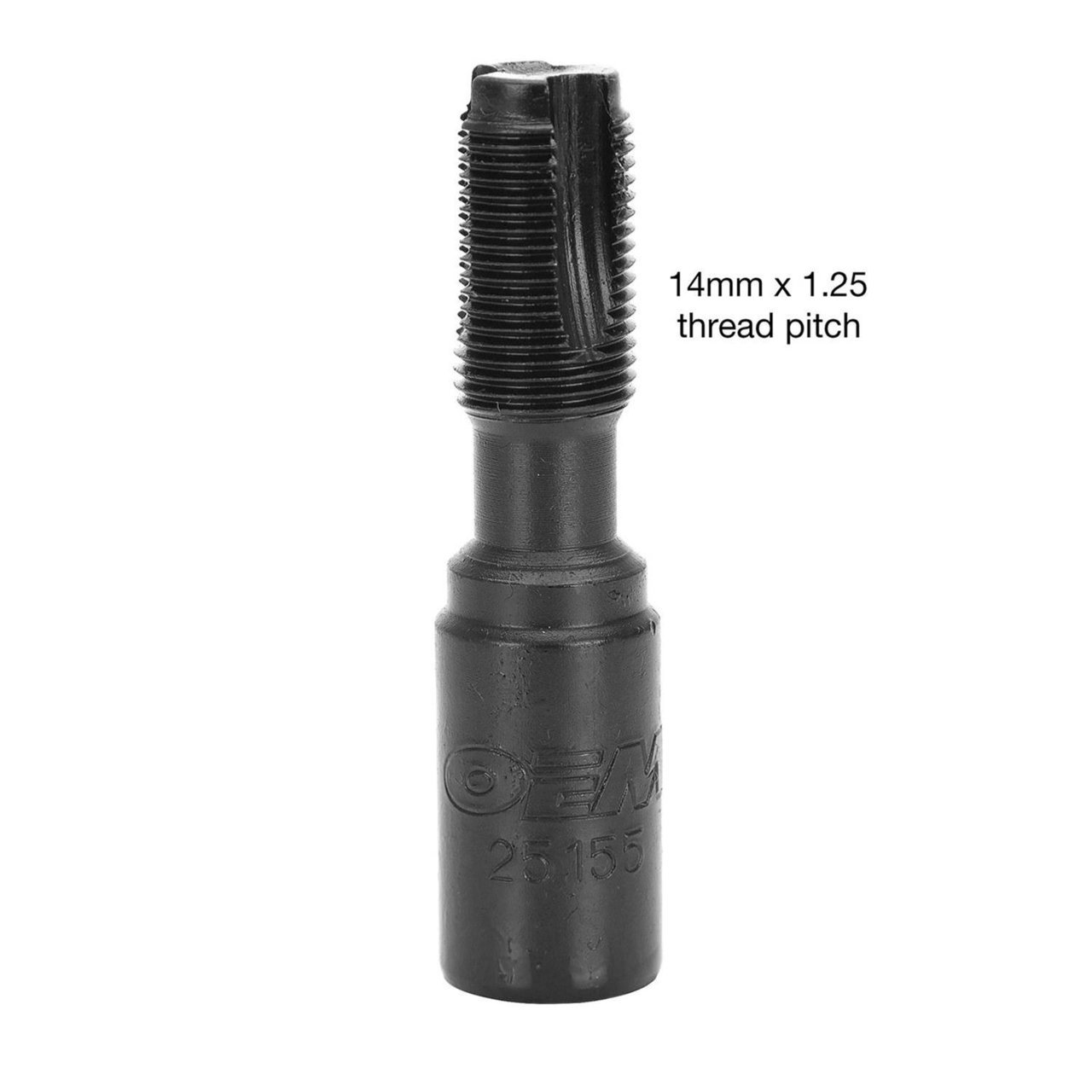

    The 14mm thread chaser they sell everywhere.....different brands......
    .....parts store got one in for me next day....
    Logans2001[OP] likes this.
