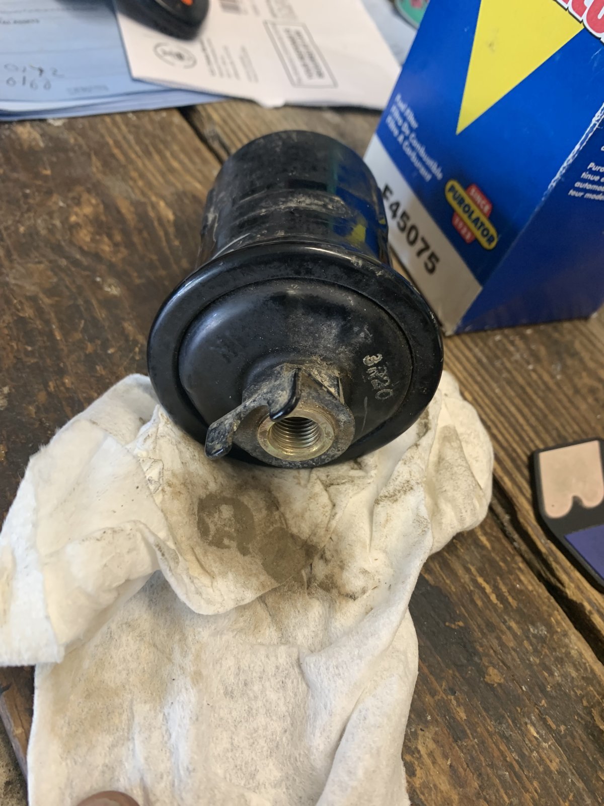

    Always a good idea! Usually the valve cover is weeping anyway so even if your in spec your fixing something! I had similar issues with my 2.7 and did new filter and injectors and it seemed to help. Getting that filter out was super fun though.

    ^^^^^right!
    Top sides of my hands were swollen from contorting to get to FF
    good results after installing
    Pretty sure original
    Yuck
