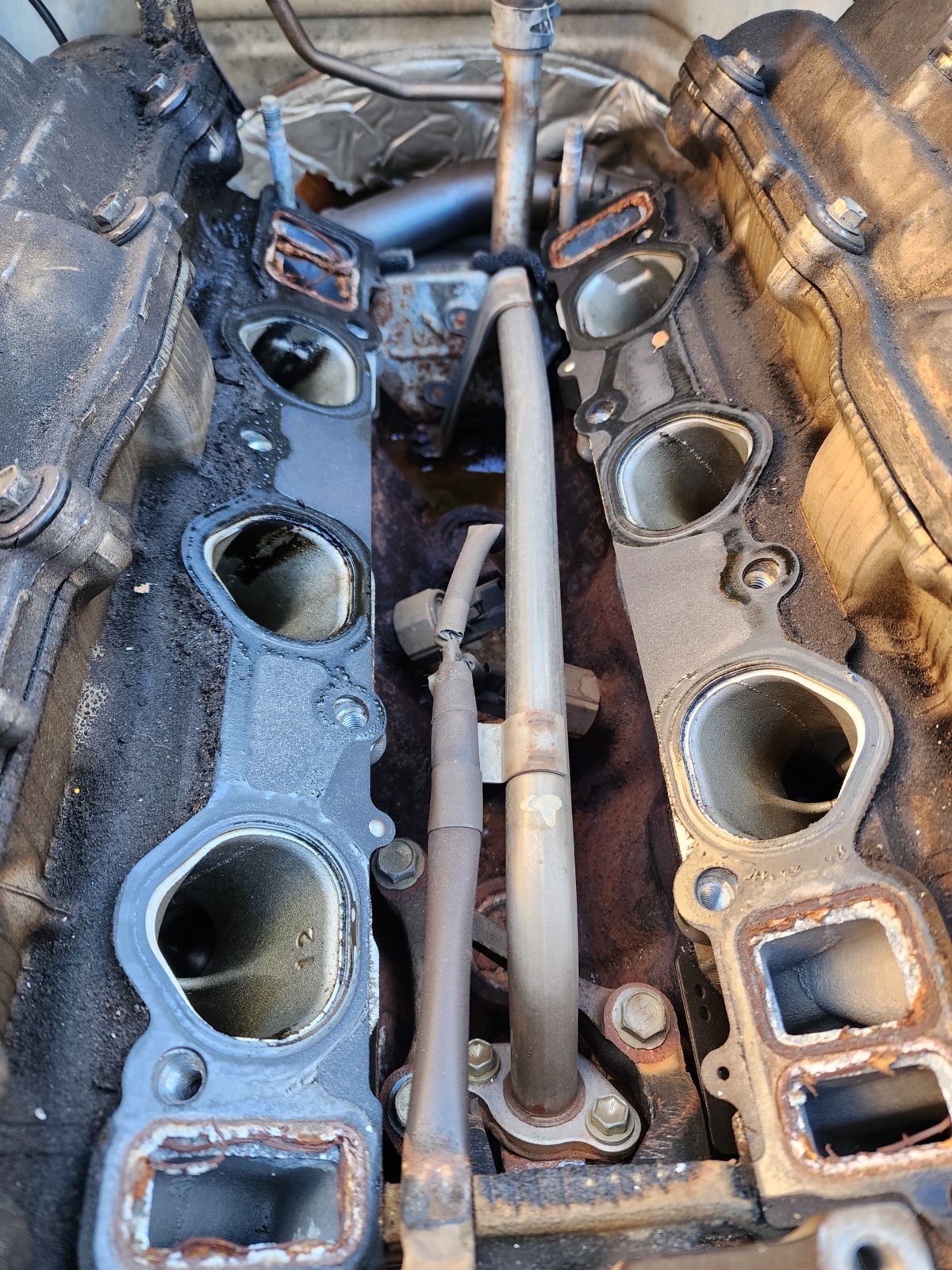

    Good morning all,
    OP, read all your posts and symptoms your having and it all was exact same as my '02 had. I kept driving it till I began to lose a lot of power and knew something was definitely wrong. I had no other choice but to buy my new to me '18 Tundra and let my Taco become my project truck. I'm not a master mechanic but I know how to watch and follow videos and Tims 7pt YT videos are gold. Having the right tools and endless amount of time are key.
    I'm S/C'd with 130k on my engine. I abused and drove my truck like I stole it. I've kind of been documenting the entire job on my IG but here are a few pictures I've snapped along the course. I'm definitely taking my time and also using this job to replace LOTS of other parts and components with upgrades or just parts that have been overdue for changing; oh and CLEANING!. My situation ended up being a crack in #3, pulled the heads off and found a pool of coolant in cyl3. I'm going to go with Yota1 for my rebuilt replacement. I don't think one can go wrong with Yota1. I'm also considering my transmission as well but we'll see, maybe later down the road. And now for a few of many many pictures... Good luck btw! As one member said, it definitely is a really fun project to DIY! Just have fun with it and pace yourself..20240106_155409.jpg IMG_20240129_190515_259.jpg IMG_20240202_191005_383.jpg IMG_20240203_104050_179.jpg 20240205_193809.jpg 20240205_194147.jpg 20240211_080235.jpg IMG_20240218_160754_998.jpg IMG_20240225_184919_964.jpg IMG_20240225_184920_079.jpg
    I'm attached to my truck, I'm the original owner so putting only the best into it to me is my only option.

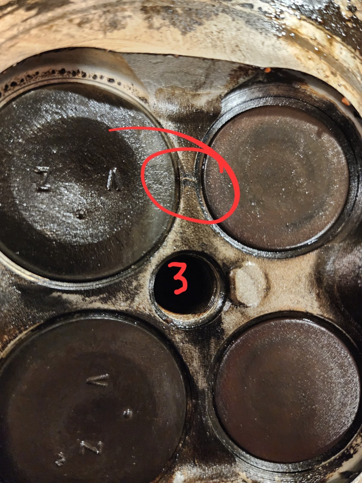

    Just curious, maybe I misunderstood you, but why is it that you think the crack between the intake and exhaust valve introduced coolant to the cylinder? I had at least a dozen cracks combined between both heads but no coolant in the cylinders.

    My crack is in the same location, even down to the same cylinder and it seems to be what is introducing coolant into my cylinder.
    While I have no idea the internal design of the head, and admittedly limited general knowledge of engines, I would think there is a coolant passage inside the head on the other side of the crack? Maybe some cracks just don't reach all the way to the passage, or only allow such a small amount of coolant through you just don't notice.
    In one of Timmys videos, the machinist he was working said he commonly sees cracks in these 5vz heads. I think they found a crack in nearly every cylinder, but not all of them were big enough to cause any leakage.
    He starts talking about it at 13 minutes into part 4 of the head gasket repair video.

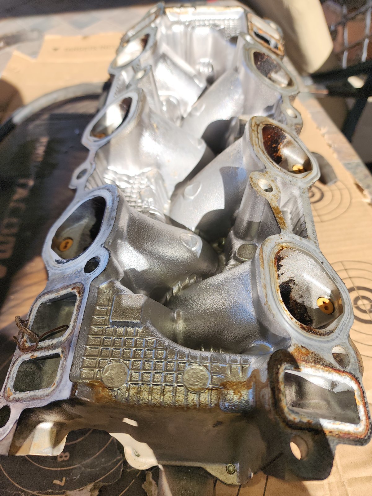

    I'm not 100% certain it was the crack but when taking the intake manifold off, you can see there was coolant below. I believe it was the gasket that led to coolant seeping through under the manifold and possibly into 3&5 :confused: Not necessarily the crack itself may have led to the cause of coolant in the cylinder but that was something that I had noticed upon closer inspection and rather than put cracked heads back in, I'd feel better having them looked at by the pros at Yota1. This is my first time dissasembling an engine so I'm learning as much as I can along the way.

    That's why I asked, I didn't know if it is known that a coolant passage runs in that area, or if it was just an assumption. At around the 18 minute point, he does show the crack with valve removed and the staining indicating coolant intrusion. Good to know.
