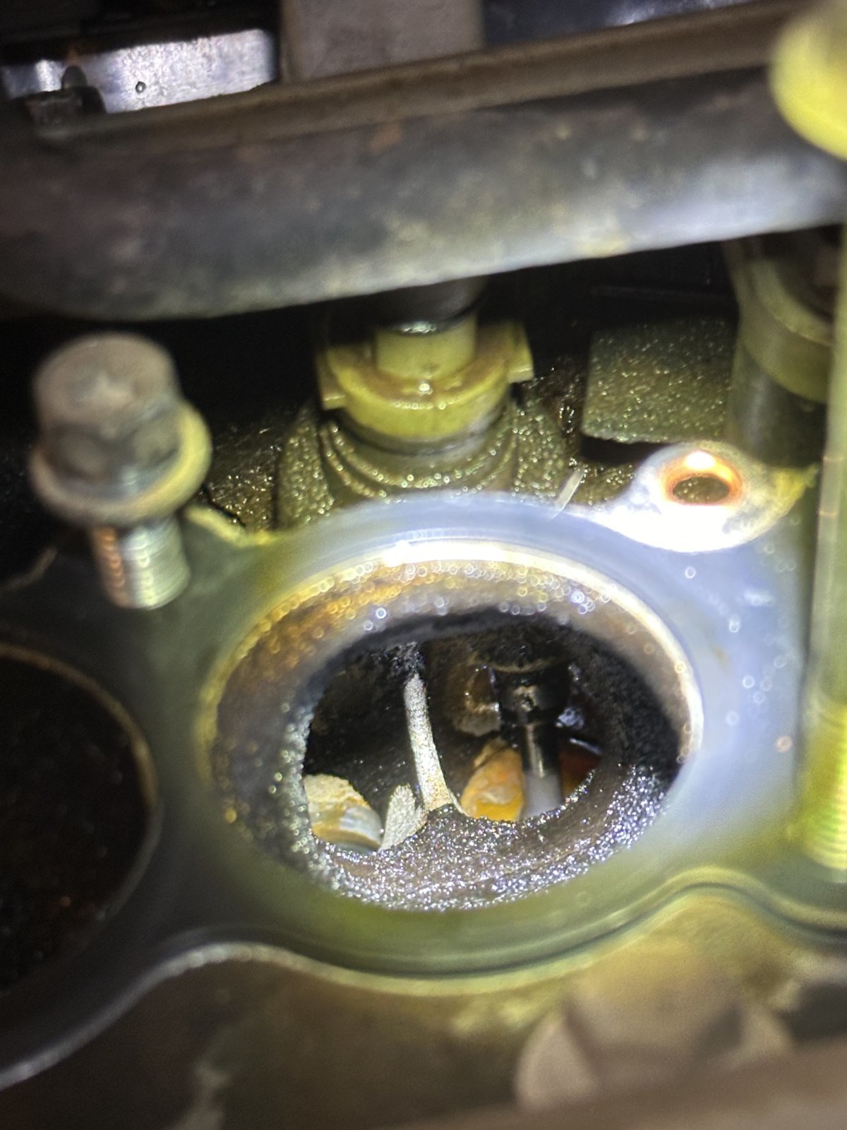

    So I figured I’d start tearing down the top end, maybe find a reason to go one way or the other..
    I noticed there’s a lot of moisture in the intake plenum and manifold. Seems mostly normal from what I can find, oil from the Pcv.
    I also took a look down the intake manifold into the problem cylinder, 3, and saw there’s a pool on top of one of the intake valves. Not really something I expected to seeIMG_4992.jpg
    That orange is a pool of gunk/coolant
