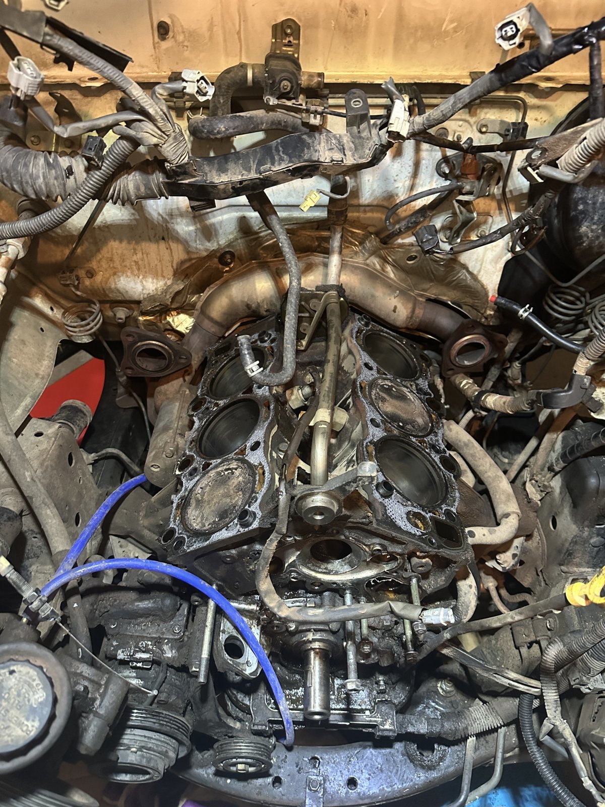

    Heads are off!
    Those head bolts were a killer..
    Lot of gasket material on the block, I can’t see how a bunch of that isn’t going to fall down the coolant passages while cleaning the gasket surface, is there anyway to get stuff out of them other than a good coolant flush after putting the truck back together?
  3. Mar 8, 2024 at 7:24 PM
    #83
    ControlCar
    ControlCar My Moto: Help & Learn…period.
    Jul 22, 2023
    #429578
    3,603
    Steven
    Sugar Land TX
    1996 Taco 2.4L 2wd Automatic
    Clock Volt meter/LSPV Delete/Hyundai 16’s/FP gauge/after 9months of wrenching ZERO oil leaks
    Wow
    Really good pix….never seen V6 with heads off
    623
    Not that this is correct method to answer your question about crap down coolant jackets…..
    But I would do this
    Cut a Brillo pad to size and stuff it into the coolant passages
    Scrape off head
    Then can remove the seated Brillo with needle nose pliers afterwards
    To be sure/safe
    Maybe when pulling pads out….have shop vac in one hand/pliers in other hand
    I’m sure another member has encountered same issue and probably has better method thou
    Great progress!!!!!!!
