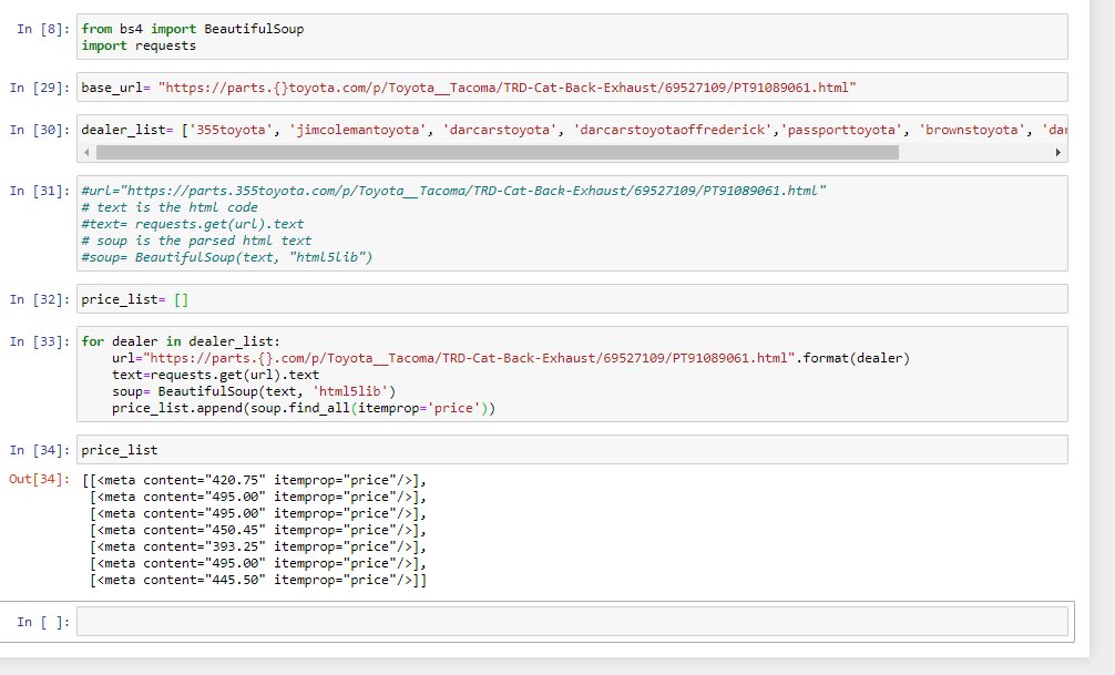

    I have noticed when shopping for parts online at Toyota dealers, the prices of the parts can swing wildly from dealer to dealer and there's no easy way to comparison shop without visiting each dealer's website which simply isn't practical.
    I have also noticed that each dealer's website for any part has basically the same URL, the only difference being the dealer's name in the URL. I made a very simple python script to scrape the sites of a few local dealers and return the prices of the TRD cat-back exhaust by looping through a list of dealer names and replacing the name in a base URL as necessary.
    I am not a computer programmer but I have been learning python during quarantine so I have some basic knowledge. I am sure an actual programmer could make an awesome application to check prices of all dealers in the nation if you simply input a part number.
    Below is a screen shot of my basic script. As you can see the price of the cat-back can swing from $495 to $393 depending on the dealer. Basically I just hope to inspire someone who knows what they're doing to help TW members find the best dealer pricing for parts.

    Bro you wrote a python script in Jupyter Notebook or Lab to scrape a website for prices. Yes, your are a programmer. Keep up the learning it could pay off way more than saving some bucks on an exhaust.
    Your idea reminds me of something an old college friend tried to get me to help him with 20 years ago. Except it was for used textbooks. Then a few years ago a colleague wrote something similar except it would game those old penny bid sites.
    I like your idea. Can you post the script on Github in a repo or as a gist?

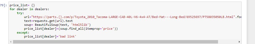

    Also it helps to put the scrape in a try/except block because times the dealer doesn't have the part, etc.
