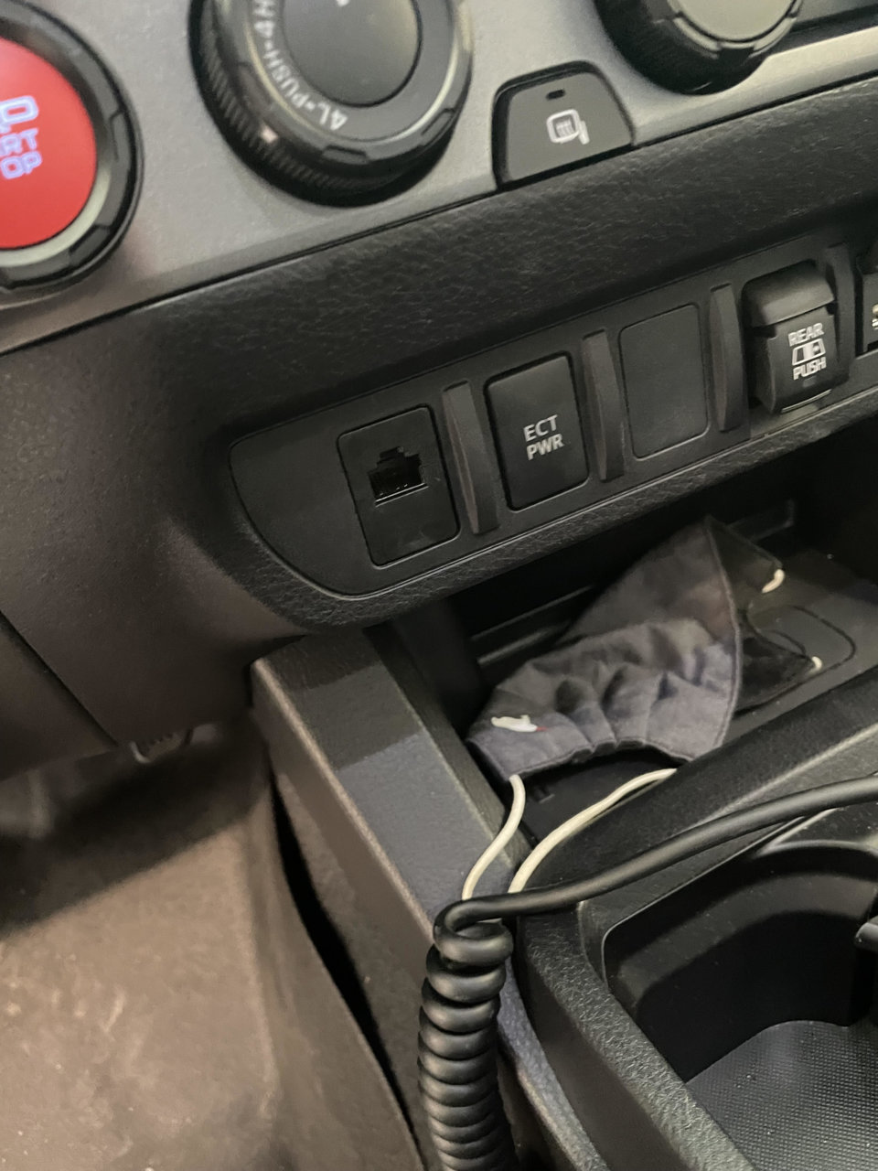

    I have a Midland gmrs radio under my passenger seat. I ran the antenna up to the ditch light bracket and installed an RJ45 port in the lower switch panel. Its completely out of sight when not in use.

    Nice! Do you have a link to that RJ45 port? I like that set up, very clean.

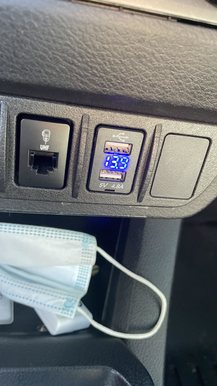

    I actually had one of these before I got the other one and it was garbage. The fit in the switch hole was awful, so bad that it would rattle when driving down the road. The rj45 port fit was awful as well, and the back half of it separated with any force whatsoever and would dangle by the wires. Look at the picture below of when I had it installed, you can actually see it angled to the driver side.

    I’m glad you chimed in because that’s the same product I had linked earlier but didn’t have any experience with it or know anyone who had. So safe to say that’s not a great option.

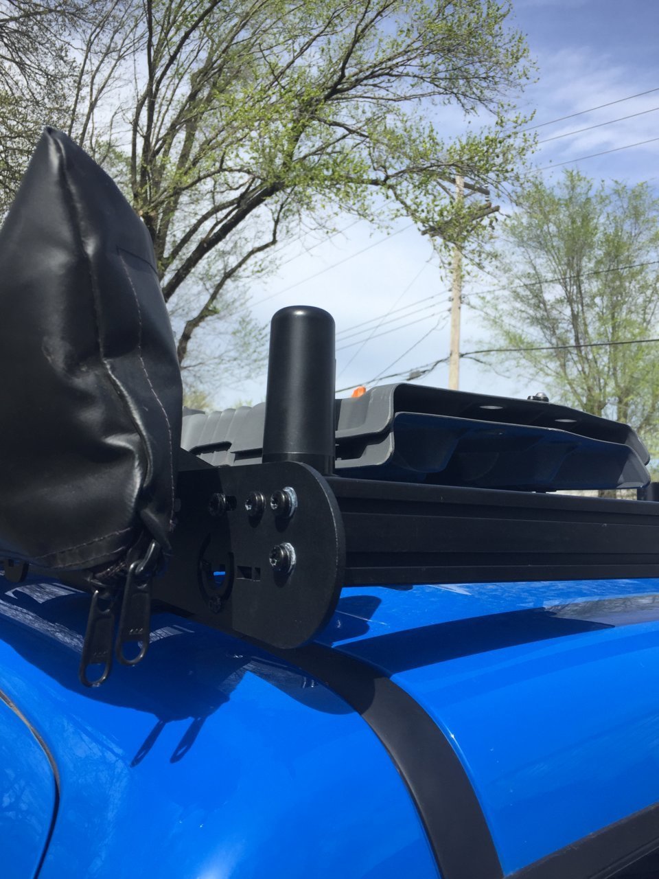

    I only did a cursory glance over this thread- but thought Id throw this idea out there. I never really liked the ditch light antenna position. I ended up riggings the Ghost Antenna to my Prinsu rack using a universal Midland mount and 2 existing holes in the side bars of my rack.
    Just tossing out there for an idea.
