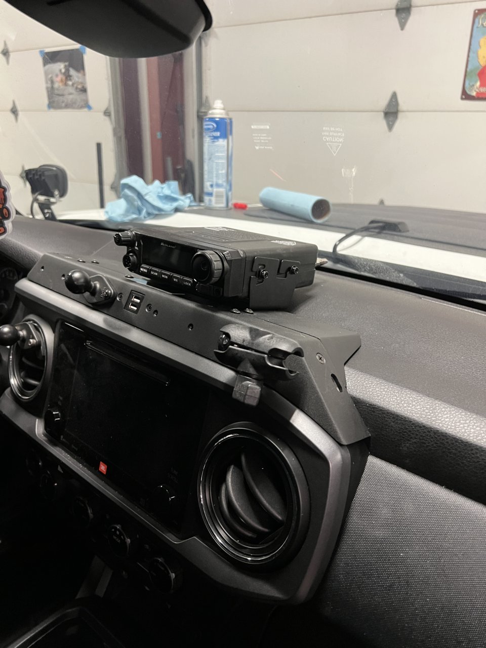

    Trying to find a spot for this MXT500 is kinda a PITA I have that TPAM mount and debating doing that. My only issue is idk where to route the wires from the top of the dash to engine bay? Any ideas

    411

    Simple and clean but that install creates huge blind spots for the antenna that will significantly reduce transmit and receive range in those directions.

    I ended up mounting it on my TPAM and routing the wires through the dash

    If I go for the MXT400 I'd run it just like this.

    The dash seems to be the only real place for this model. And I don't have any TPAM thing which looks slick.
