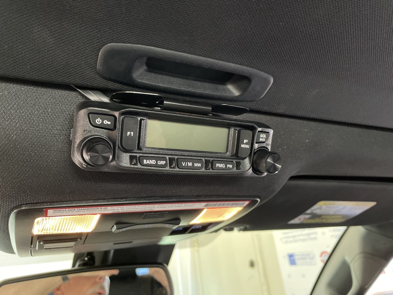

    I can't bring myself to drilling visible holes into my trucks interior so here is how I mounted my Yaesu FTM-6000 face plate. I still need to clean up the bracket and give it a shot of paint but you get the idea.
    66690812405__5F4A8880-0750-45BB-87CA-7B681344678D.jpg 66690815995__75B0273F-9115-4E1F-B4D5-A213E18BD3AC.jpg
    CenCal805, eddyizm and c_walters like this.
