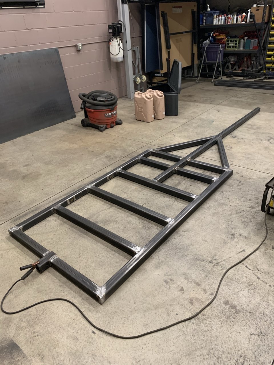

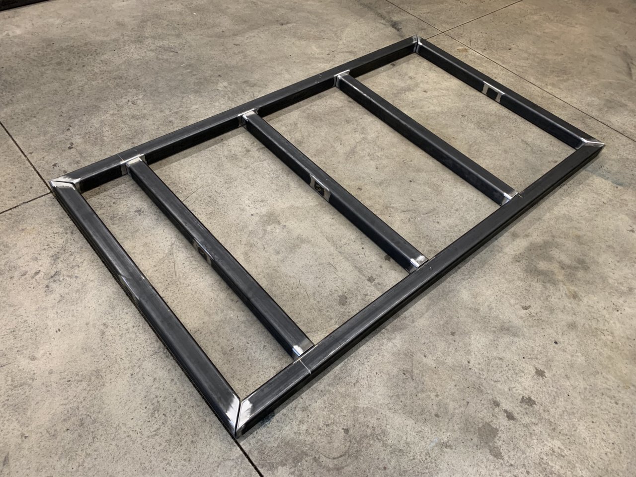

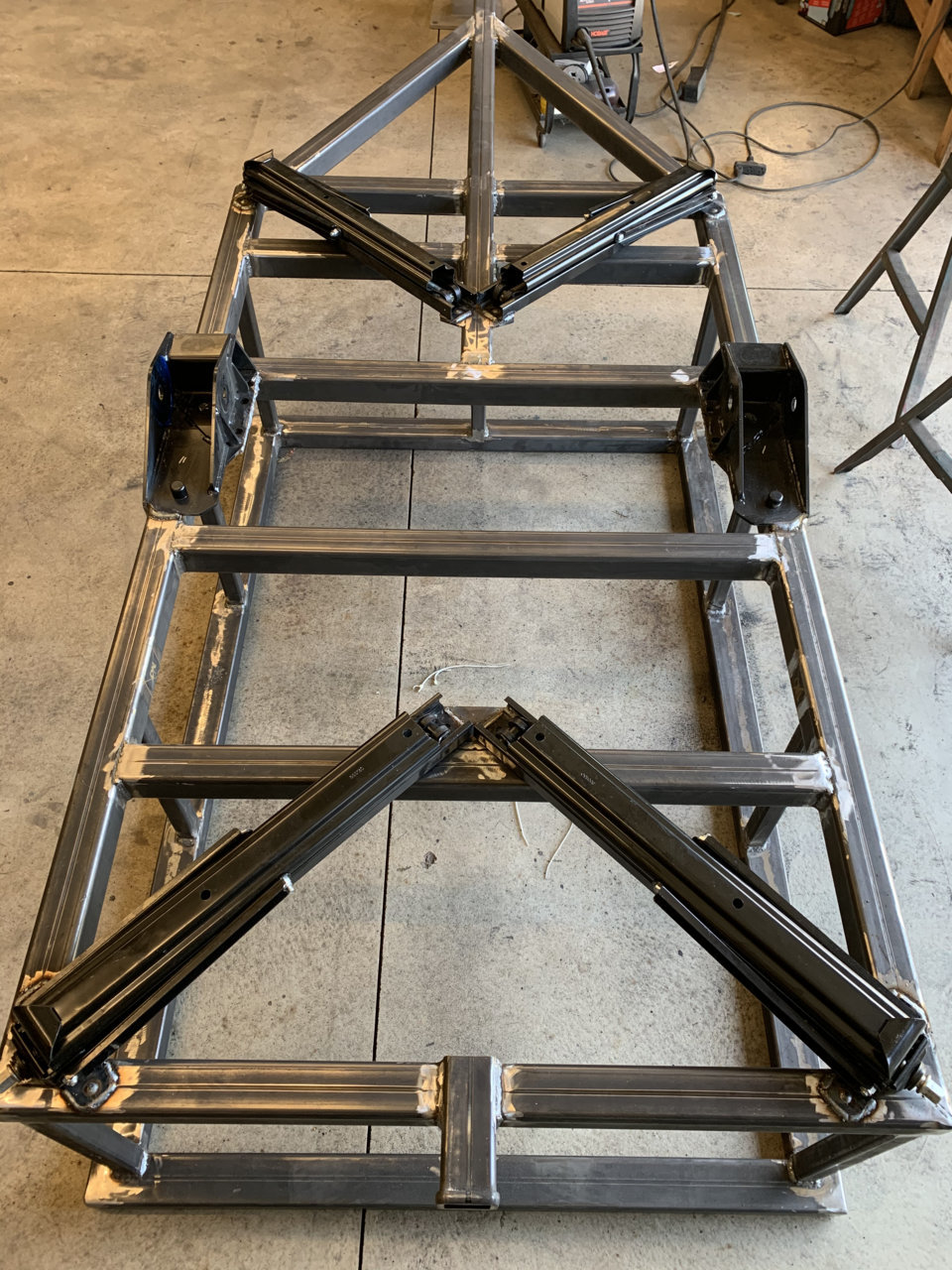

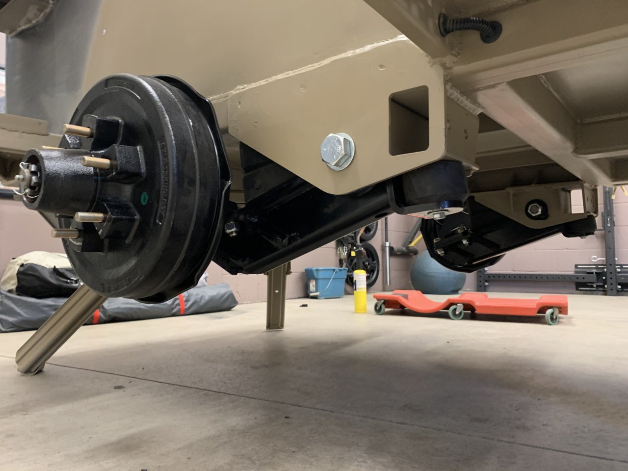

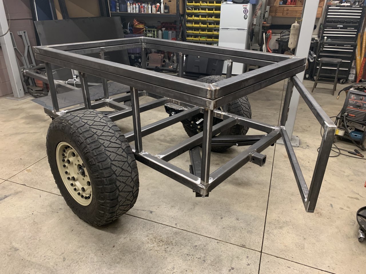

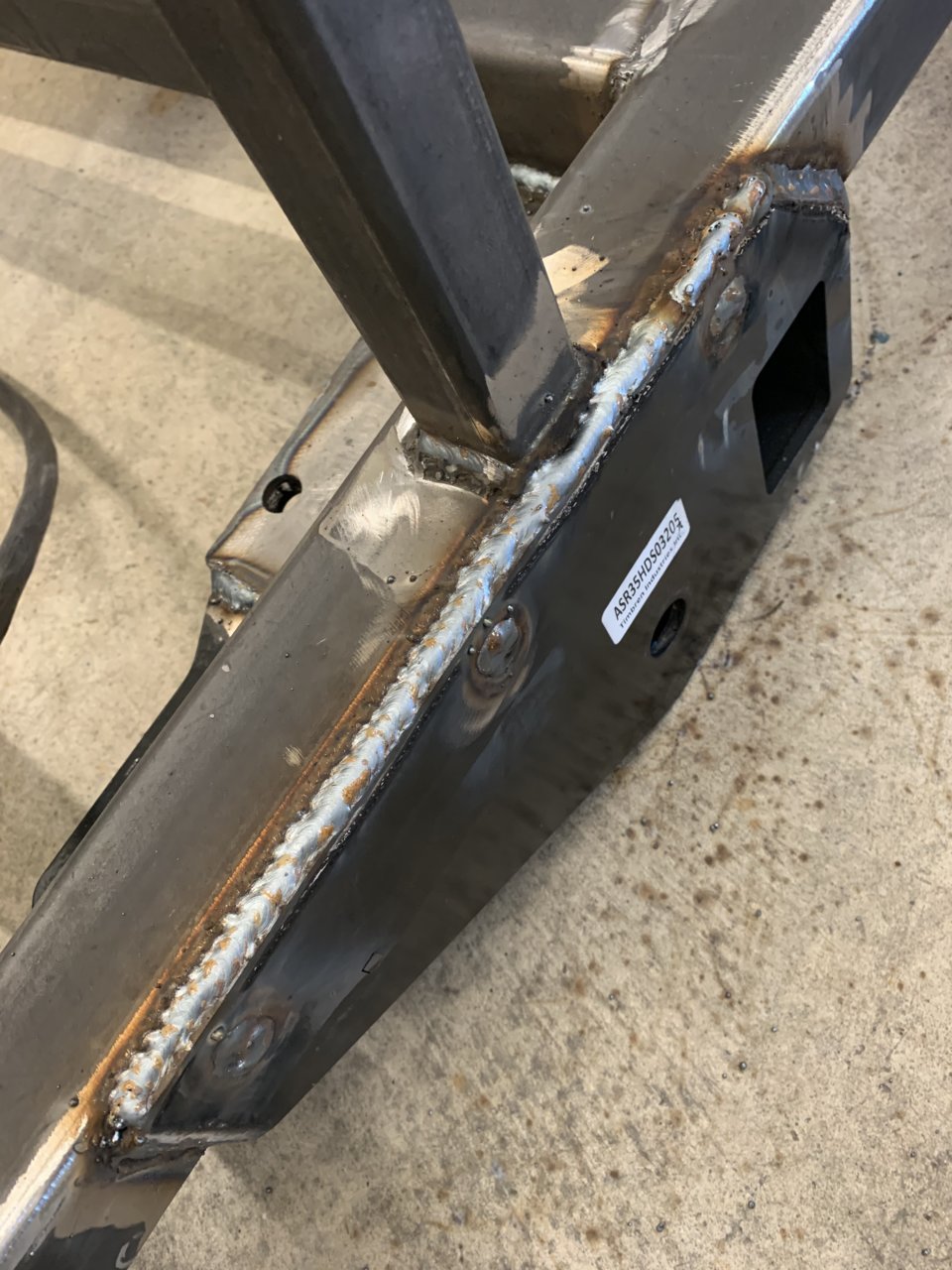

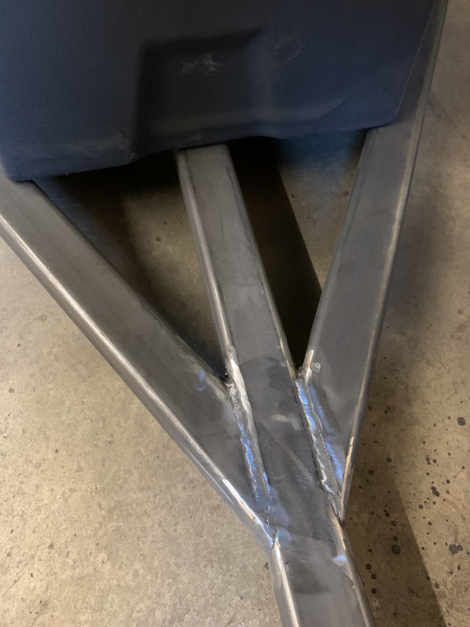

    I’ve been watching and taking notes for a while now- figure it’s about time I start posting progress of my build. I have a 2013 Tacoma that we named ‘taco de negro’ since it’s black- so the trailer has been affectionately dubbed ‘con queso’ so we have a black taco with cheese.
    I already outfitted with a dual battery system, ran some power lines to the bed and hitch, built a slide out for my ARB fridge, added trailer brake controller- etc. and all of that was preparation for this build.

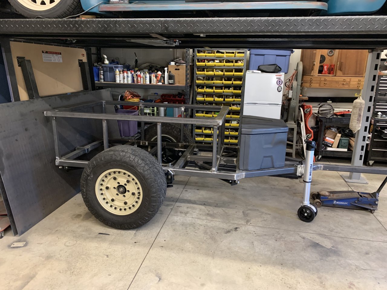

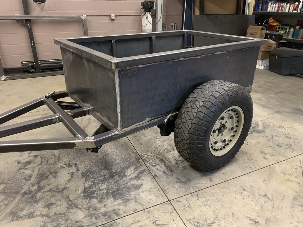

    Frame is 3/16, everything above it is .120 wall. I went with the timbren axle-less setup, with brakes. Found a set of tires that are the same size as my truck, and bought wheels with the same bolt pattern so I only have to carry one spare.
    Lots of fun ideas still to try, but wanted to show y’all where I’m at and I will add more as we go.

    Subbed and bumped, watching closely as I am going to be attempting a trailer build come spring. Looking good!
    What is your box size and what was your reasoning for going 3/16 for the frame instead of .120? I was planning .120 for the frame and something slightly thinner for the rest to save on weight but I also don't plan on taking my truck/trailer anywhere crazy.

    I went with 3/16 because I am classically known for over engineering- hell, I almost went 1/4”! I wanted the frame to be stout- and having planned on running axle less suspension- I don’t think I could have gone any thinner without potential for disaster.
    I know I will be putting this thing through it’s paces. I used to be really into hardcore wheeling so part of the draw of all of this is getting back on the trail and getting out to places most people won’t go.

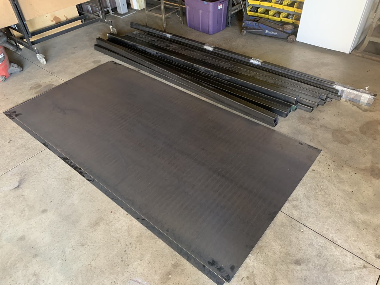

    What thickness sheet are you skinning it in?
  7. Nov 24, 2020 at 6:46 AM
    HULK64
    HULK64 [OP] Member
    Sep 15, 2019
    #305332
    20
    Josh
    2013 Black Tacoma TRD
    16ga

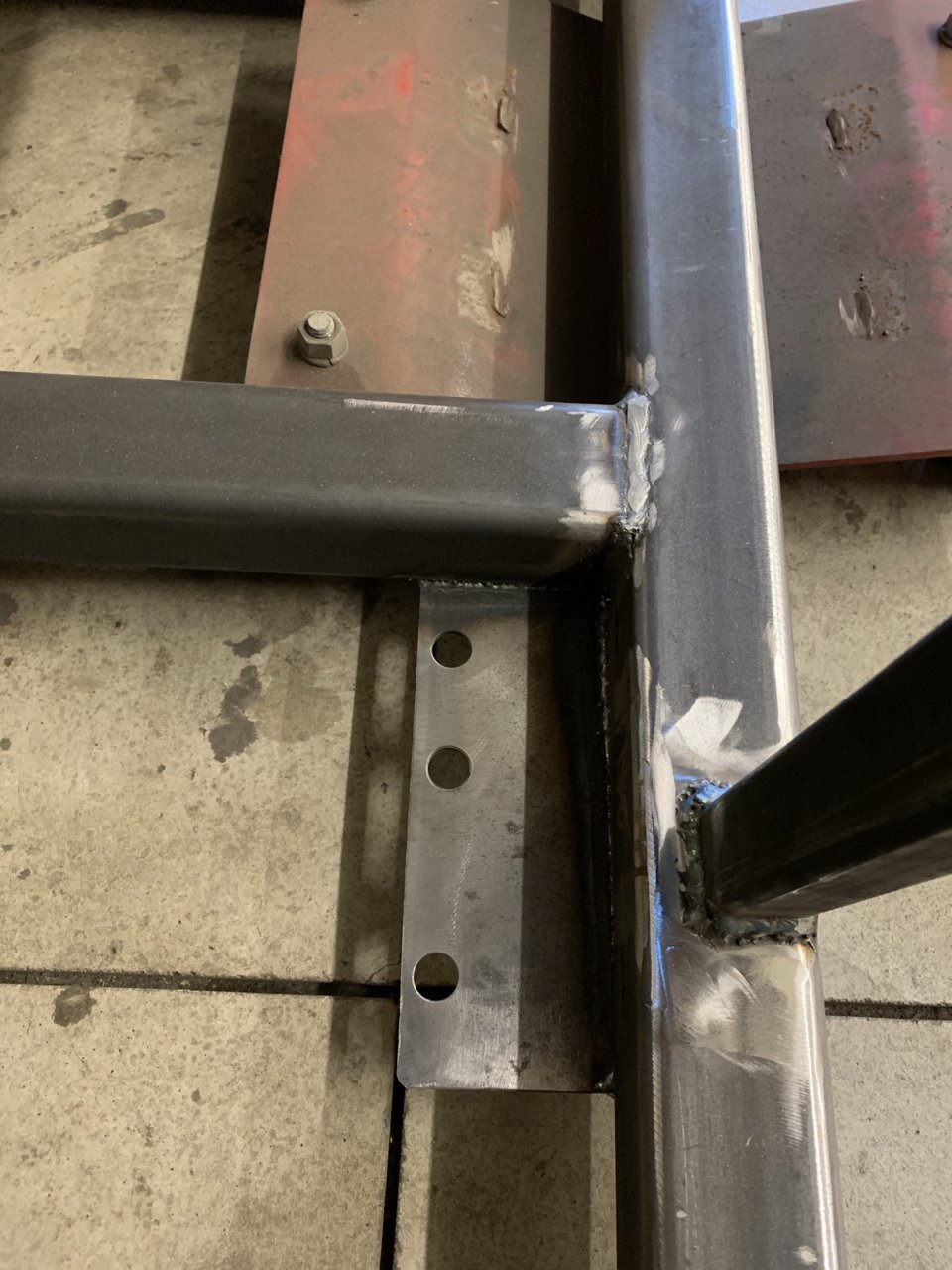

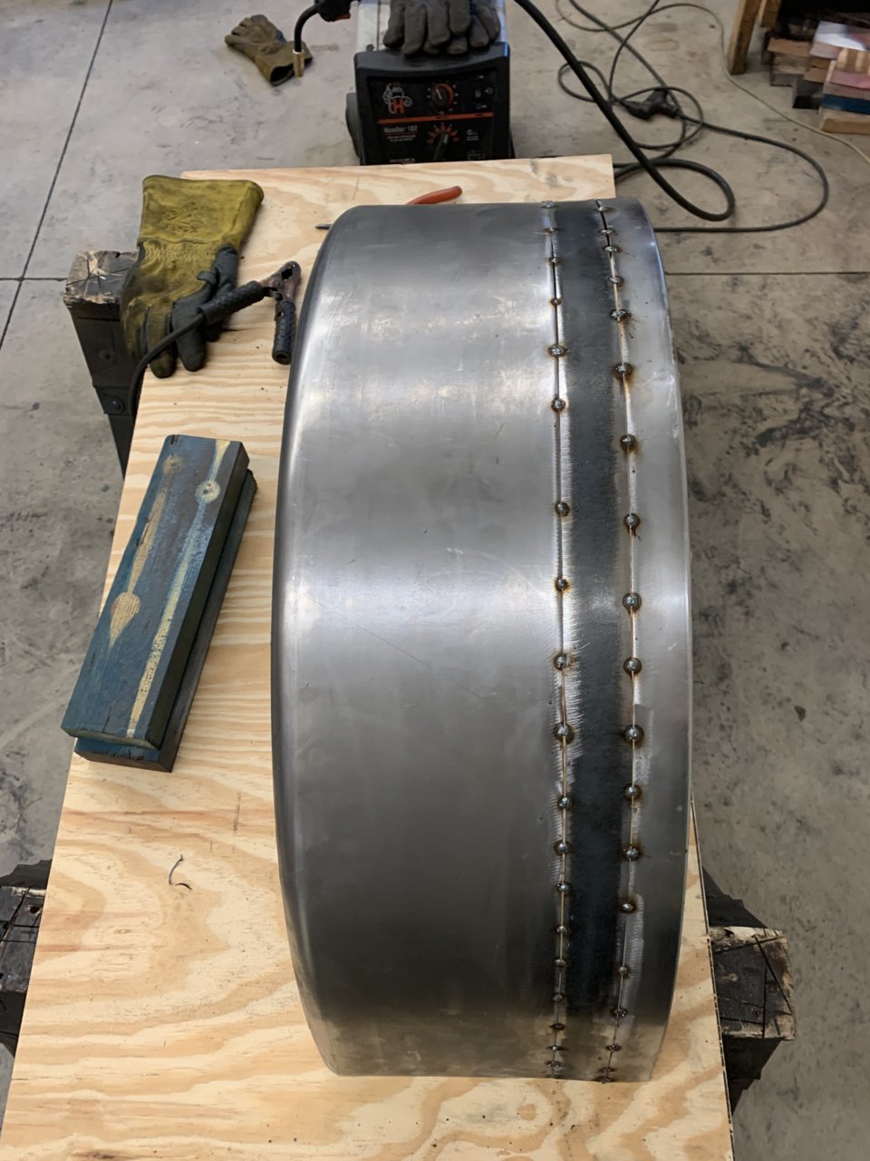

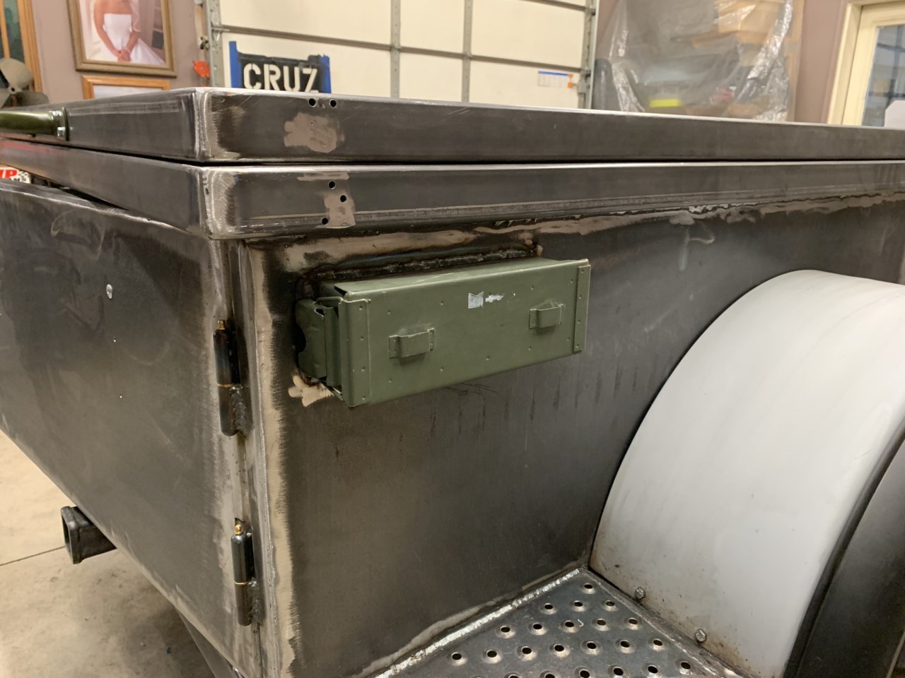

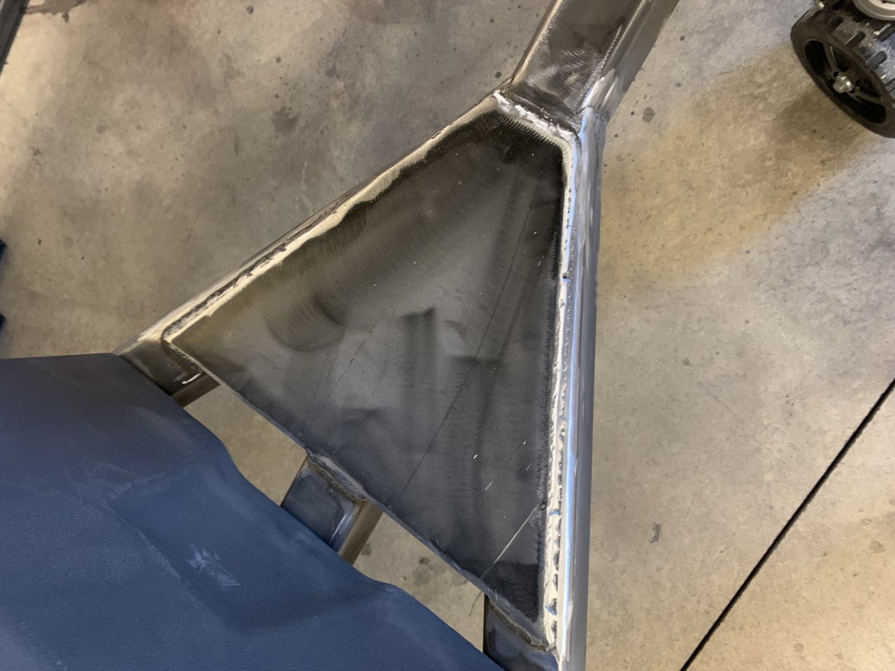

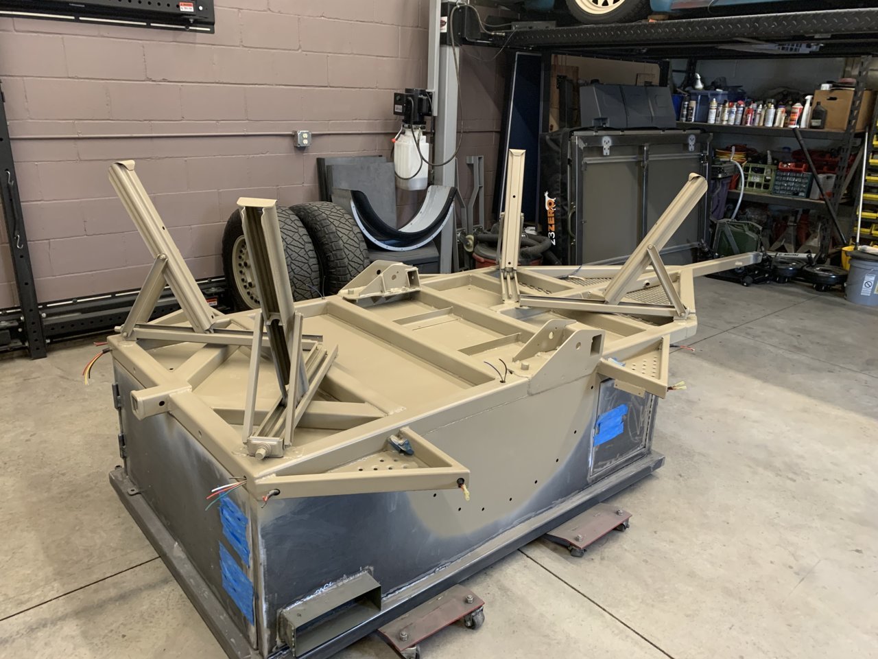

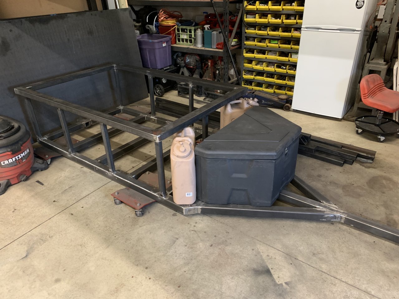

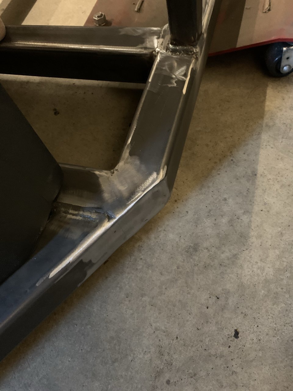

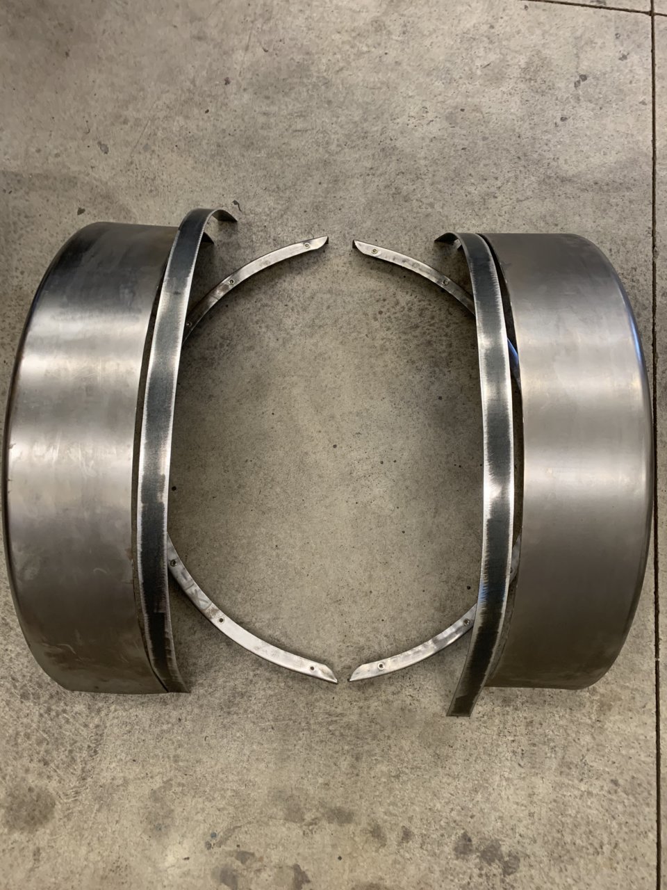

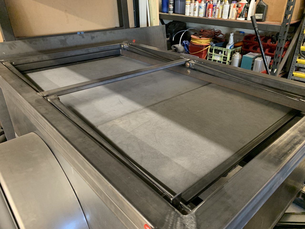

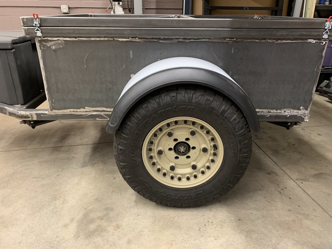

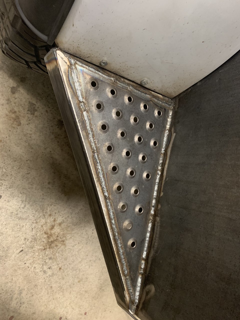

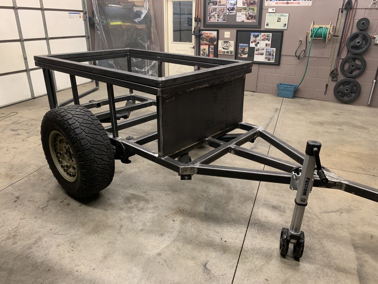

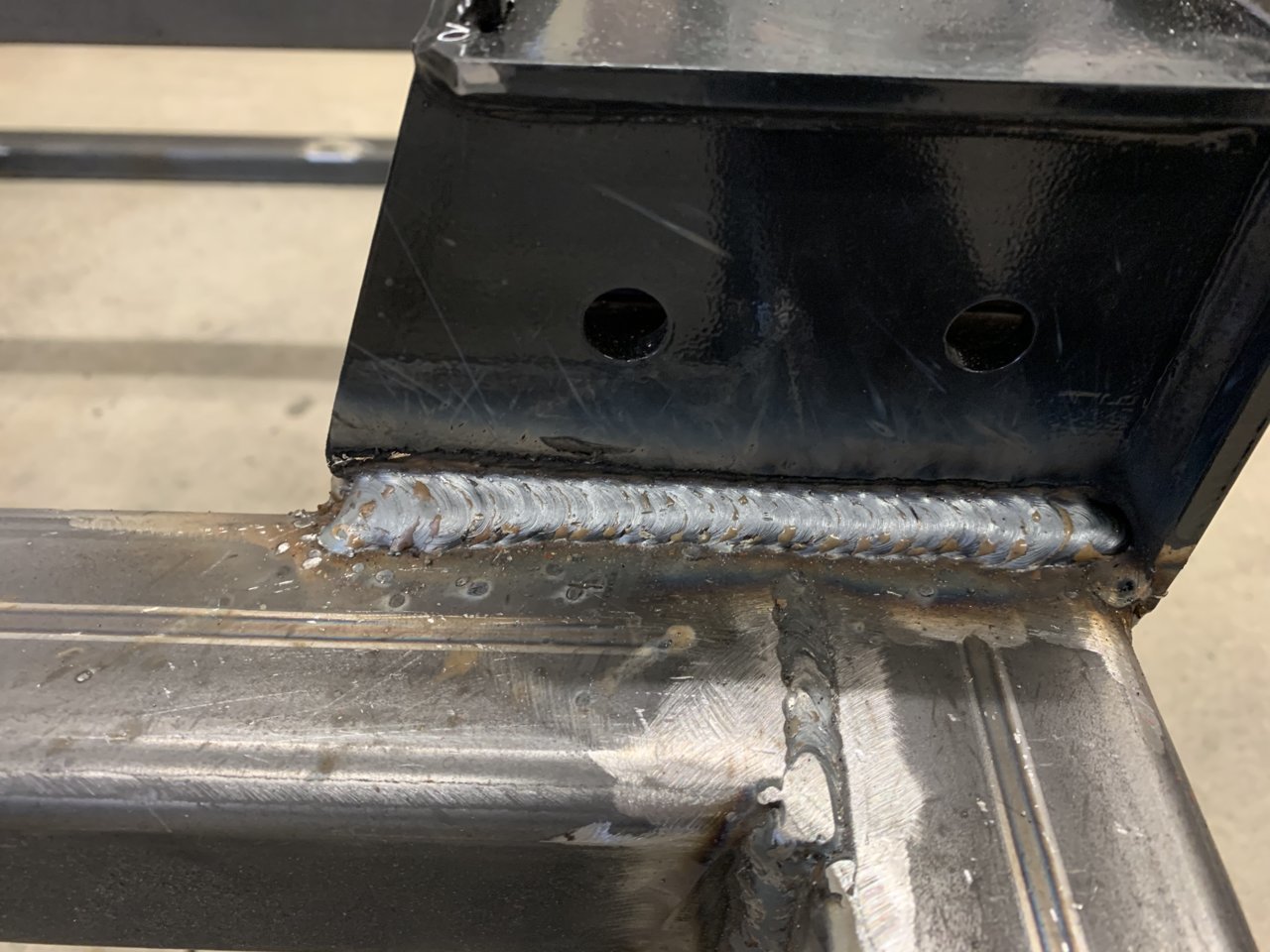

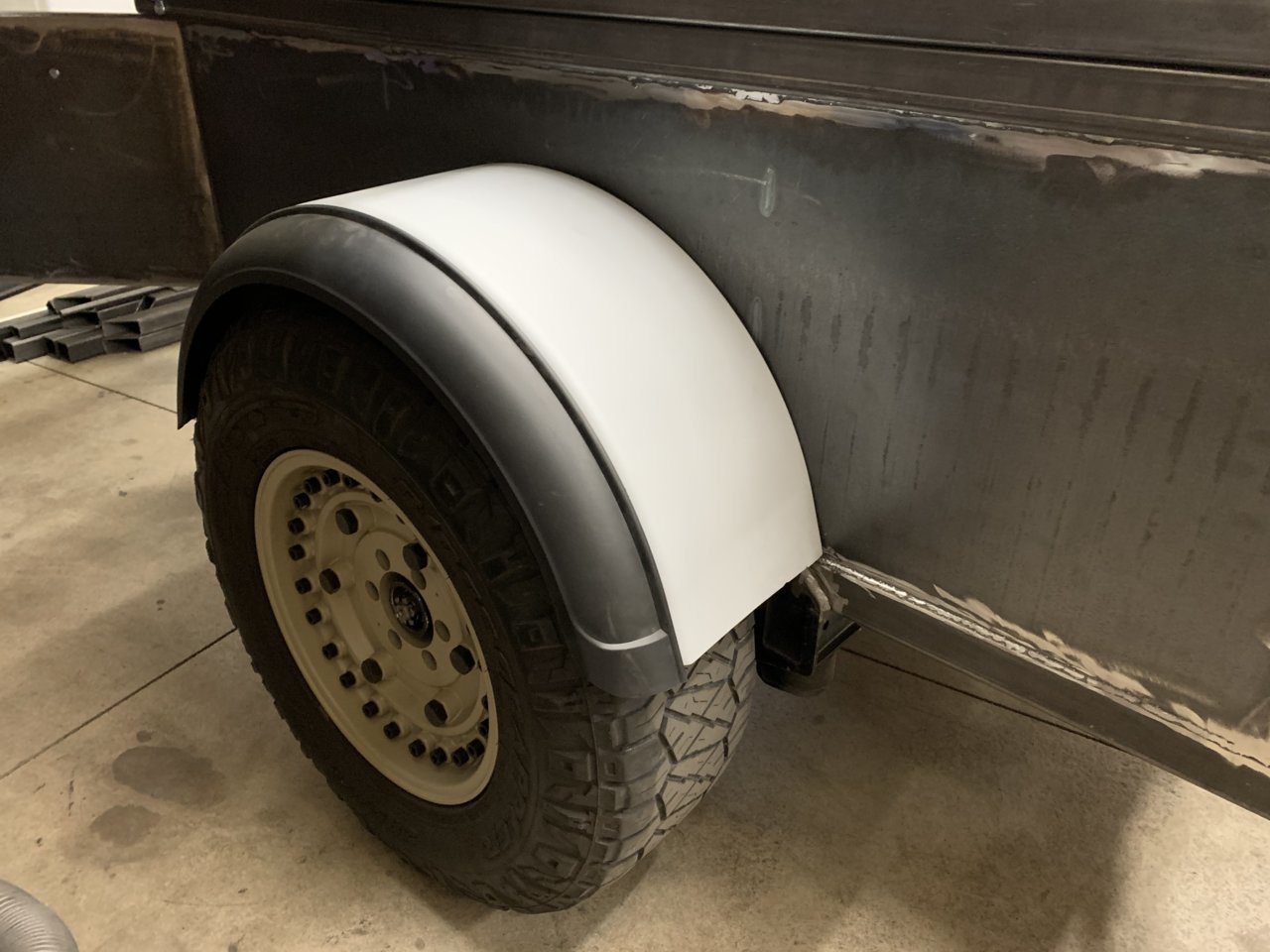

    Partial update- been staying after it lately. Got the walls built, gussets added, fenders widened, hard shell tonneau cover figured out, fold down table mounts, side steps built. This is where we start to veer away from the “Box Rocket” similarities- More to come on the cantilever platform soon...

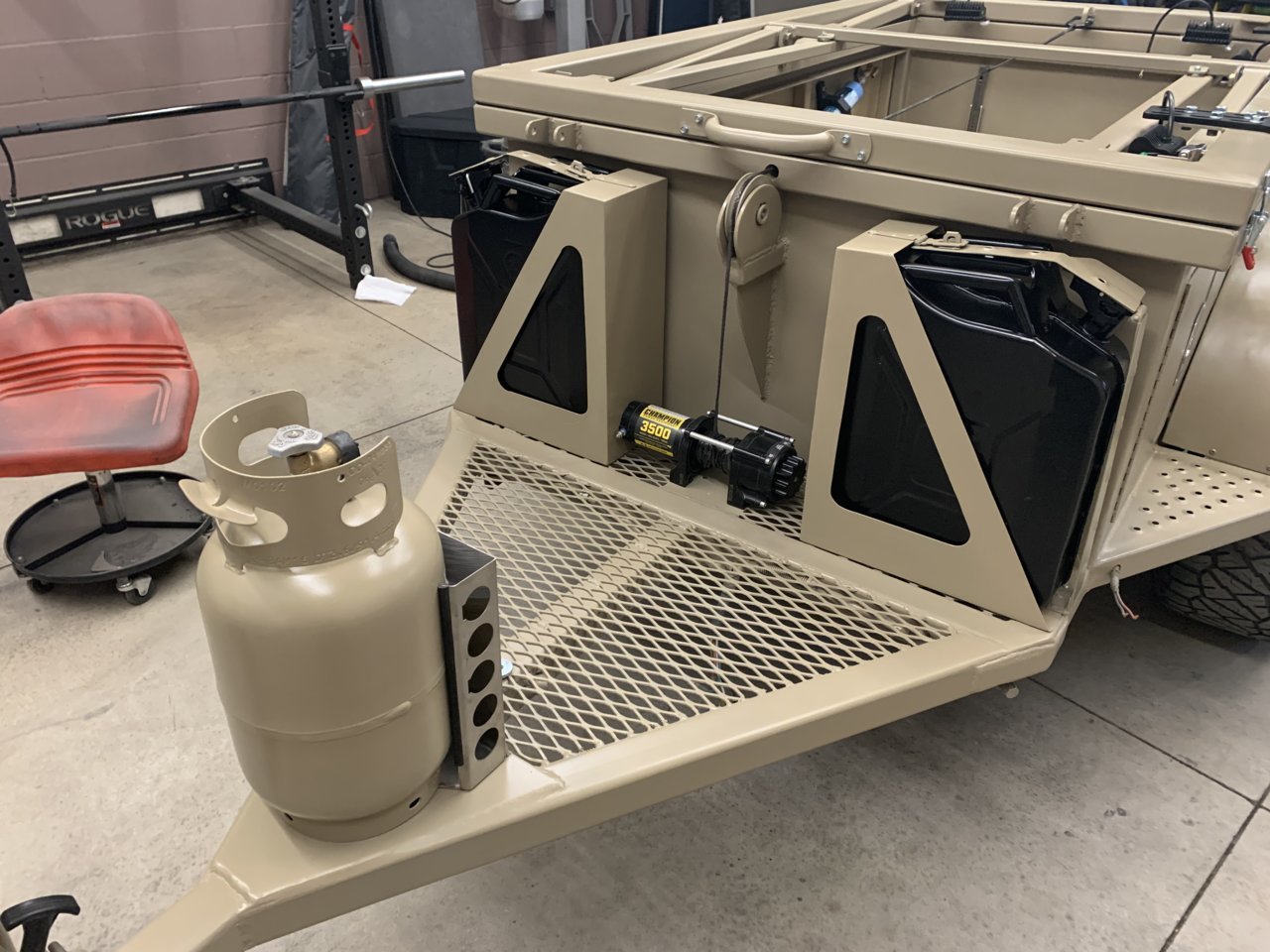

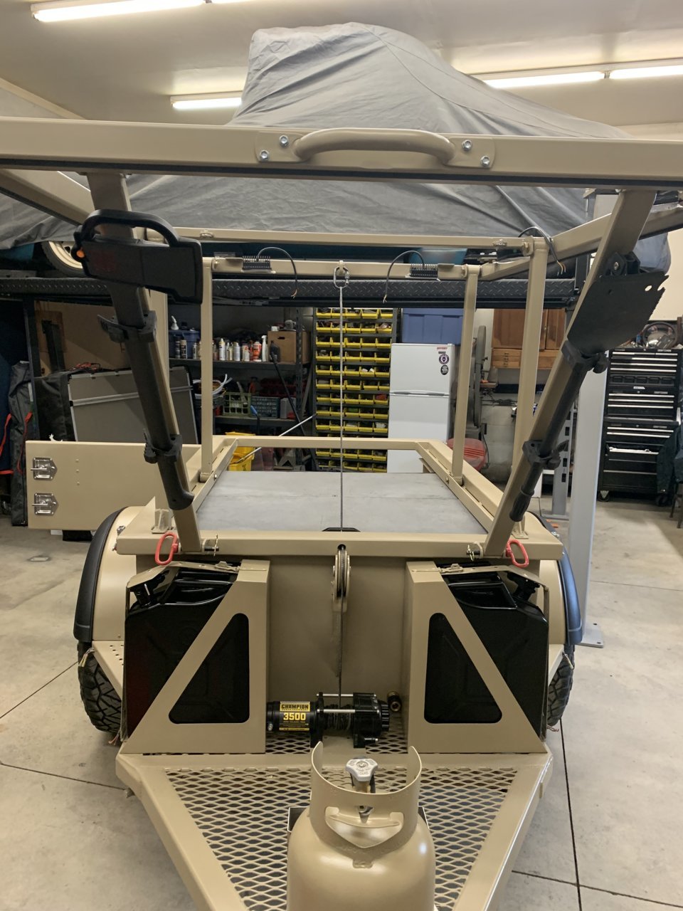

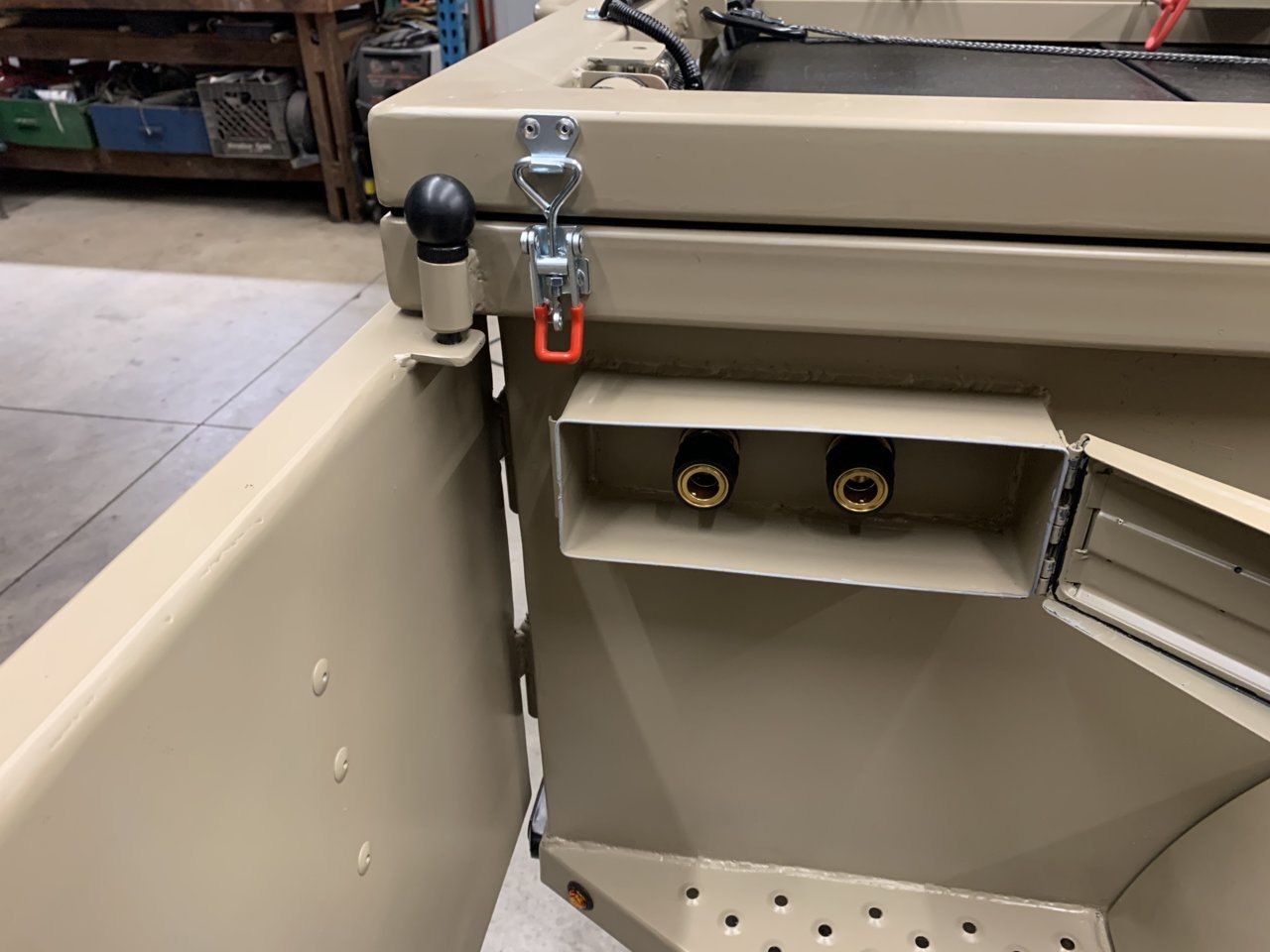

    Holiday progress update:

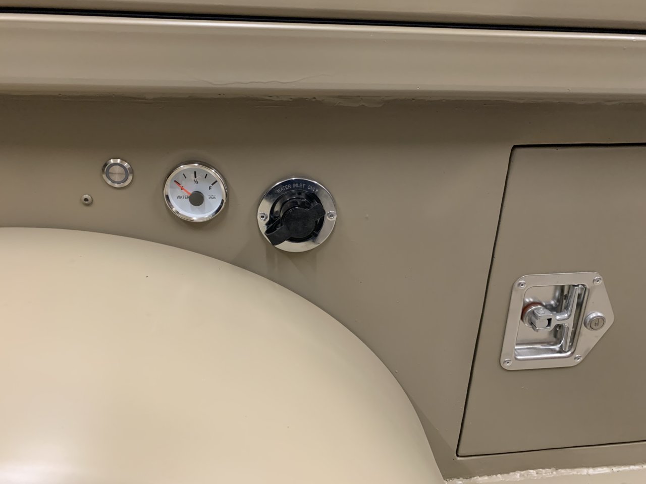

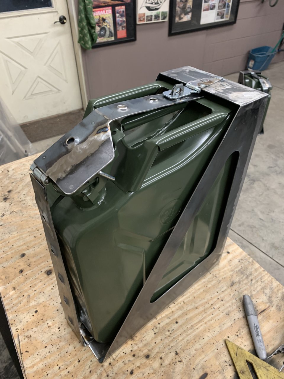

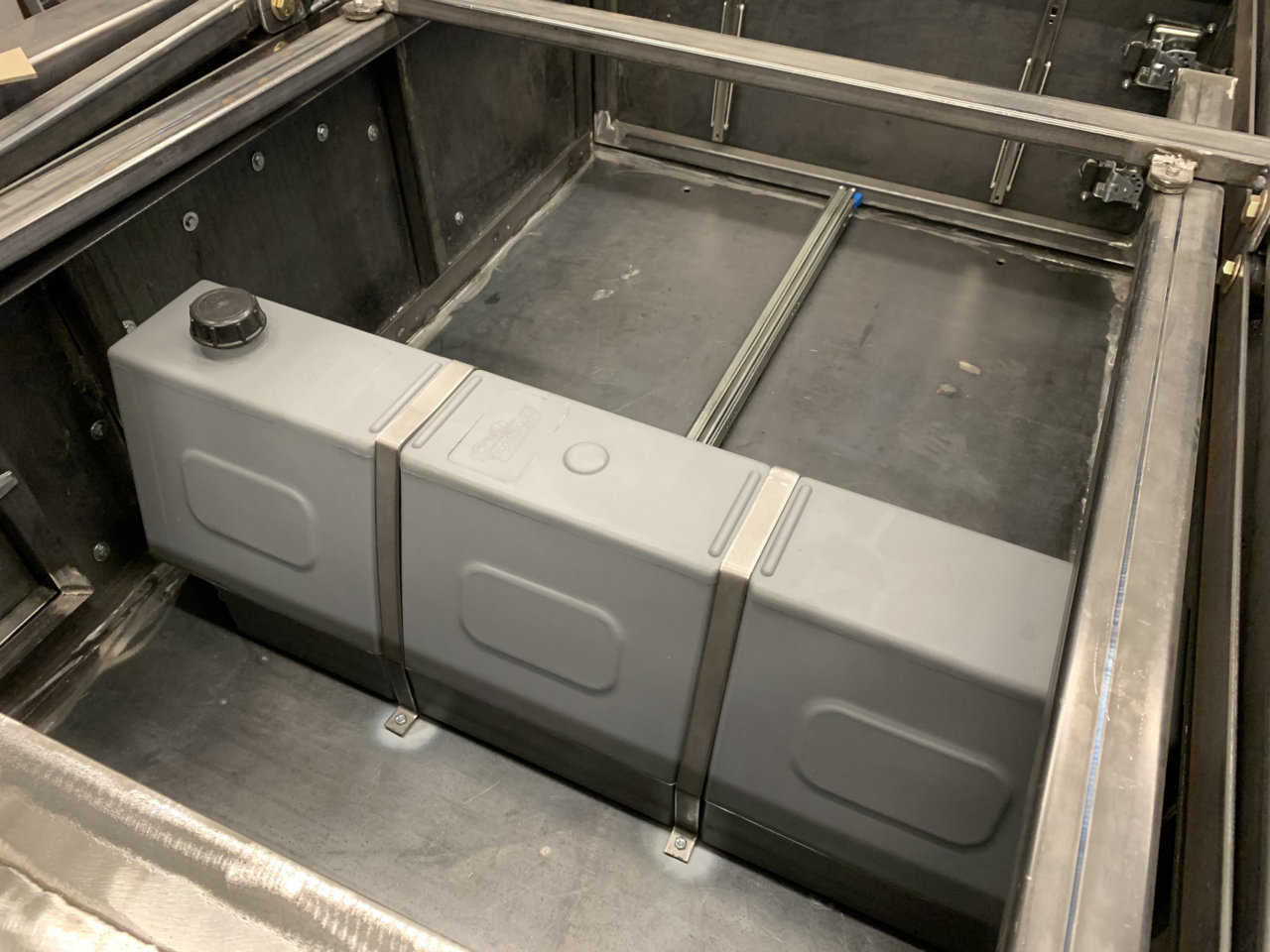

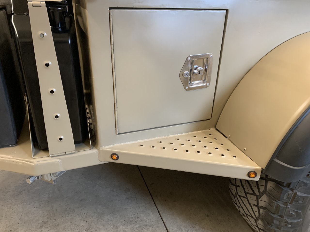

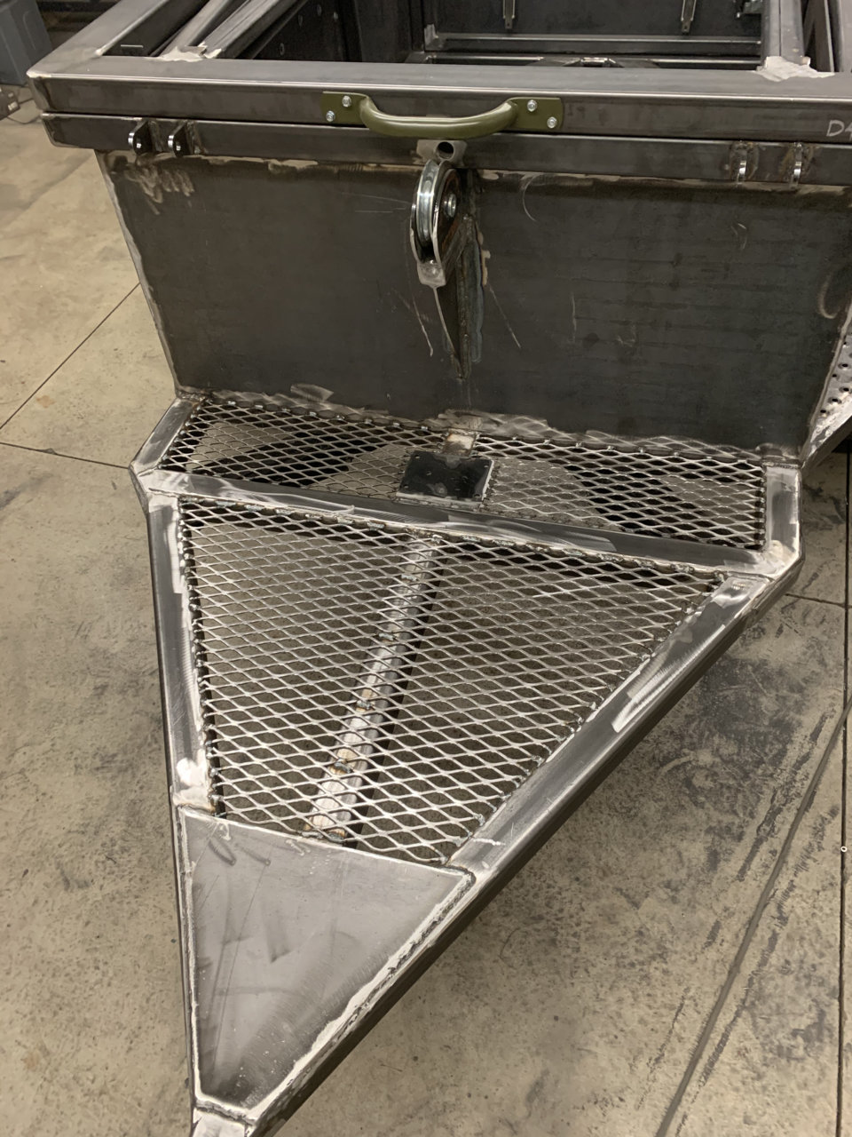

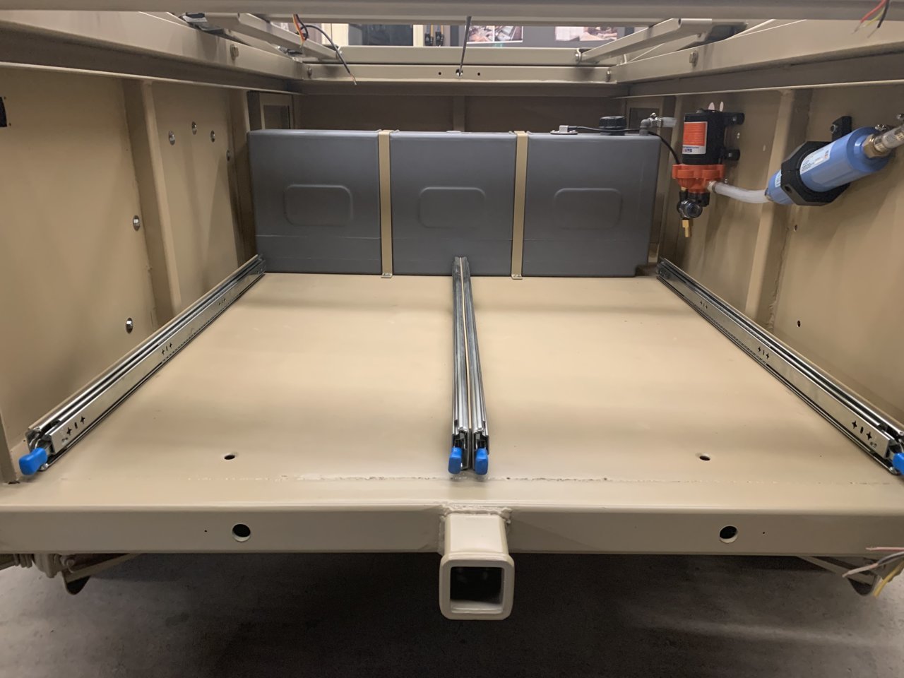

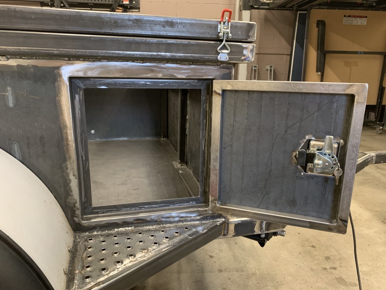

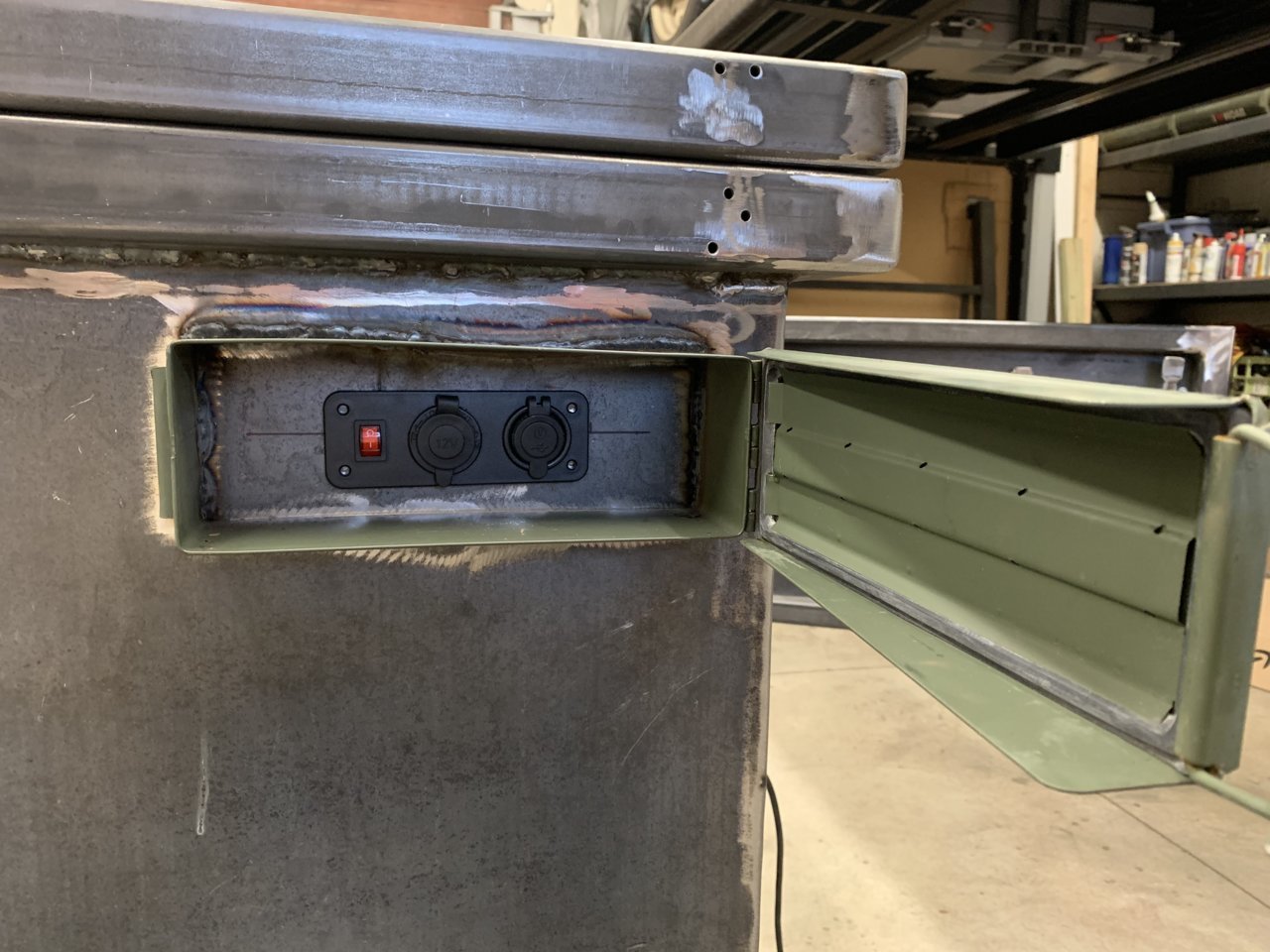

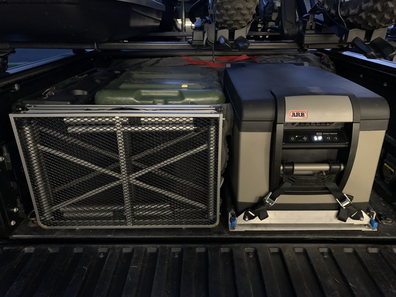

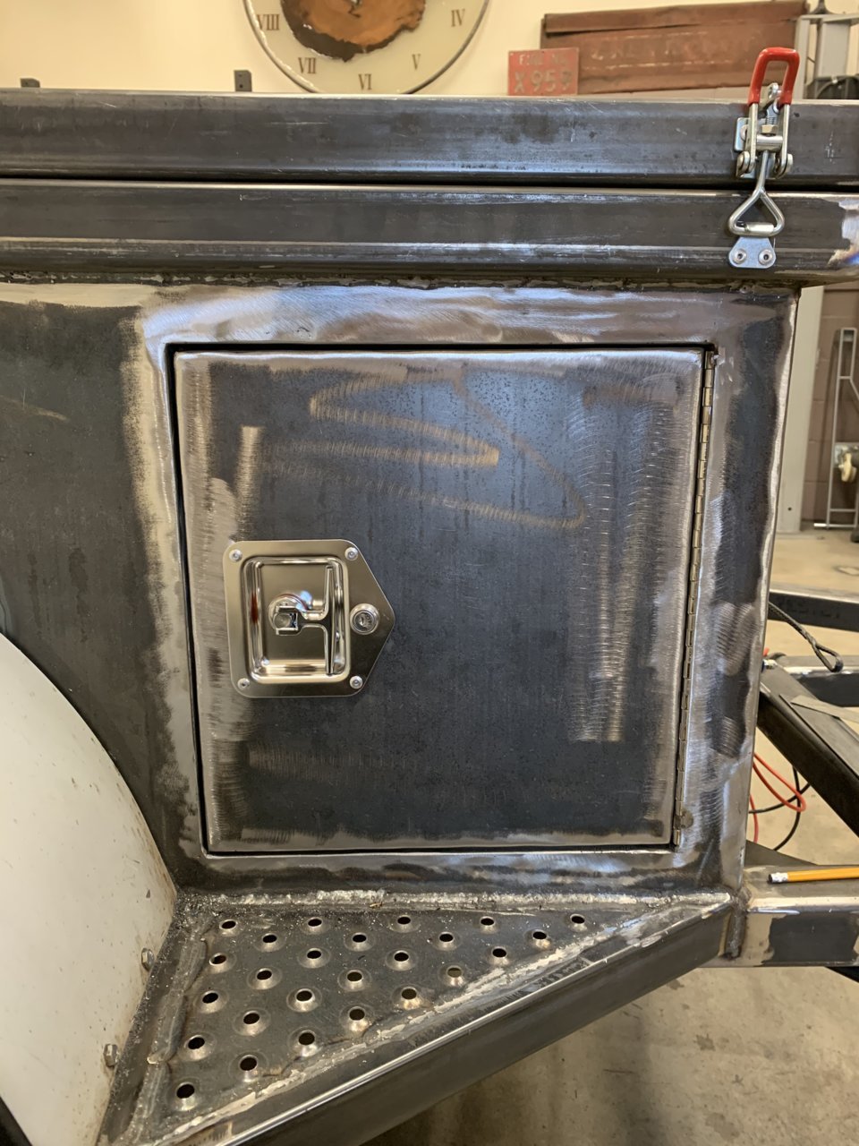

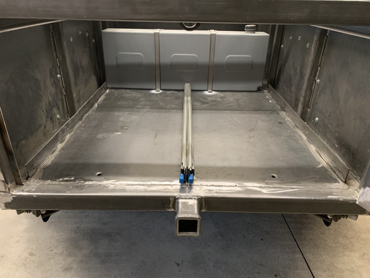

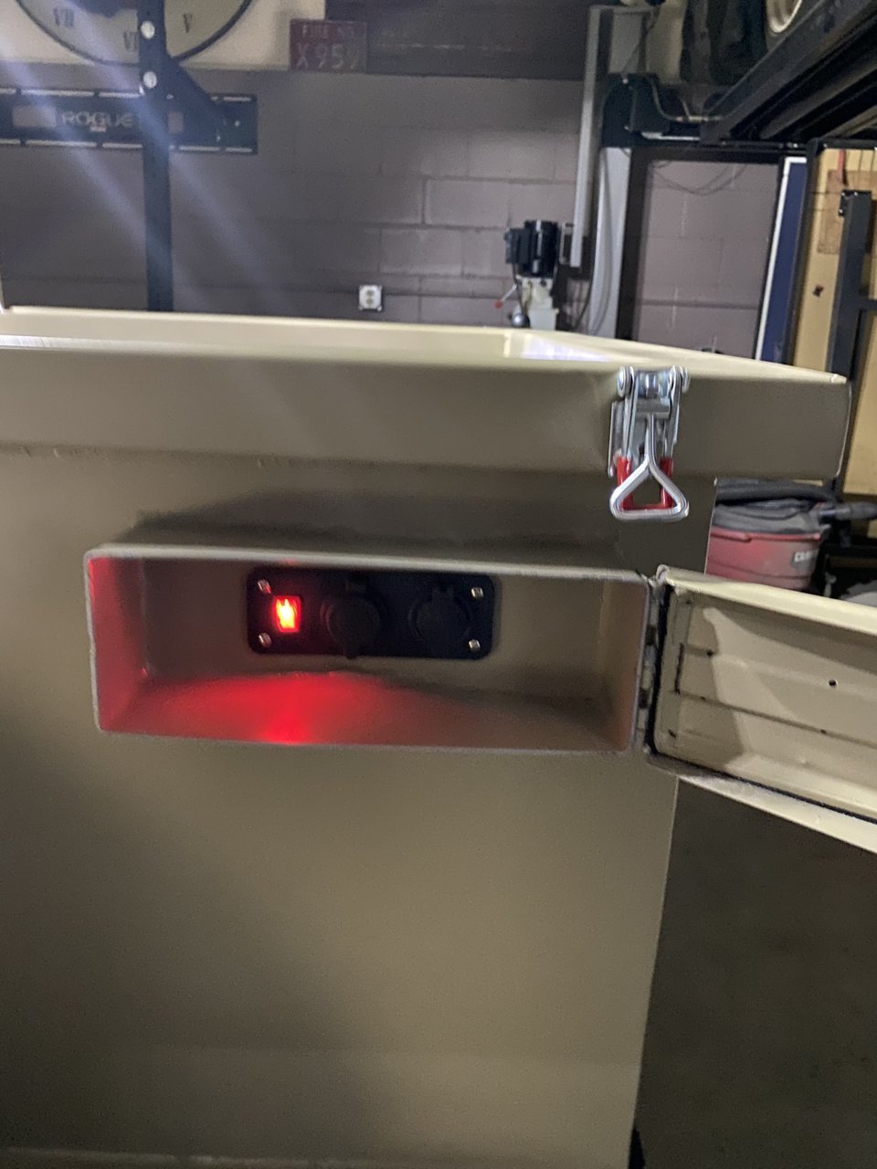

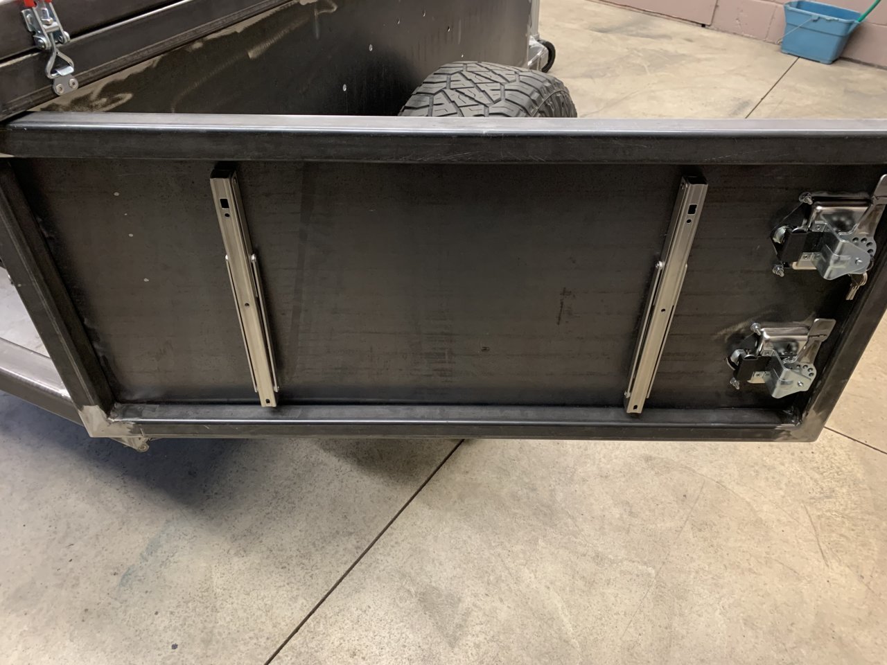

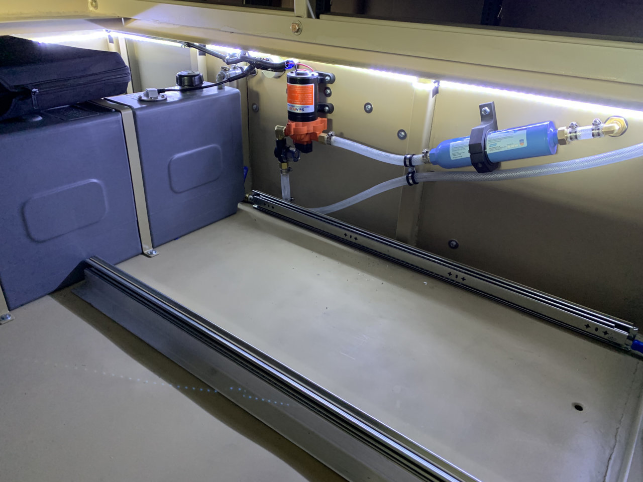

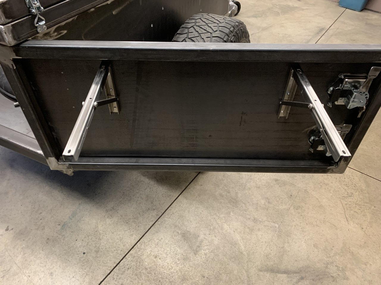

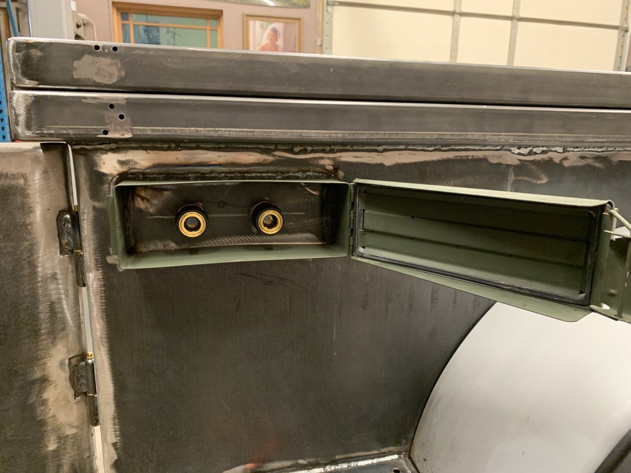

    Filled the gaps in the tongue with expanded sheet, made some side access doors, built gas can mounts from scratch cuz I was mad about how expensive they are to buy, got the floor welded in, mounted the 13 gallon tank, mounted the kitchen slide outs, and made some hidey holes for rear water quick connects and electric on opposite sides.
    Awning is on order and tent pickup is next week- get excited....

    Looking sick dude! Are you planning to put any rubber seals on the inside of your side access doors?

    Yes- once it's painted I put a 3M rubber or some window insulation in there.

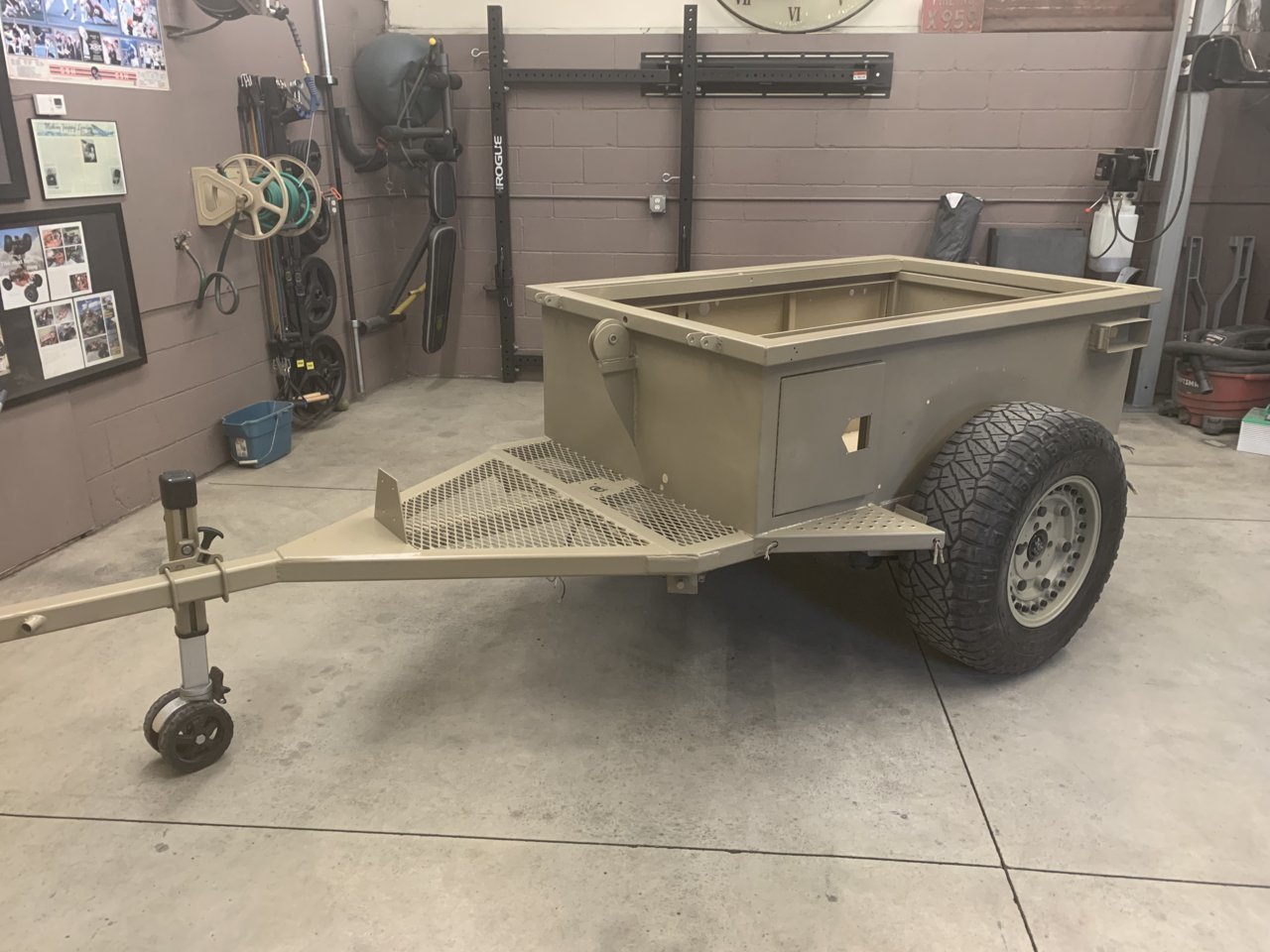

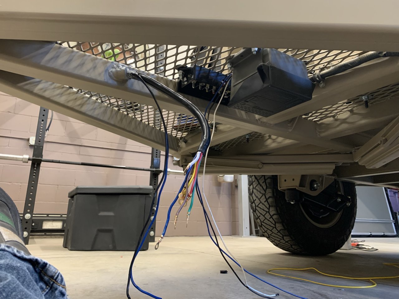

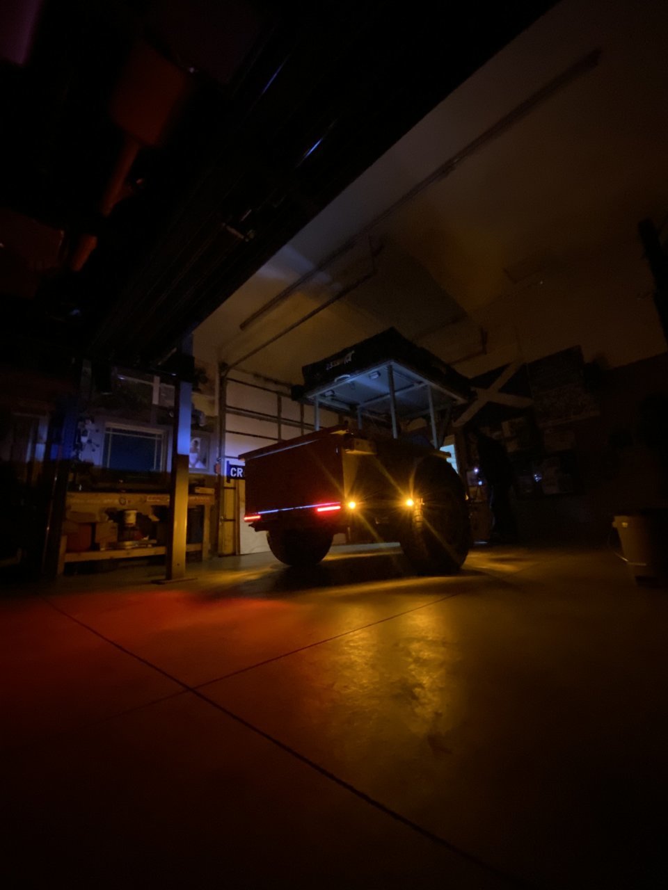

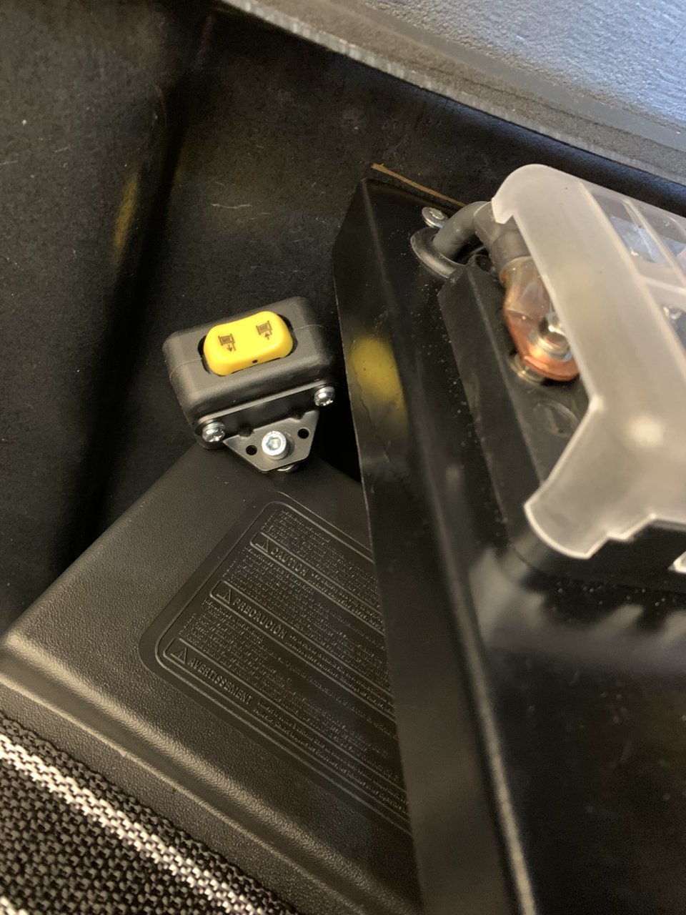

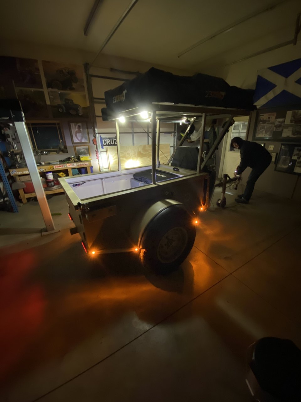

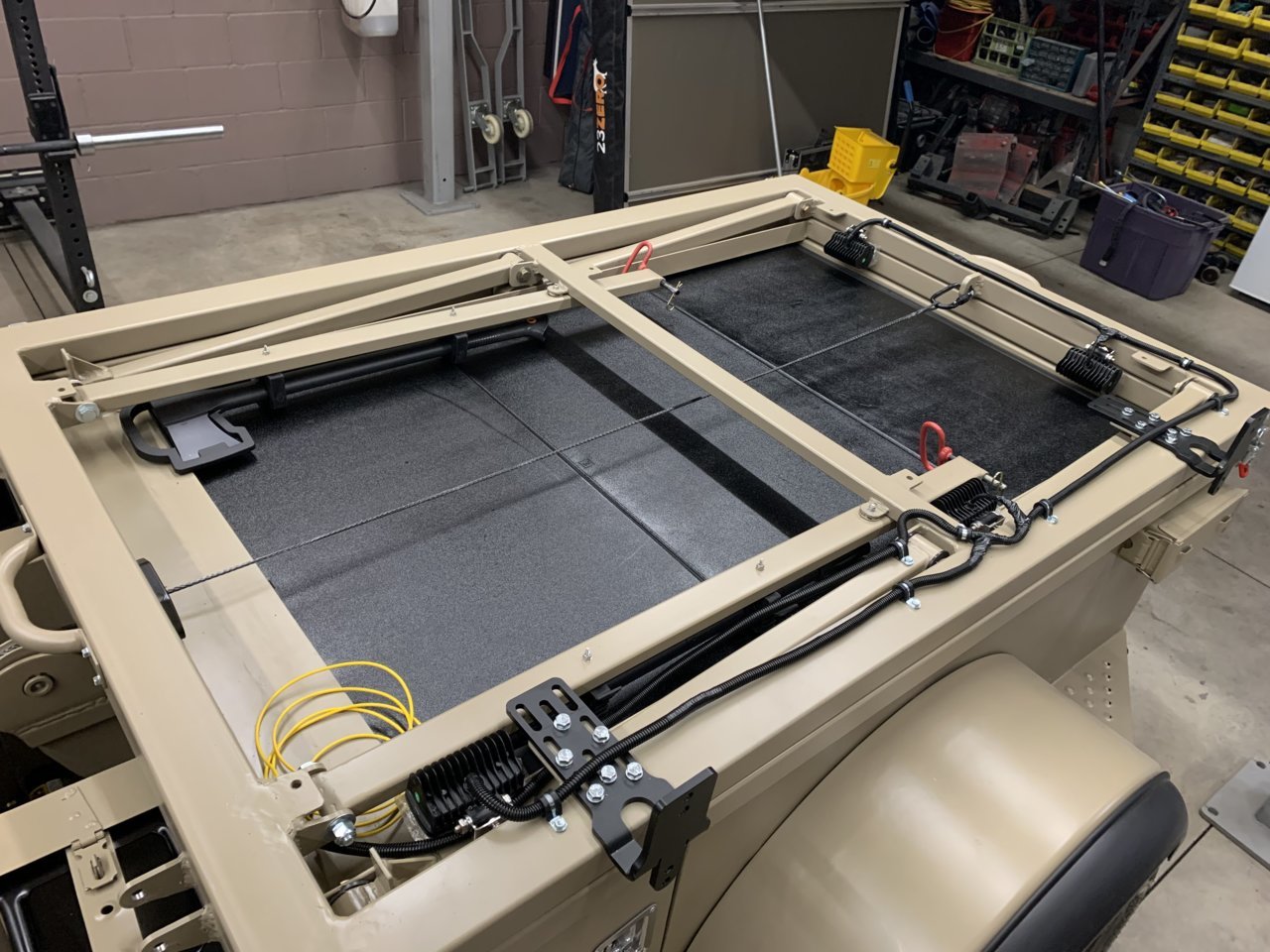

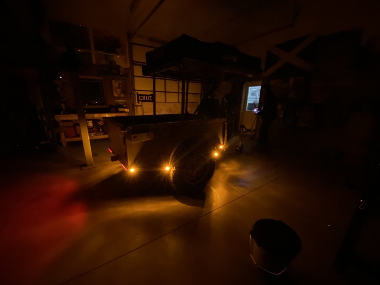

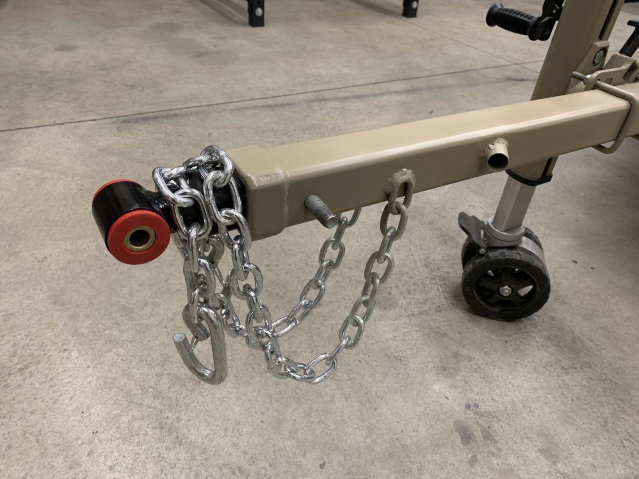

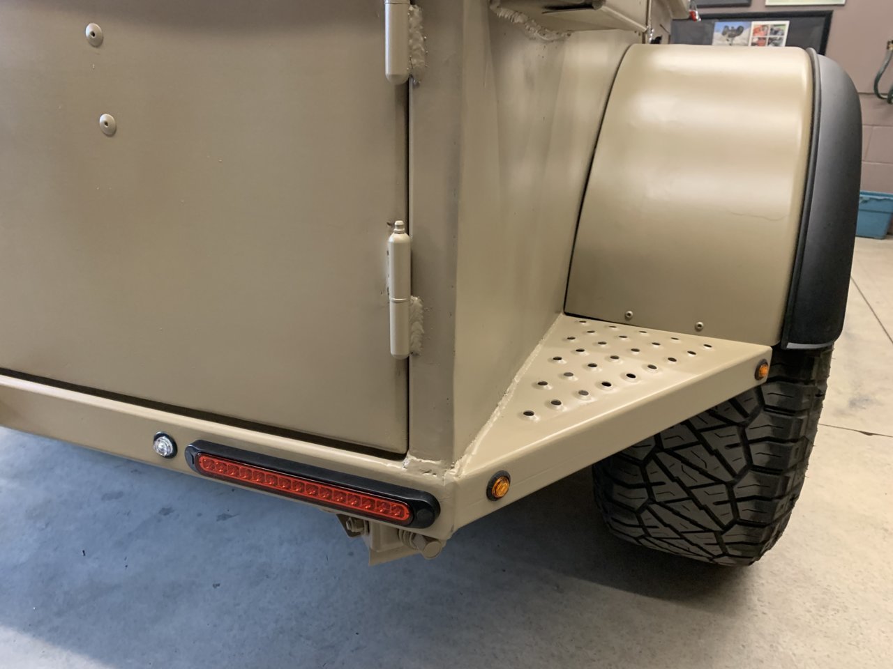

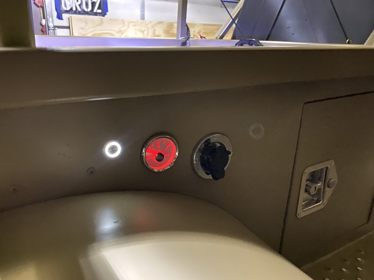

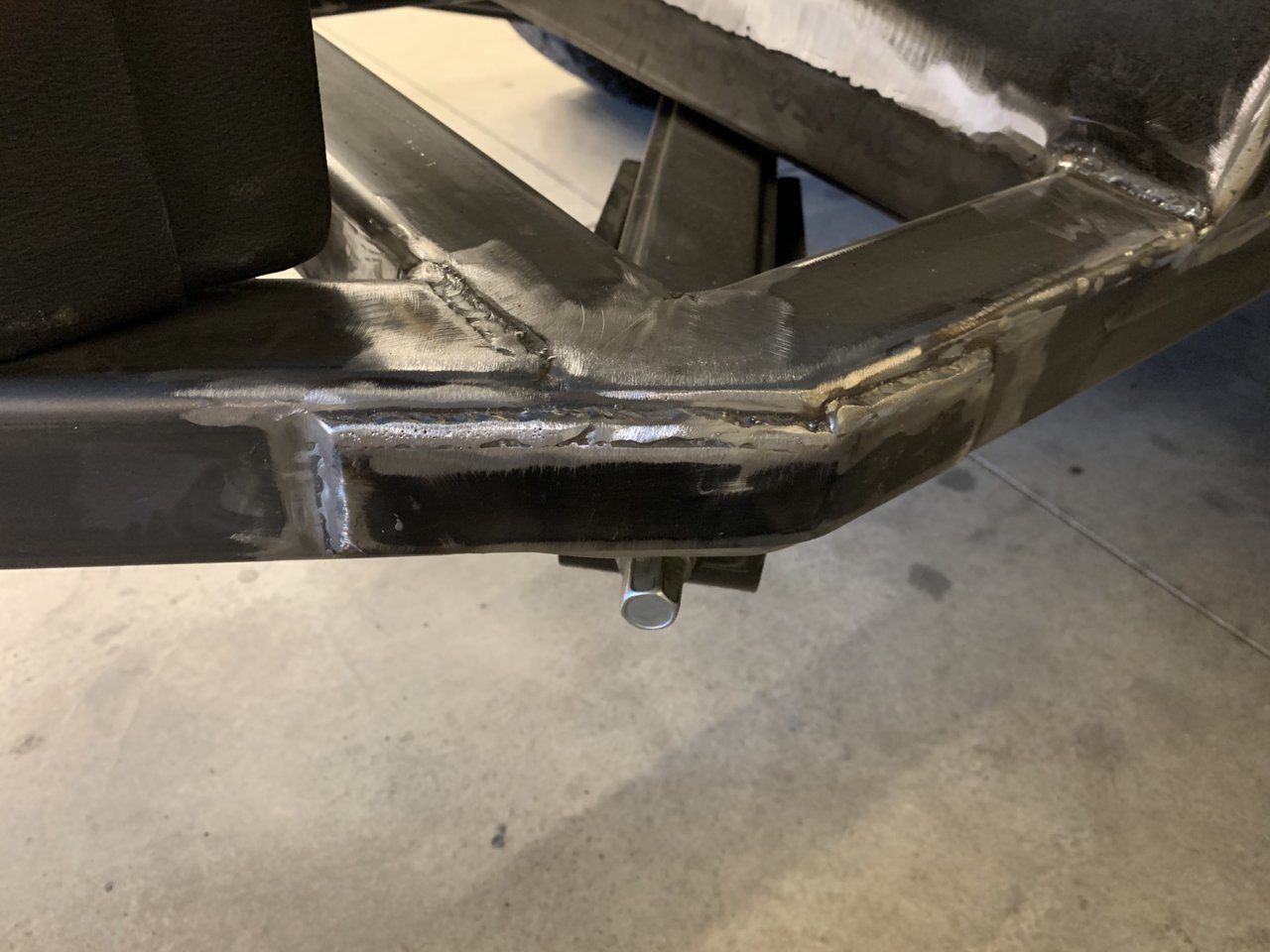

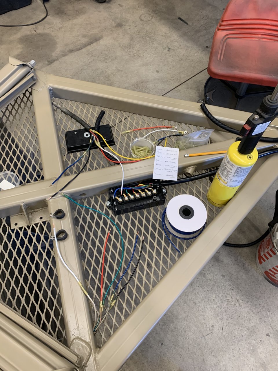

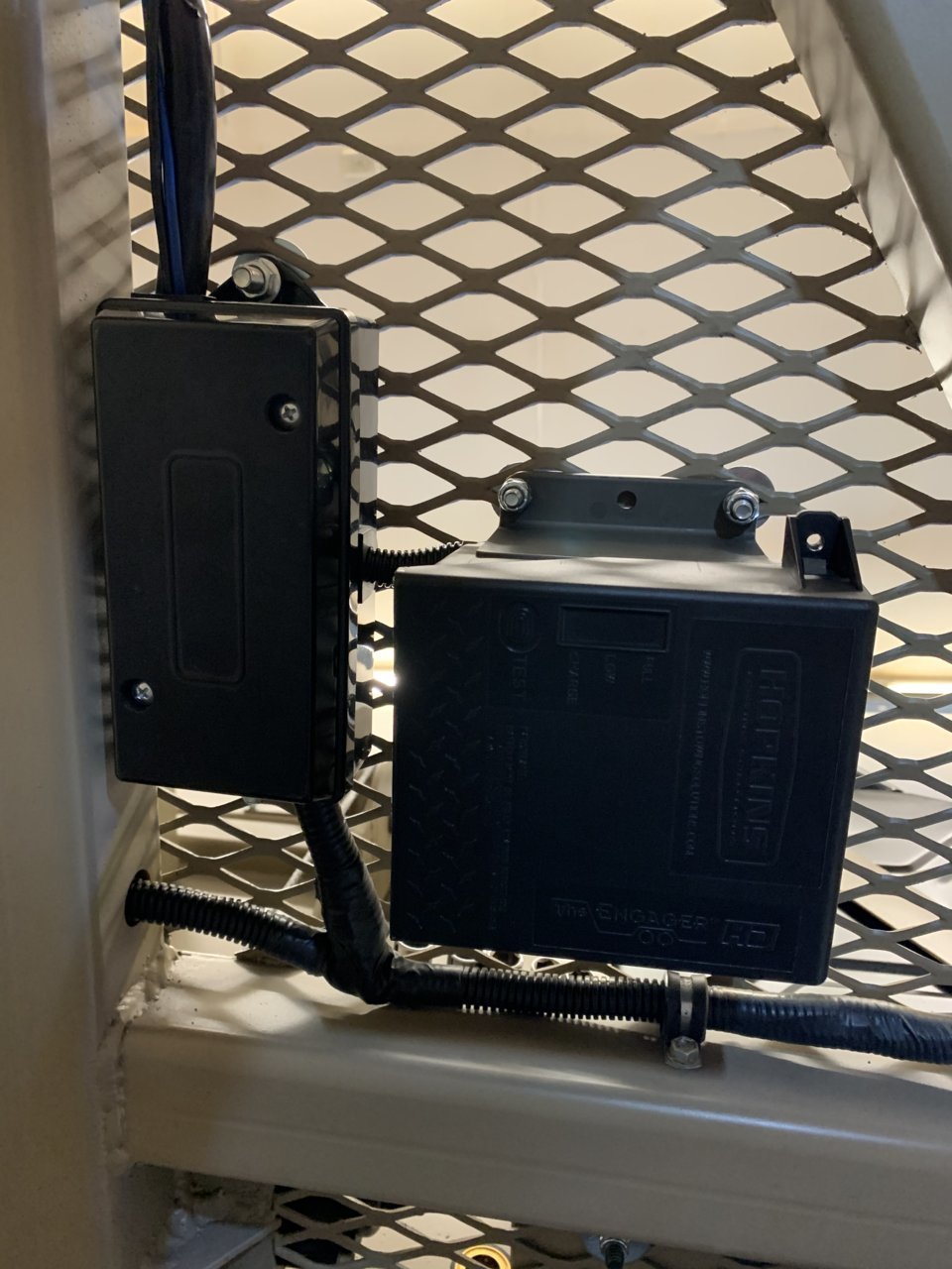

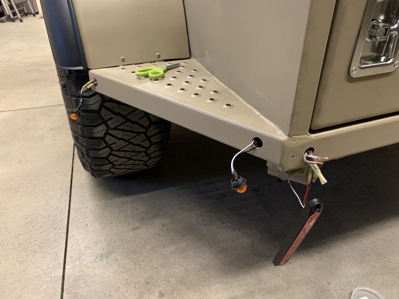

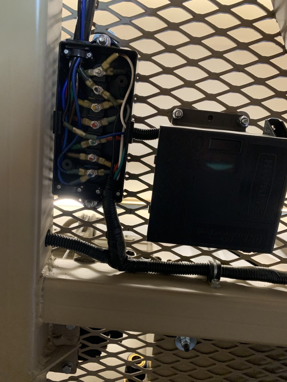

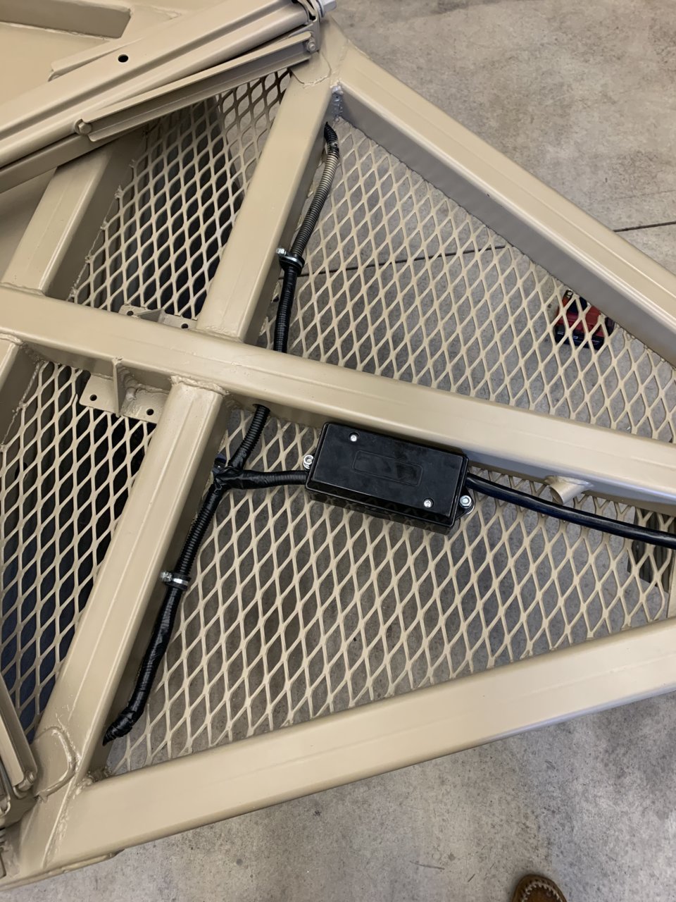

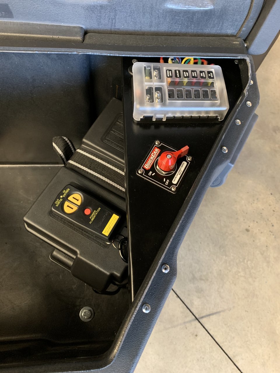

    Been a busy couple weeks getting everything painted and beginning on final install. Suspension and brakes are in for good, frame is wired, water system is in for good, upper platform is mounted and the lights are wired too. Got the axe abs shovel mounts finished too.
    Now we start on wiring the interior and making sure everything works.
    050FFF54-6AF7-46F8-8E80-3B67CC03181A.jpg FAD26380-02DC-486B-B3AF-83D78F57A963.jpg F3C59C40-5D86-43DF-BFF9-641DF1FCC65D.jpg 8DB11AB0-414D-4D74-9B27-E8FCC481C6FD.jpg F60E9E9A-5B6E-4C64-9F3D-67114AB343E4.jpg 57545FA7-DA5B-43C5-B75C-7DD42A05FFCA.jpg 21911FC1-19A2-4A02-962B-94290DA236BB.jpg EFBAAAA0-C0D4-4F4B-9B17-9CF11427E11C.jpg 38F3FEFA-4118-4477-B904-54257B673241.jpg 5B9B33F6-2D1C-44A3-81CB-B69A3E9E8163.jpg 72B68F29-DEBF-47CD-9F8E-86950BB62607.jpg C22015F5-D394-4A7F-8A2A-E909F6D3E445.jpg 1ECC61B4-8ED2-4B15-A3E1-8892F1162F5D.jpg 33D41331-E834-466F-A11A-8EBDE494C97B.jpg 3CD0952D-FE30-4110-9A7D-5E64A580A31F.jpg 94955BB8-EC1E-4A37-B4A9-46D846B1C0C2.jpg 63471123-461A-4804-A14D-72C8C3CEFE24.jpg B4123038-B4DA-4A35-8F7B-B227A473A6E6.jpg

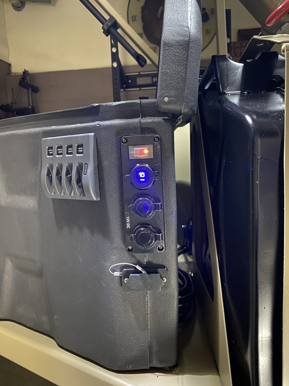

    So. Much. Wiring.
    But it all came together and with the help of some of my smart buddies, everything miraculously works!
    Stoked to put away the wire spools and shrink wrap and move onto the slide outs and kitchen.

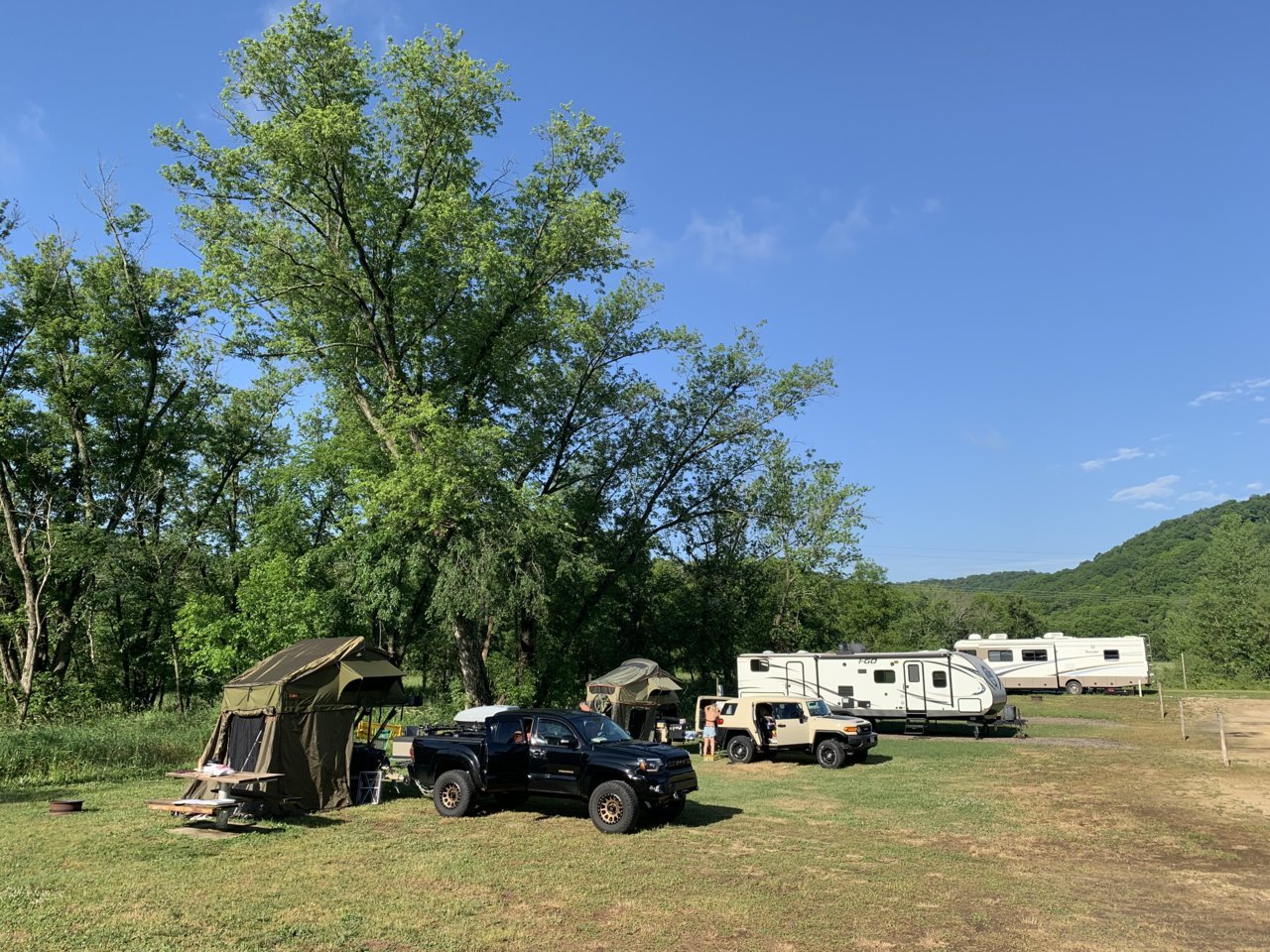

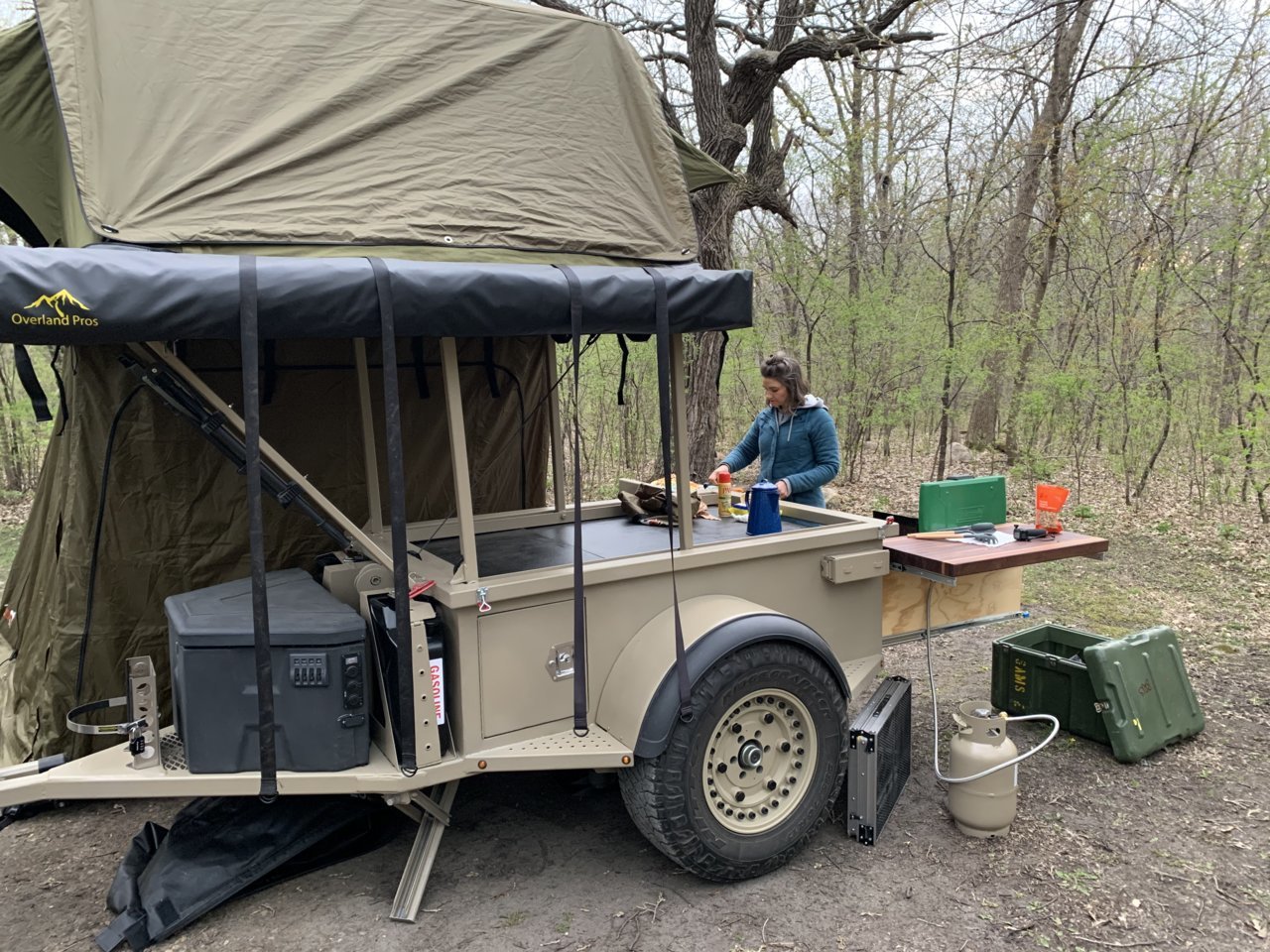

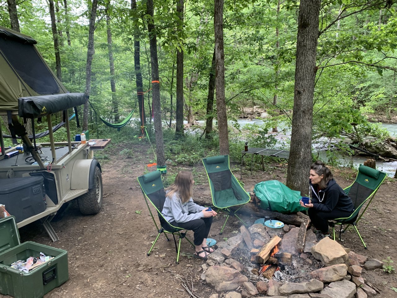

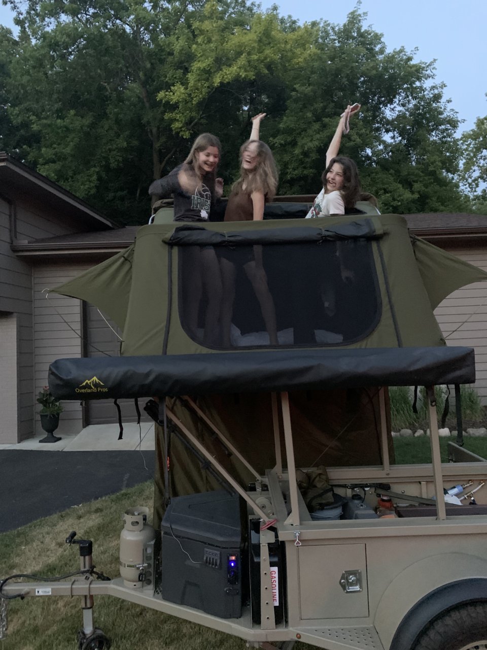

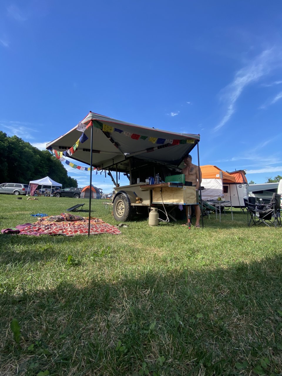

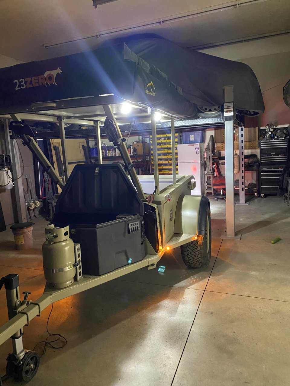

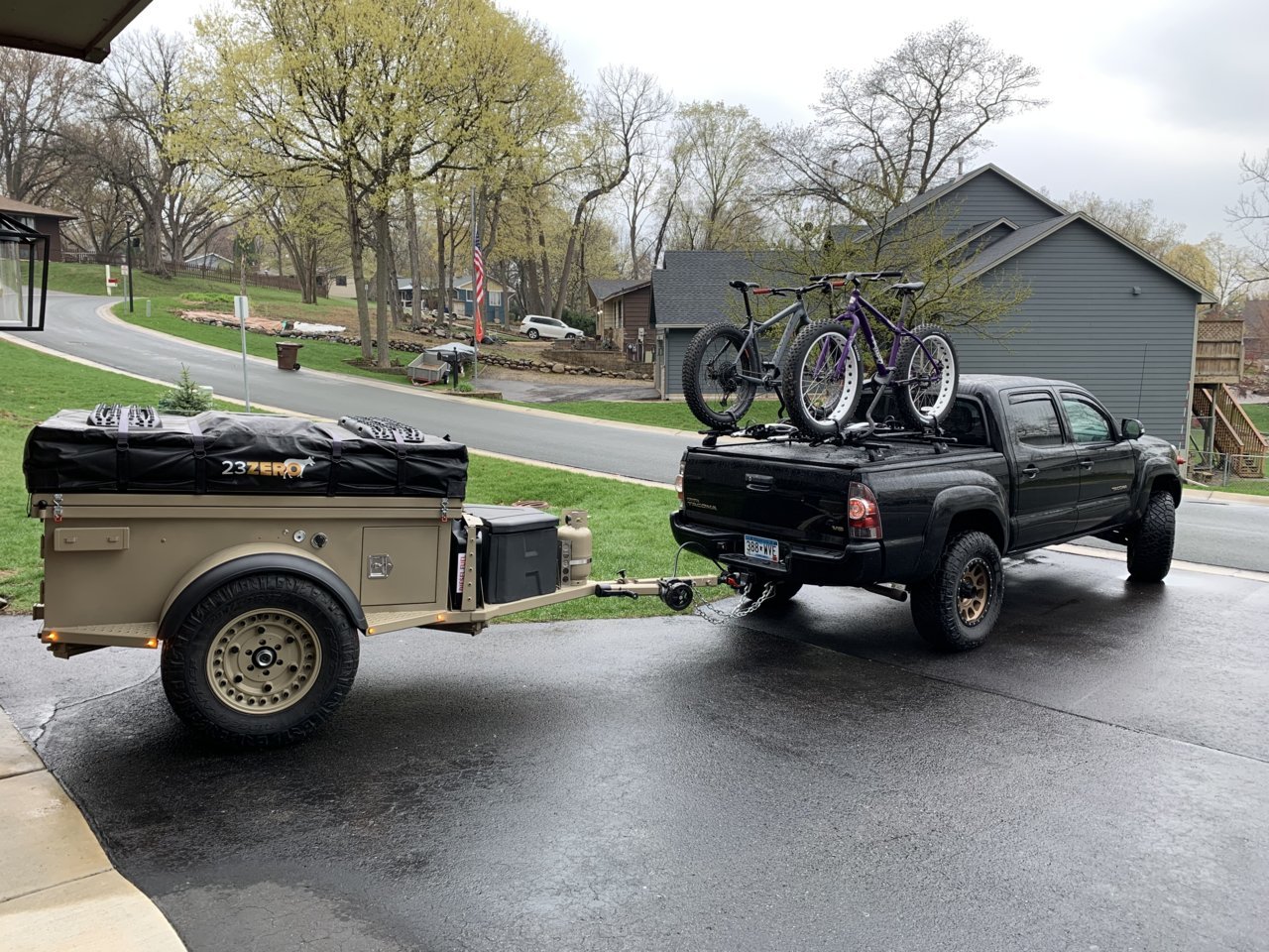

    361432E1-C0A6-4F2C-9E7C-0AD35DD420F3.jpg D8D5CA78-BF5F-4B57-8B6F-6365CC832B95.jpg D4F1AFA3-1C31-43C6-9A82-55E3C944726F.jpg CC1E99D7-4150-4B0E-9F37-4E284CDFC44F.jpg 4D05BADB-7B58-473A-ADC7-CD54607F7605.jpg 60F26CFE-5CD1-4E3D-8B65-02F9DB17FEE7.jpg ECA58E50-2CFD-4582-B285-3B7EEC296851.jpg 3FC97B86-D2FE-4D3F-9D5B-3D13D12115C9.jpg 380C3636-FF3C-45BA-9FB7-A9B72AB224E3.jpg 4120E61C-77AF-40E0-8C15-A71521506D8D.jpg D324535D-4F0A-4625-9697-D9D8E01488D0.jpg 2720570A-3A30-41AD-9E80-690829CC763C.jpg 1DA6E22D-787E-402A-8BF8-C34E3ADC08D2.jpg 41CE007C-F8E1-4C75-8DC1-C71F60E4D9FB.jpg C549BFF8-504B-491F-83EE-2F27826CFF3E.jpg 388D676B-FACA-47AF-A69C-336ABA24E7FD.jpg C26B64A4-33B6-4423-896A-8F254D95DAF7.jpg A5D38C7F-BD9D-4A74-8A40-9B0DE0D686A6.jpg D9A23B88-2F13-4D6B-A422-B5A82594A805.jpg Been too busy using the trailer and enjoying every second of summer to post- here’s some highlights from our adventures so far- and we ain’t done yet!

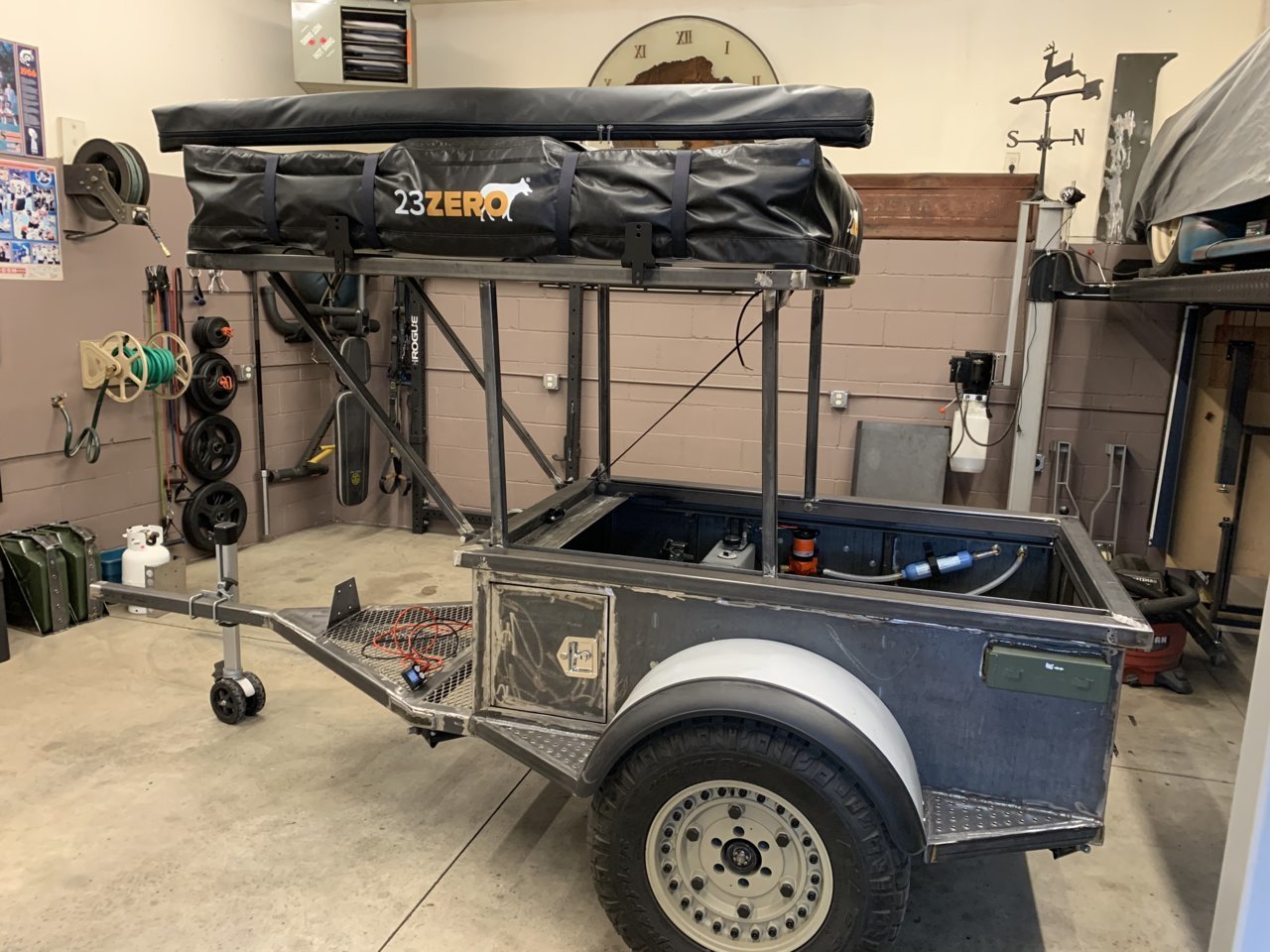

    Hows the stability of the trailer with the tent up and forward over the tongue like that with weight in it? Does the trailer get a little wobbly at all?
  20. Aug 19, 2021 at 7:50 AM
    #20
    HULK64
    HULK64 [OP] Member
    Sep 15, 2019
    #305332
    20
    Josh
    One night we didn't put the 4 landing legs down so it was just on the wheels and trailer jack- and then it was a little wobbly- but with the landing legs down its super solid! The only thing I gotta figure out is when momma and I go down to funky town- there's a squeak in one of the stand up legs that we gotta get to stop! :bananadance:
