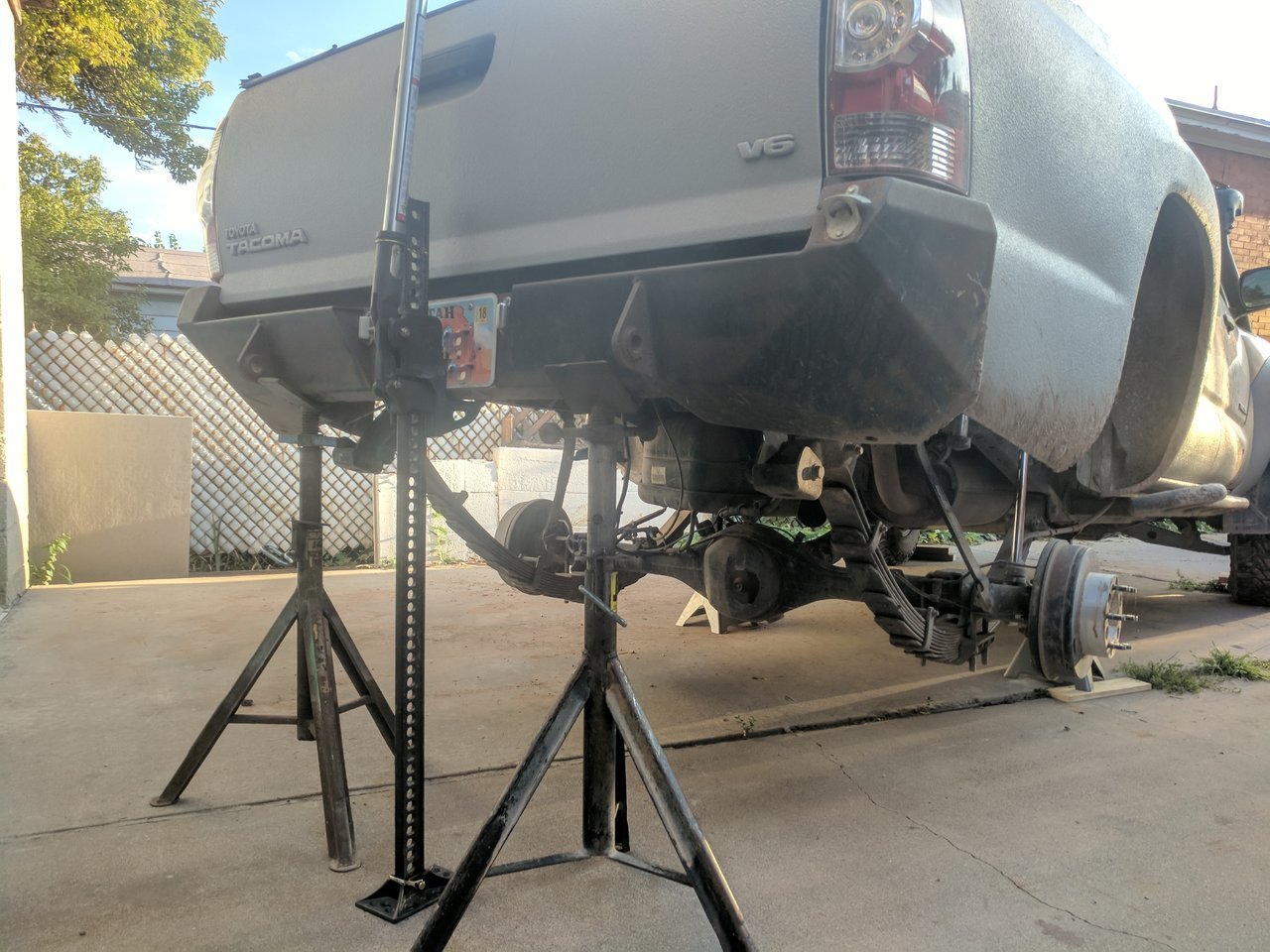

    Update 9/1/2017
    I decided to replace my bushings for the spring under kit and paint the frame from the cab back. It was a larger project than anticipated. I plan on painting the rear bumper at a later date.

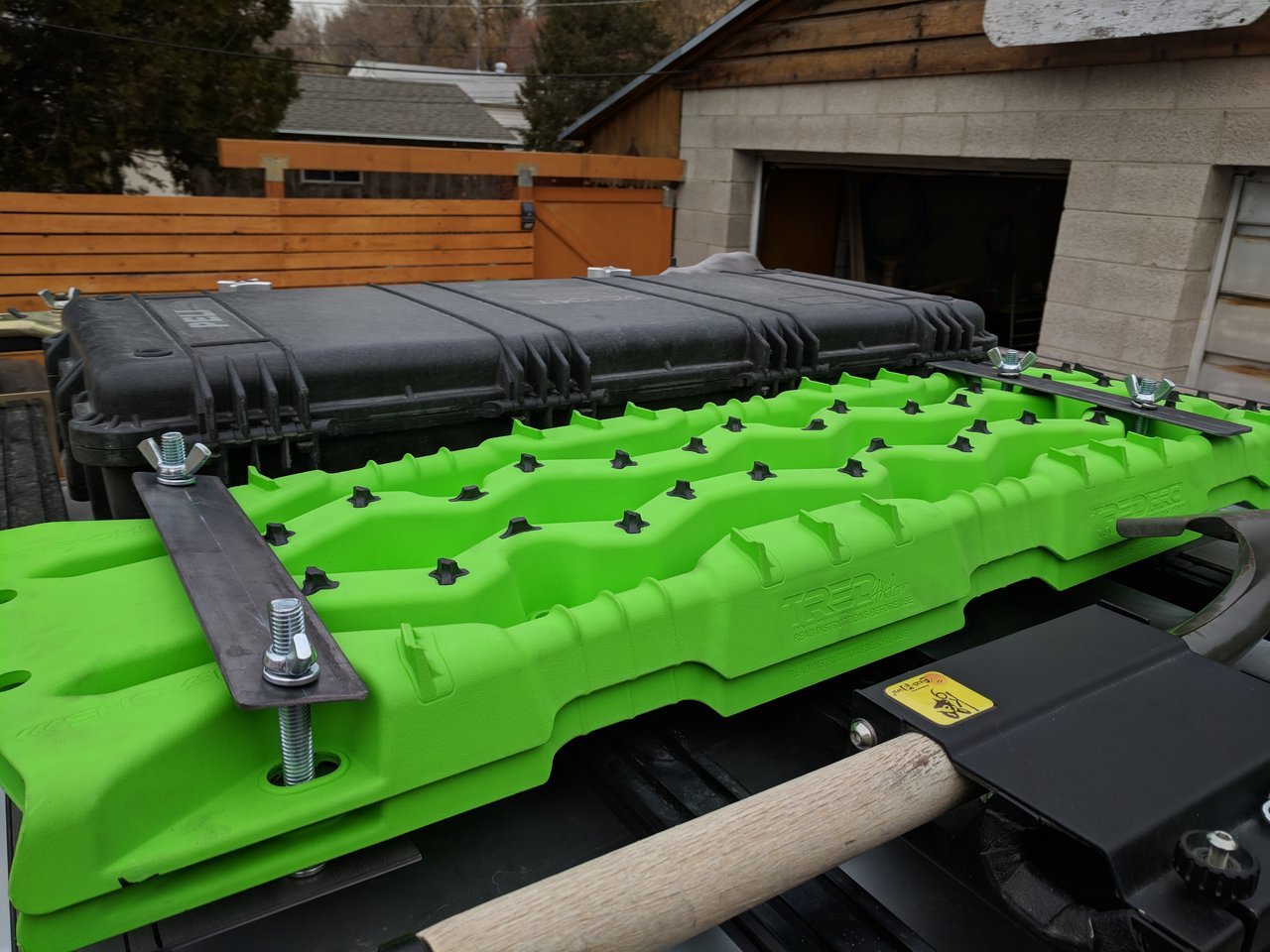

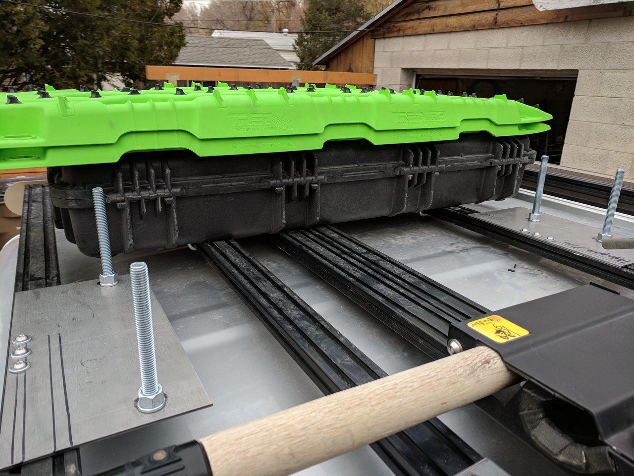

  20. Dec 12, 2017 at 10:53 AM
    #60
    concentric_killa
    concentric_killa [OP] Well-Known Member
    May 26, 2016
    #187951
    844
    2011 4x4 DBL Cab Taco
    +3.5 TC Long Travel DMZ Spring Under Nitro 4:56 Gears Custom Snorkel List Goes On..
    About a month ago, I finally bought some Traction Boards. I thought about maxtrax but I like the concept behind the Tred Pro's. I also could have used them when I got stuck in Idaho this summer. I made a quick mount so I can set them on the roof. The mount cost me all of $10. I might change some things, but so far it works.
