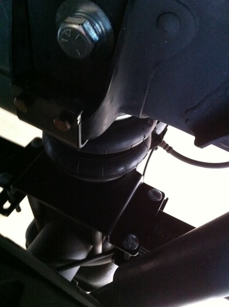

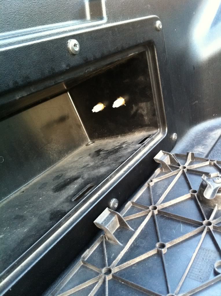

  14. Sep 14, 2011 at 5:17 PM
    Trent
    Trent [OP] Well-Known Member
    Aug 26, 2011
    #62409
    175
    Houma, LA
    2013 Lexus GX460
    The install wasn't too bad. The directions could have been a little clearer. Mounted the air valves in the storage compartment on the driver's side.
    Overall, the ride is about the same. So I cant complain. Didn't think to measure ride height before, but it does seem a little higher in the rear now even with about 10 psi in the bags.
